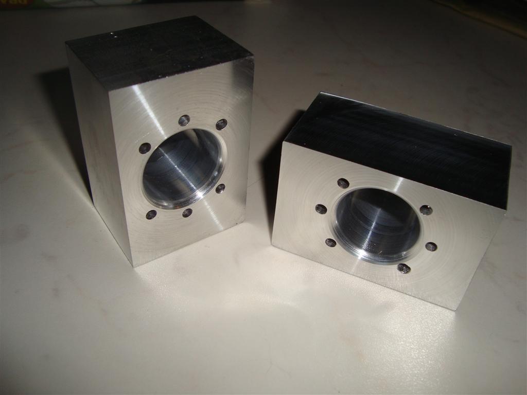

    Or I'll make you them from aluminium for less than that. Here's two I made earlier:
