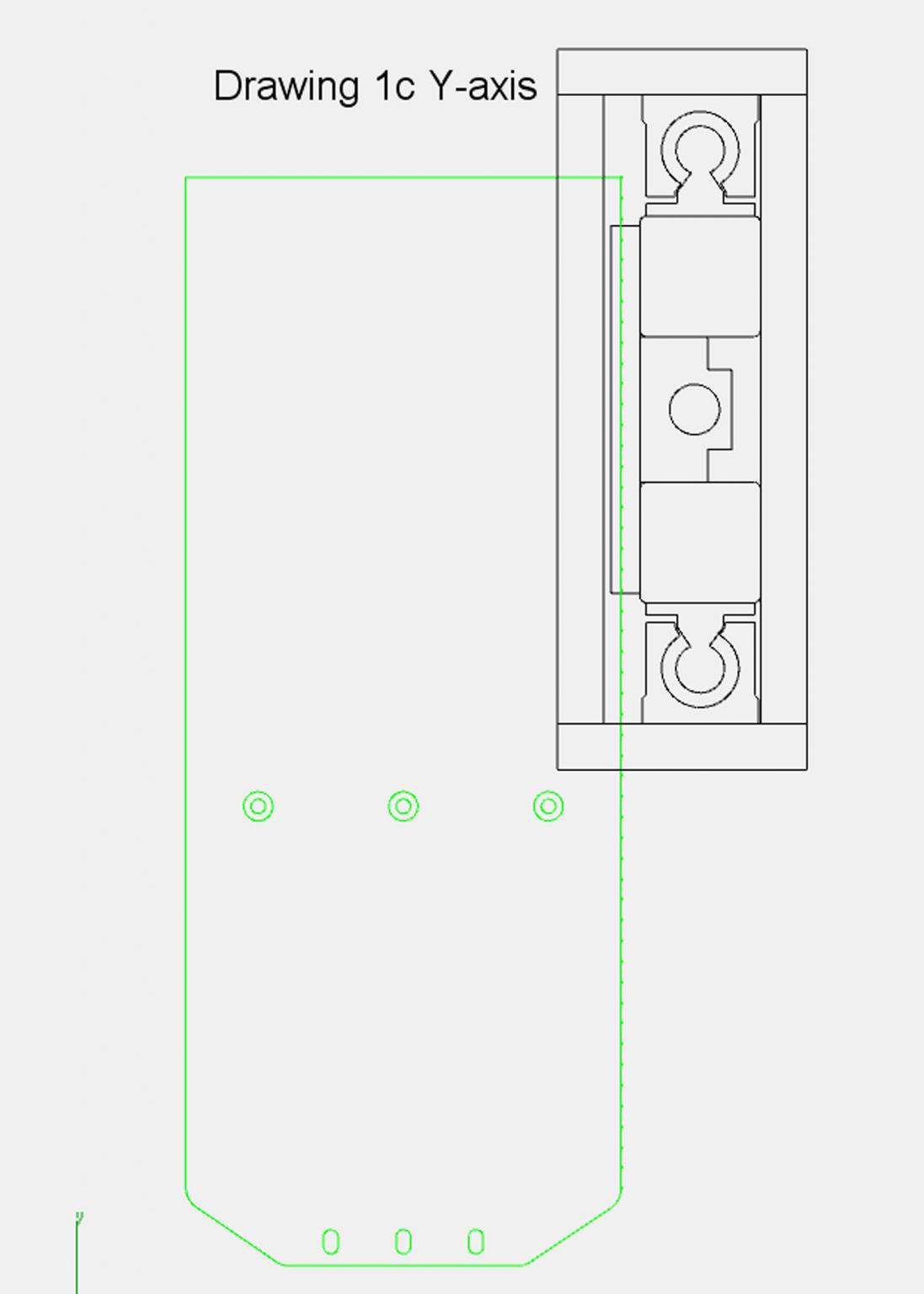

    I think I have cracked it what is your views on this drawing
    Extrusion 50x50 mm but the down side is they only do it in light

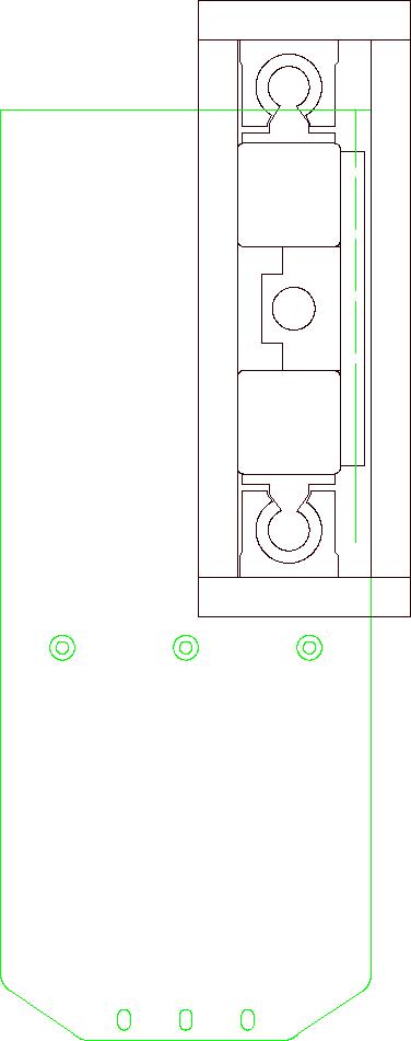

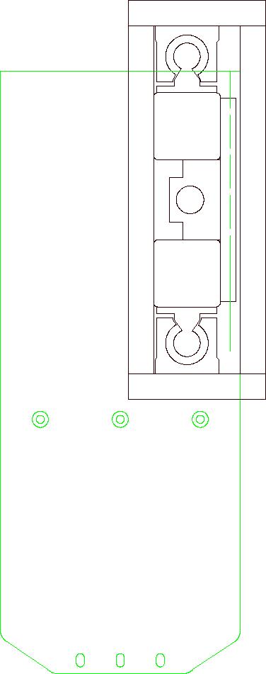

    I think your latest design, but mirrored so that the Z-axis is mounted on to the same plate as the ballnut will be strongest:
    That way the spindle is closest to the Y-axis ballnut which should reduce flex parallel to the Y axis.
  3. #113
    It should be the other way around I don't how how that happened ???
    Thank you Jonathan
    Oops just realized you mirrored it all ready
    James
