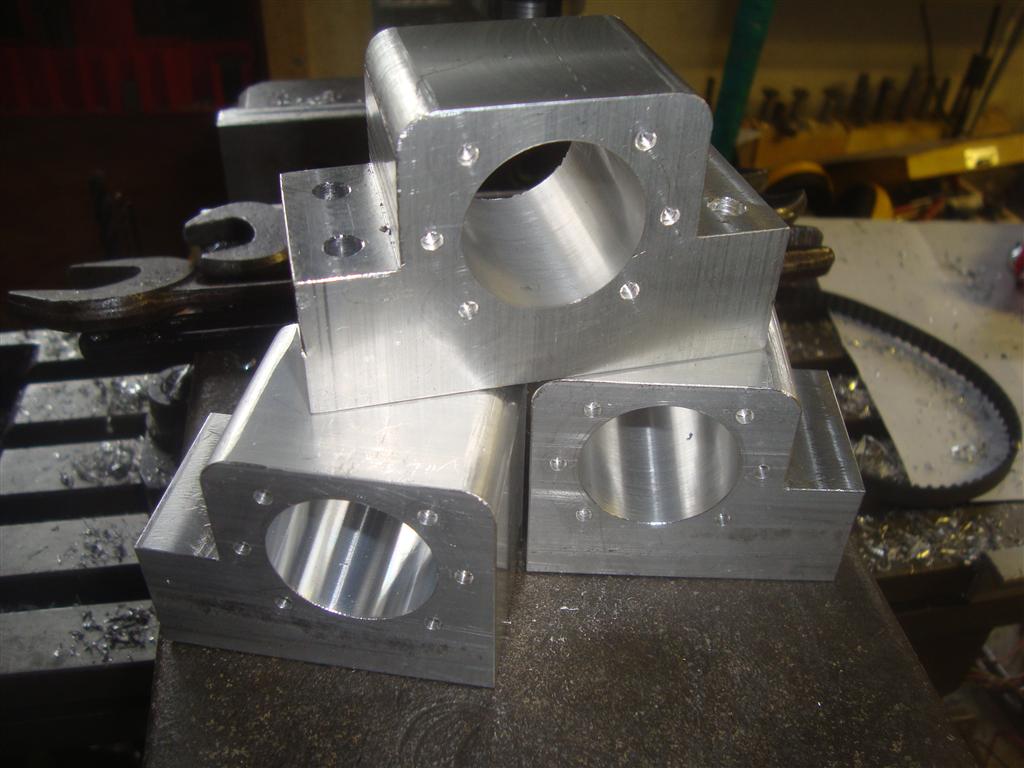

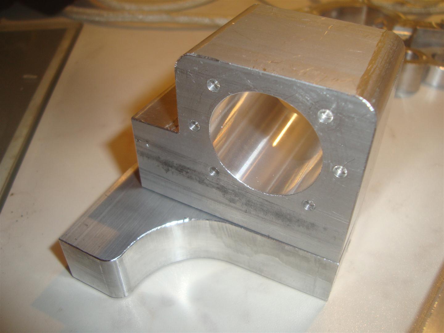

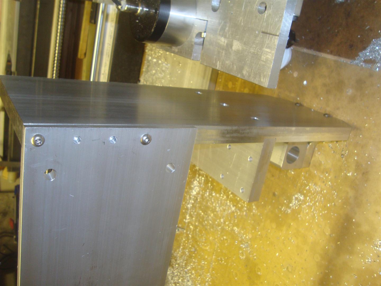

    More parts for you:
Name:	DSC08530 (Medium).JPG
Name:	DSC08577 (Large).JPG
Name:	DSC08576 (Large).JPG
Name:	DSC08531 (Medium).JPG

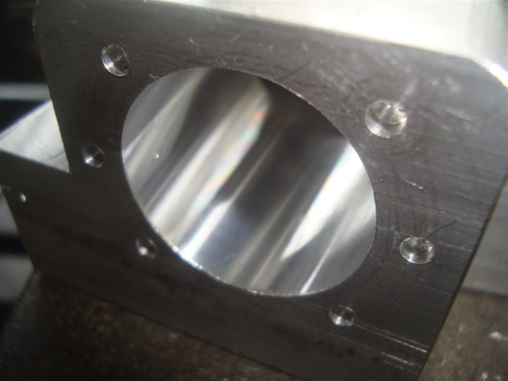

    The bore of that last ballnut mount came out very shiny. I used a polished carbide tip in the boring bar from APT:
    http://www.shop-apt.co.uk/carbide-in...m-uni-tip.html
    I didn't do anything special - it was just cut dry with the auto-feed. Would definitely recommend them for getting a good finish on aluminium...

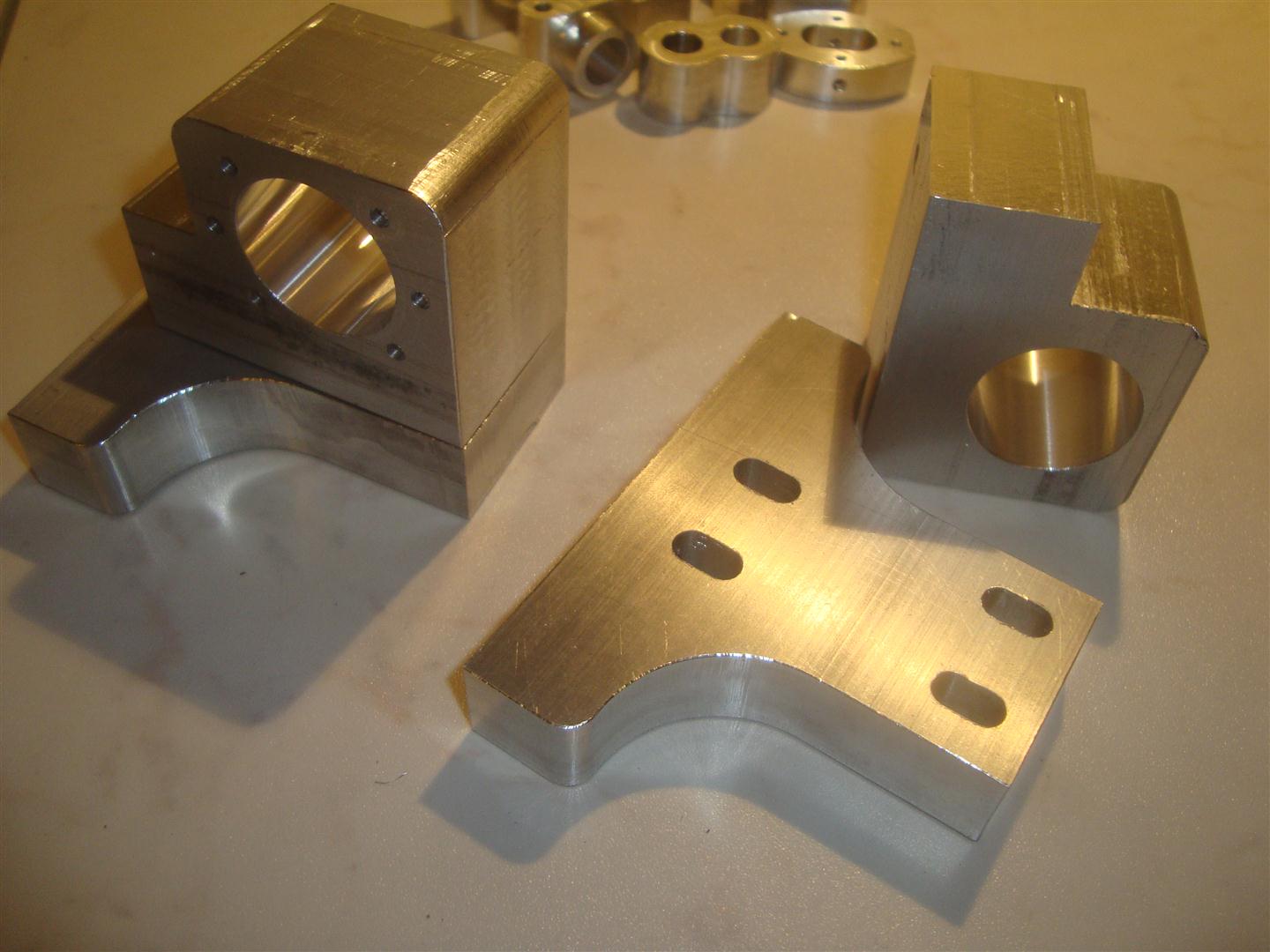

    Quote Originally Posted by luke11cnc View Post

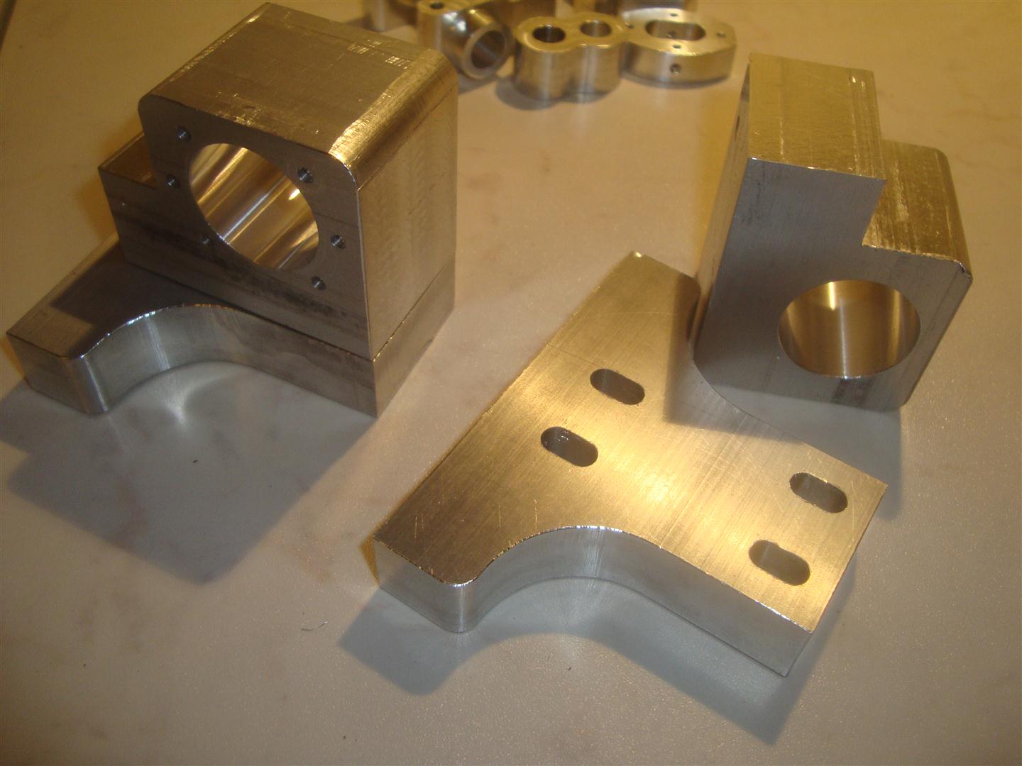

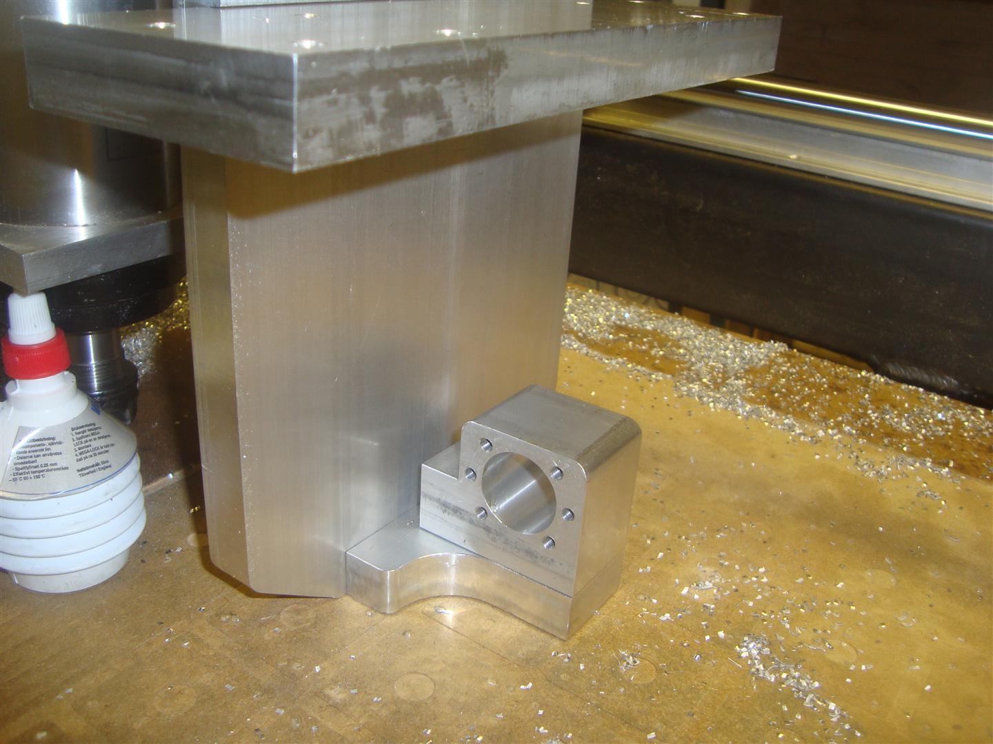

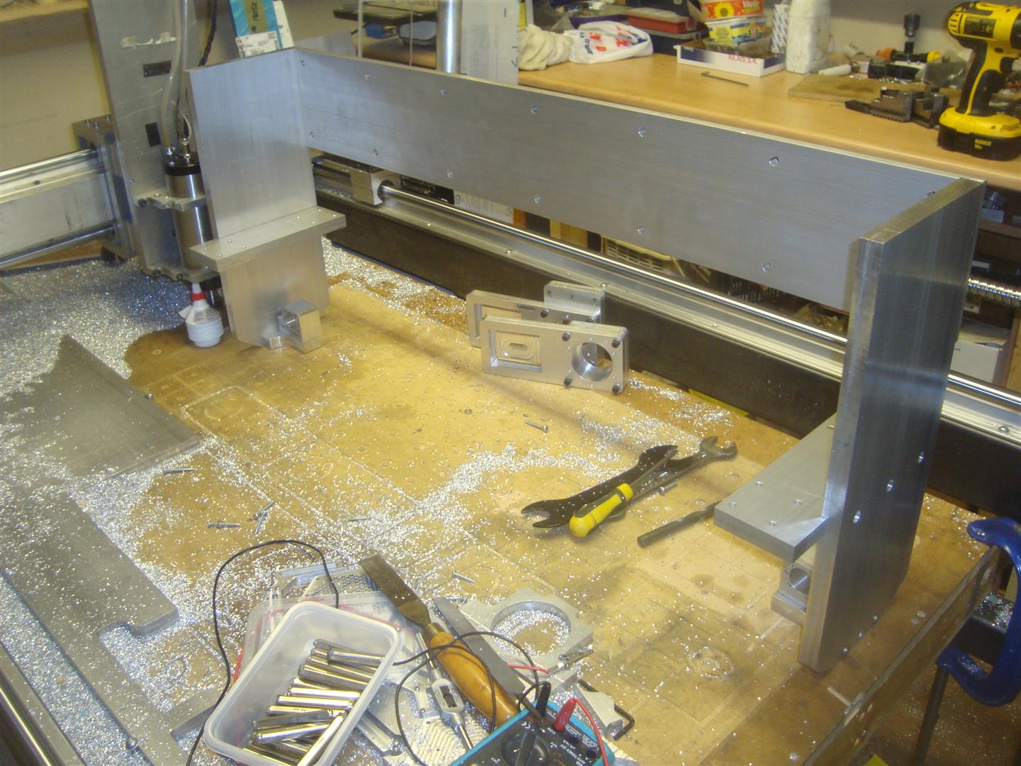

    I can't wait to see all the parts you've made for me and Luke
    Your waiting is over:
Name:	DSC08587 (Large).JPG
Name:	DSC08586 (Large).JPG
Name:	DSC08585 (Large).JPG

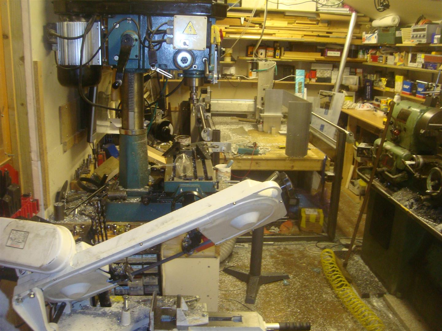

    My home, gradually filling up with swarf...
Name:	DSC08584 (Large).JPG
