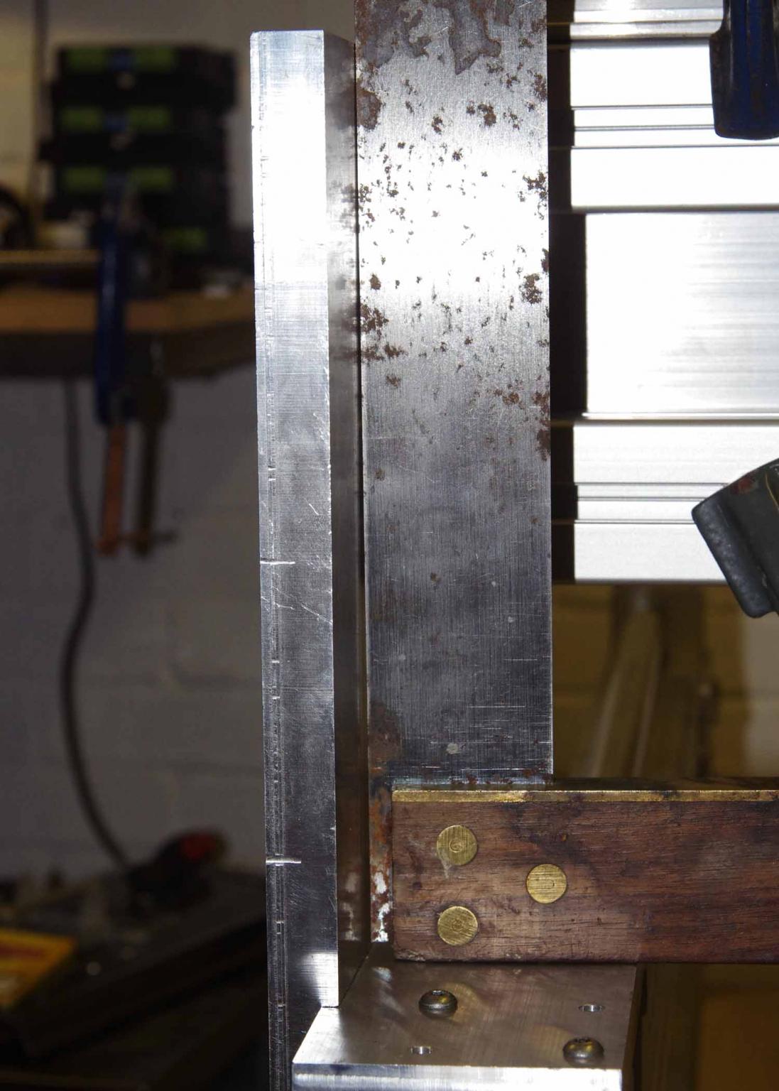

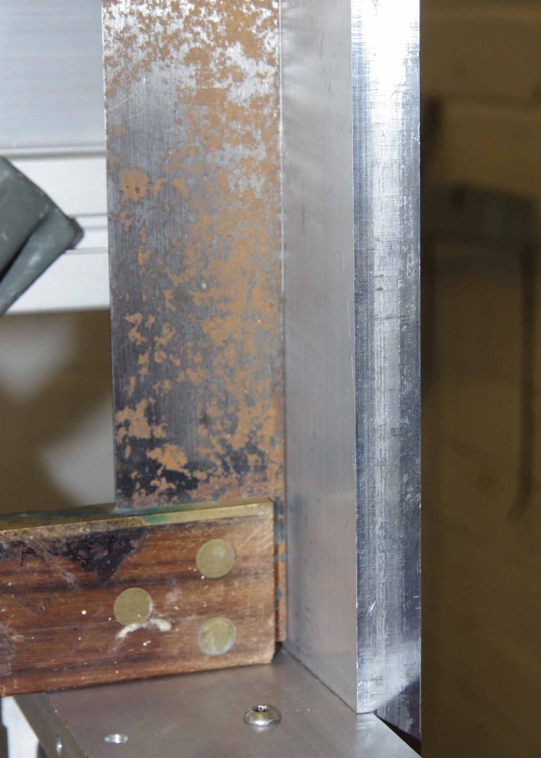

    I've been looking at my gantry all day and some think is not right and after about 3 hours I decided to get my set square out.
    and this is what I found
    The above image shows that the gantry is out of square by 1.5mm

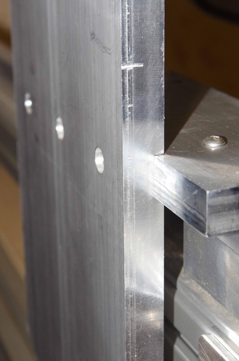

    the above image shows the gantry is out by .5mm
    am I being to picky does it really matter that much that the Gantry is not square
    Well I think so
    there is no stress to force the gantry out of square as all bolts have been taken out and the rails are not bolted down the only fixings is the three button bolts in the side of the gantry.
    Now I have tried to force the gantry square but it is solid and will not move.
    I am at a lost and getting frustrated
    what is my options Please Please advise what I need to do :question::question:
    James

    if you take one side off and measure the depth of the machined groove on each edge to see if the groove is machined level to the face. It may be a good idea to machine the edge of the plate the side is clamping too, to make sure the mating faces are square and flat.

    James: That not being quite square is one reason that I suggested you used triangular plates from the X-bearing mount to gantry side. They will stop the deflection.
    I cut the slots in the gantry sides on my router as they wouldn't fit on the mill. The bad had been surfaced recently, so they shouldn't be far off ... if you want me to skim the bearing mount plates to get them square that's not problem. I meant to do it anyway but forgot.
    Bear in mind SBR/TBR type bearings will tolerate some rotational misalignment, so will it make a difference when the machine is running? I don't think so, but I'd still add reinforcement triangles to make sure.

    I agree with i2i on this one. It might not be the side plates but the cross axis beam. It might not be perfectly square cut or it might be slightly short. If you have bolted up one side and its a bit short it would give this result when fitting up the other side.
    Ian

    James first I would double check the square is accurate.? Those type of wood working squares are not the best for accurecy.! Ideally you want a good engineers square, longer the better.
    The gantry is not neccesorally out of square, check the angle between the cross brace and gantry sides.! . . . Are they 90deg.?
    Like as been suggested the cross brace could be short or the rebates in the gantry sides could have been cut fractionly deeper than intended creating the same affect.
    If the difference is only small then you could easily place a shim/s in the rebate effectively widening the gantry back to original width and/or use them to bring back into square if rebate is uneven depth or wedged shape.?
    Because your using round rail you can accomodate this slight angle difference were the bearing plate meets the gantry side. (Easily fixed with with triangle braces like Jonathan suggests)
    Thou it's actually not a big problem if the gantry sides are not exactly 90deg to the cross brace because your using round rail. (If was using profiled rails then yes it would be a big deal.)
    Yes ideally you would like absolute square and true but So long as the error is not so great that it affects the screws then you'll be ok
    Far far more important is the gantry runs square to the X axis.
    I say get your self a good accurate square and some shim steel, It's not un-common to have to use shims to bring things into line or back to square so dont consider it a bodge.!
    Far better to hold something square with shims than force it square.!!!

    James: You can check how accurate the square is by placing 4 equal diameter cylinders in it arranged in a square and measure the diagonals (i.e. placing the caliper across the tangents). If they are equal you know it's good. That's fine in theory... the problem is finding 4 accurate cylinders, bigger the better-I don't advise using your router's rails!
