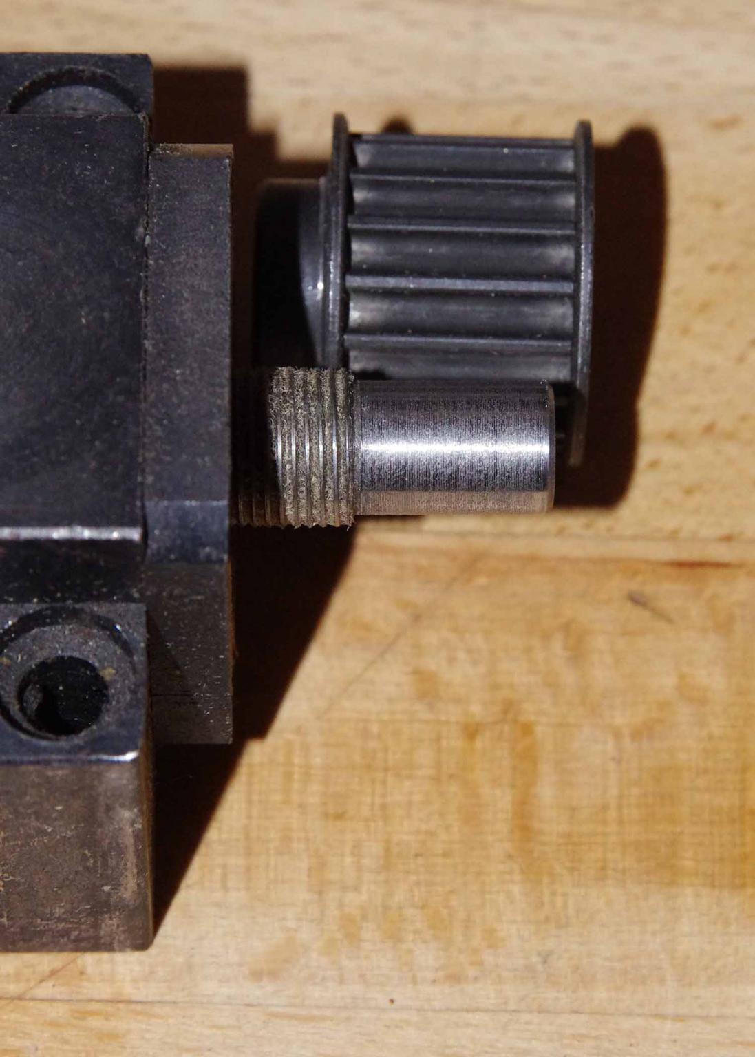

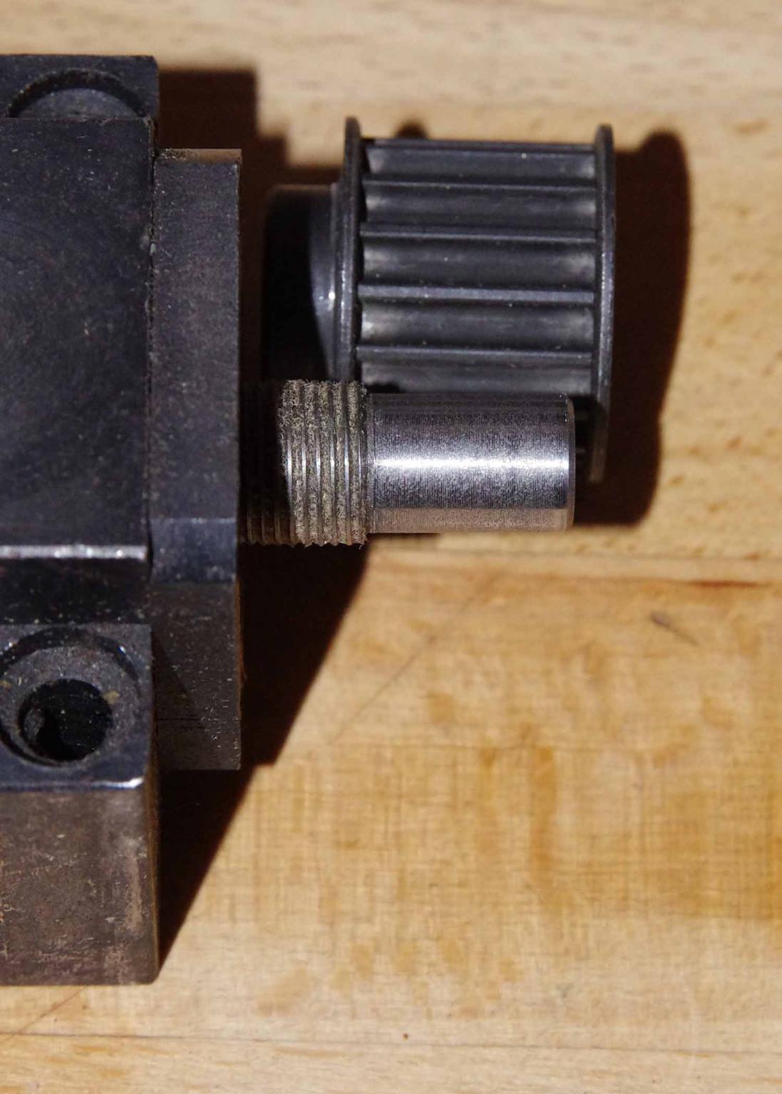

    Your almost right Jonathan? The screw is very hard and can easily crack (only the centre is soft). If this is added to the floating end then no need to knurl it, just go for a nice tight slide fit and let the loctite do it's job.
    The reason I knurled it is because that's what John S does. Well, says he does at least. Could anneal the very end of the screw to stop the risk of cracking, but that's probably taking it too far.
    Putting the extension on the 'floating' end sounds good to me as all it's doing is stopping the screw whipping, not transmitting torque. The other end is probably easier though as the tolerances to fit the pulley are not tight as for a bearing. It depends how much we need to add?
  2. #182
    Jonathan the problem wih extending the belt end is as you have pointed out to is torque on the jointed section. As WG said that end can always be machined to allow for the pulley. An even easier solution is to just extend out the floating bearing housing with some ali round bar and mount the bearing in the end?
    At the end of the day the KISS approach is always best, less to go wrong
  3. #183
    I haven't got a clue what your all taking about but I think I've solved the problem.
    If I take the retaining nut off and have the pulley machined to slide over the threaded part and have 2mm machined of the pulley shoulder and fit a grub screw plus slide the other bearing right to the end and cut off the excess ballscrew material It will fit
    what do you think is this a solution or am I making more problems for my self
    James

  4. #184
    No one with any advice on my solution ??
    James
  5. #185
    i2i's Avatar
    I take it you're going to replace the bearing clamp nut with a thread in the pulley. If so you'll need a more positive location for the pulley, one grub screw just won't be enough. Possibly a pin right through the pulley and shaft when it's clamped up tight.
  6. The Following User Says Thank You to i2i For This Useful Post:
  7. #186
    Well after a lot of soul searching I've decided to take it down to my local engineering shop and have it rematched if it doesn't work I will have to buy a new one but I'm not going to cut corners to make it work now
    and if it works they can do the other one (z-axis) as that is the same
    James

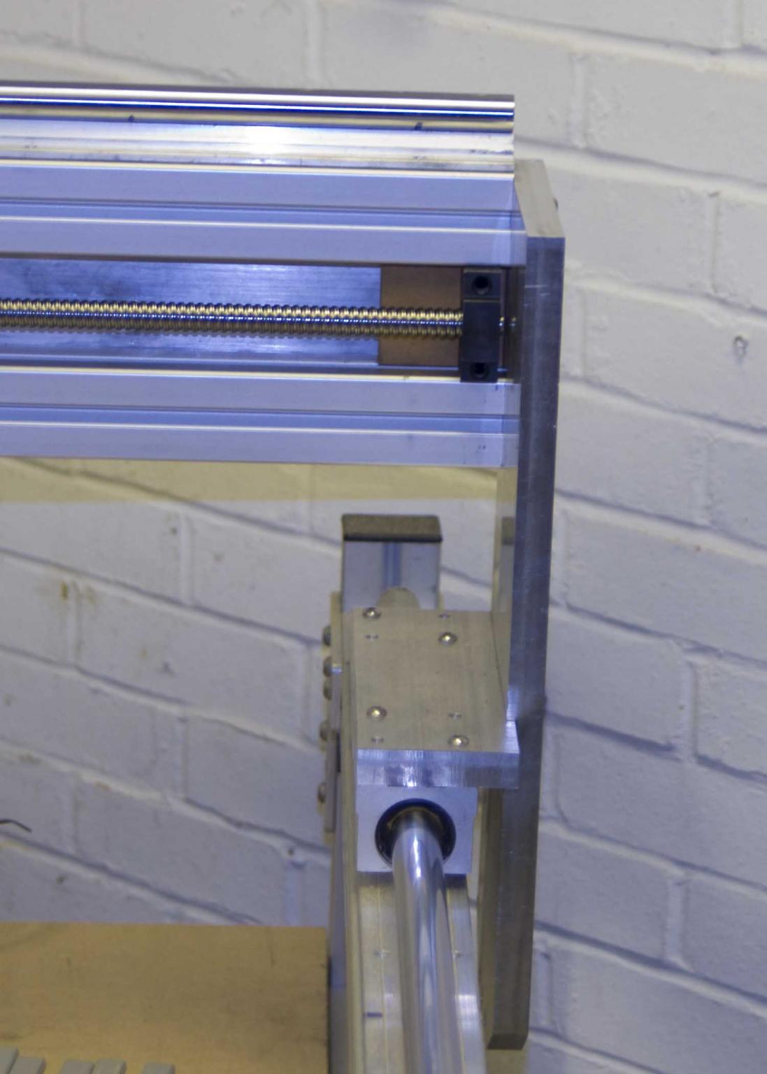

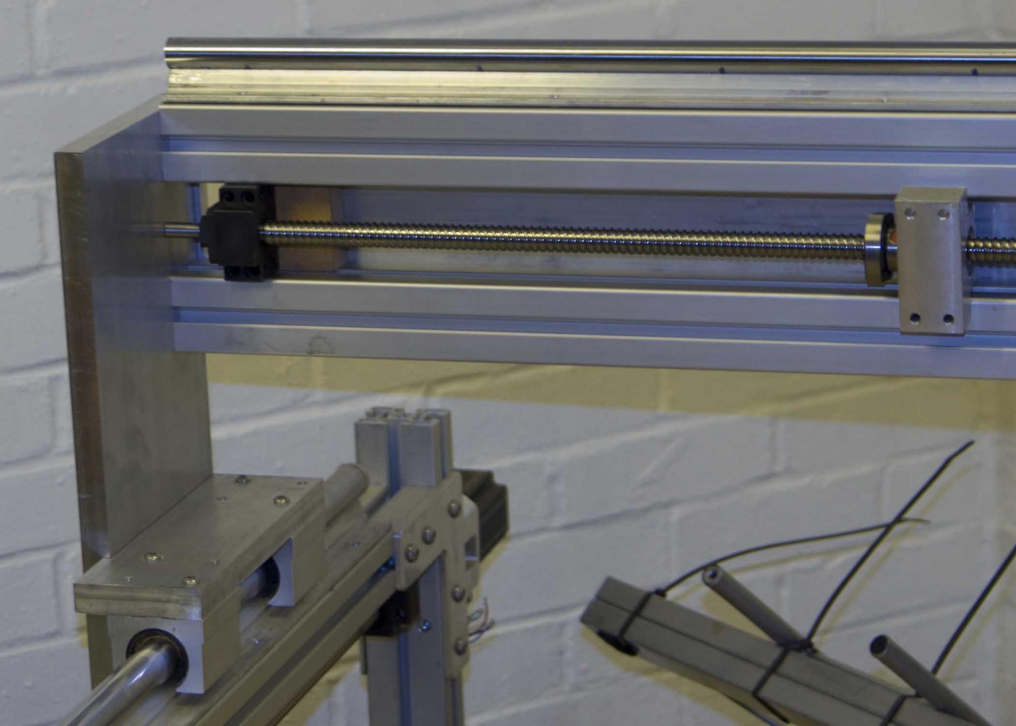

    well we did do some work on the CNC Machine at the week end and have now mounted the gantry support extrusion to rear beam and gantry sides
    poor poor Luke "Dad how many more time do we have to take it apart just to build it back up again"

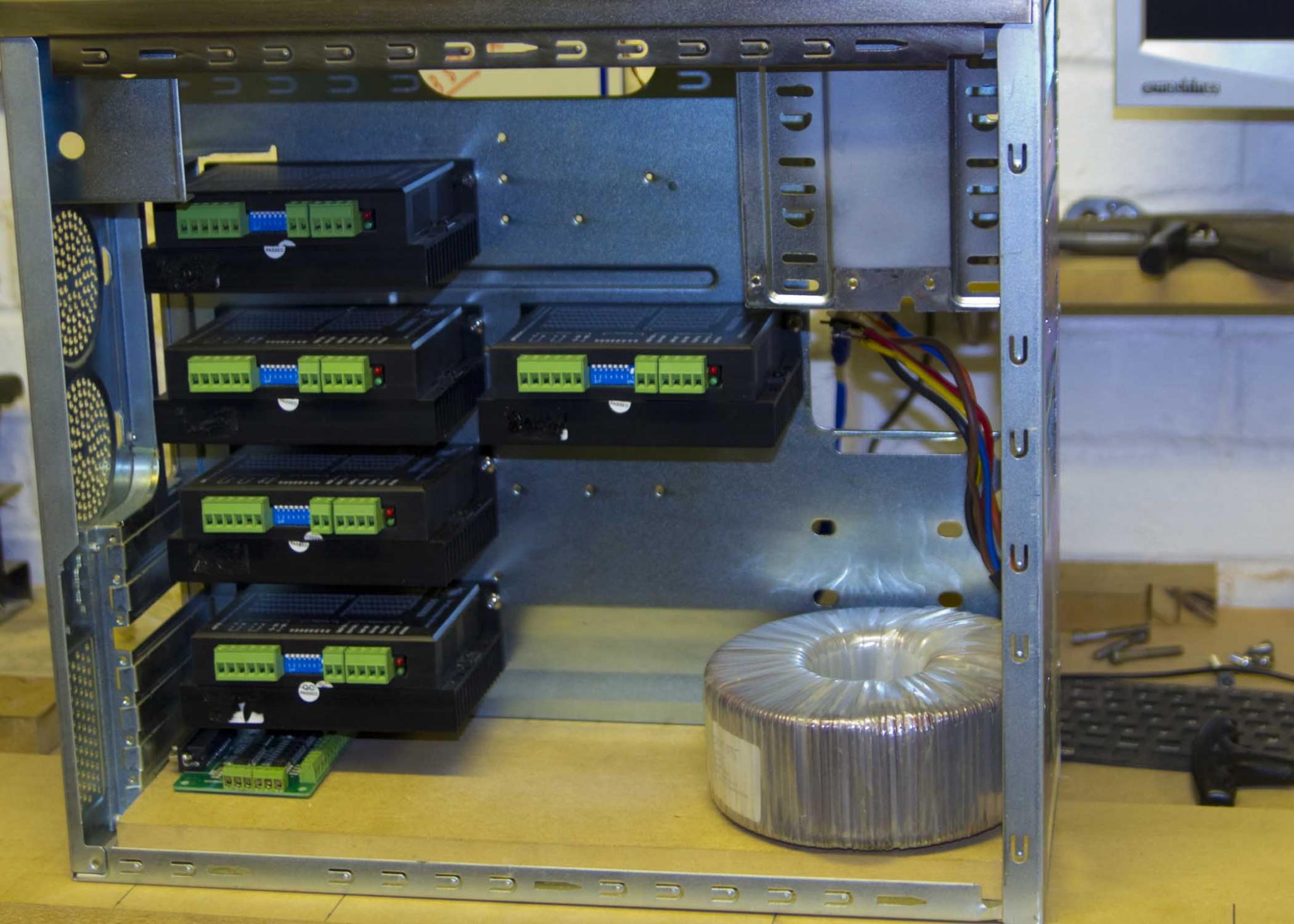

    at the week end we also started the mounting of drivers in the old computer

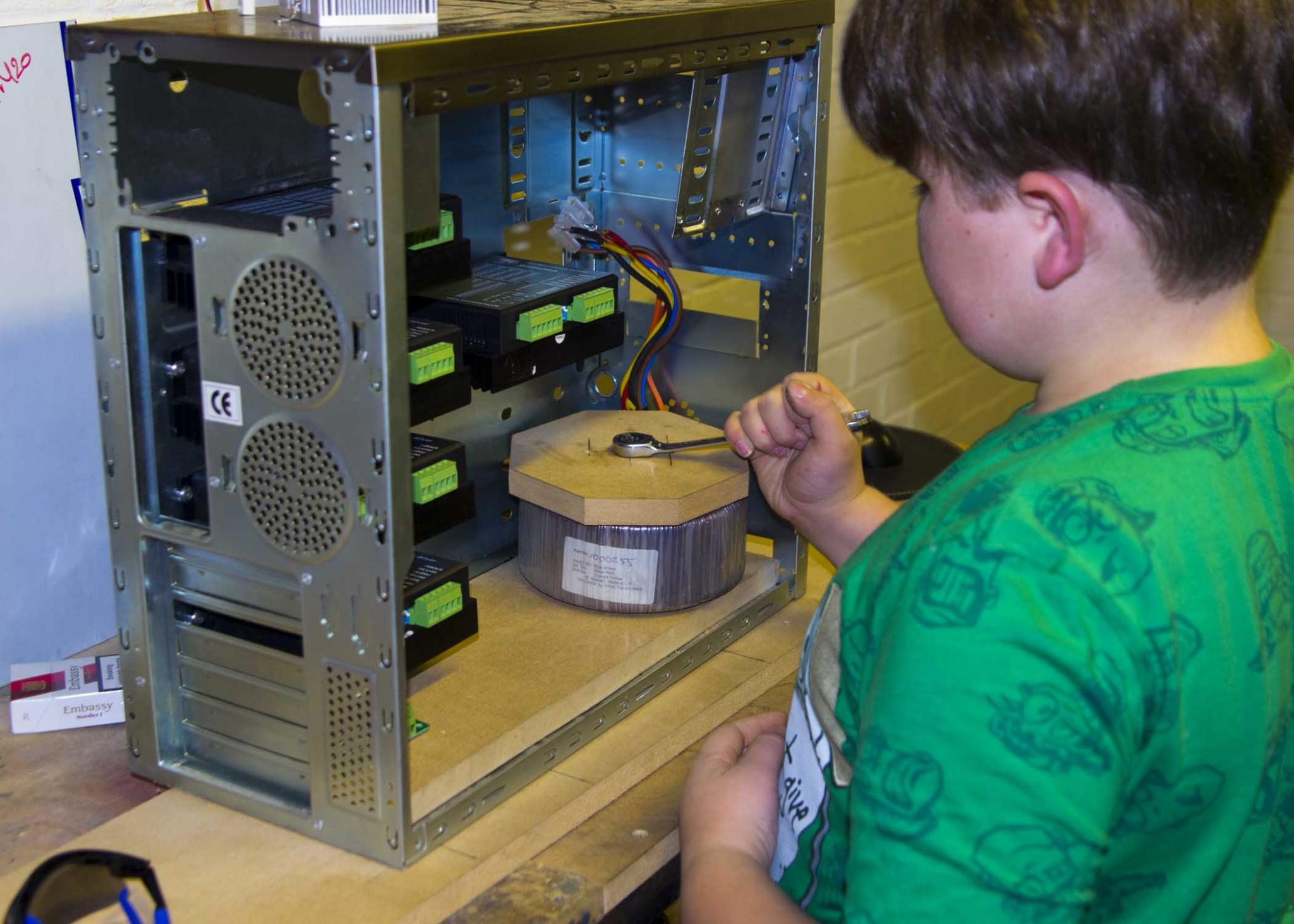

    Now I must admit I did most of this and Luke just did the last one and as you can see he finished mounting the transformer

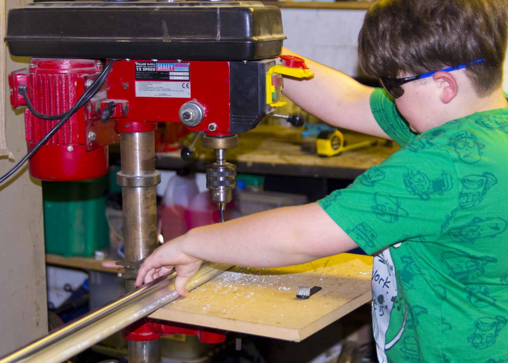

    In this image Luke is drilling out the y-axis supported rails as they came blank
