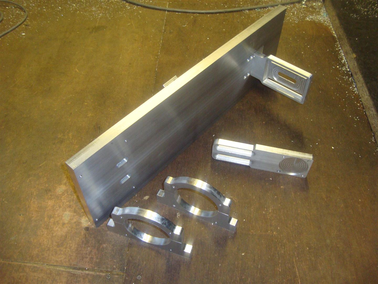

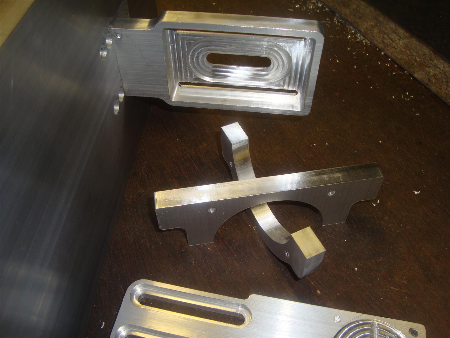

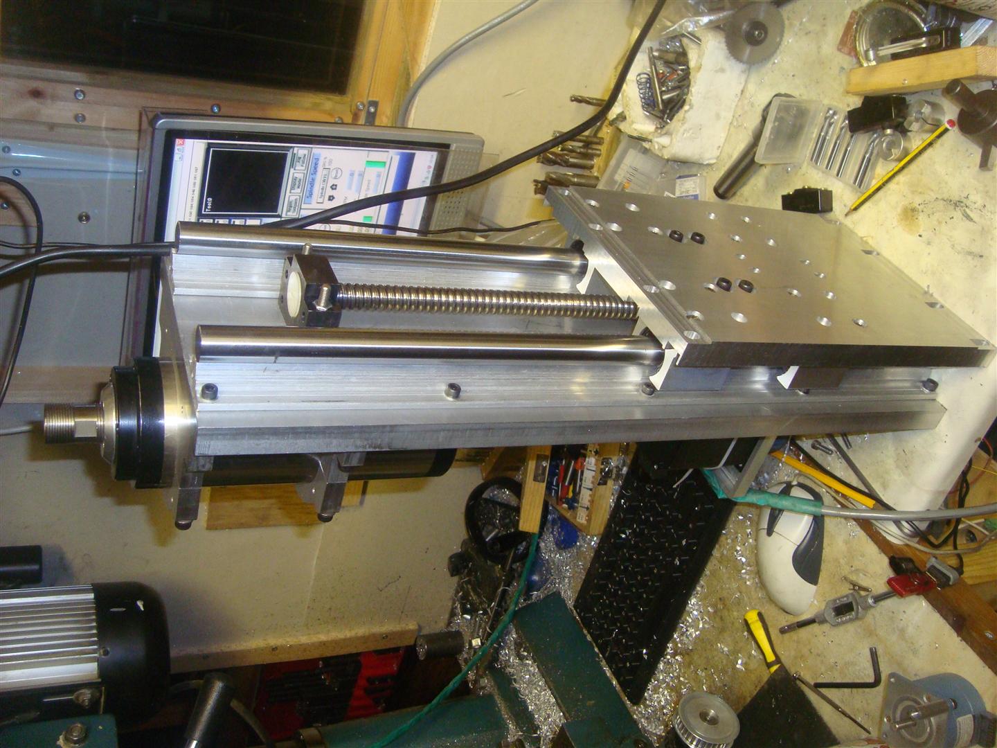

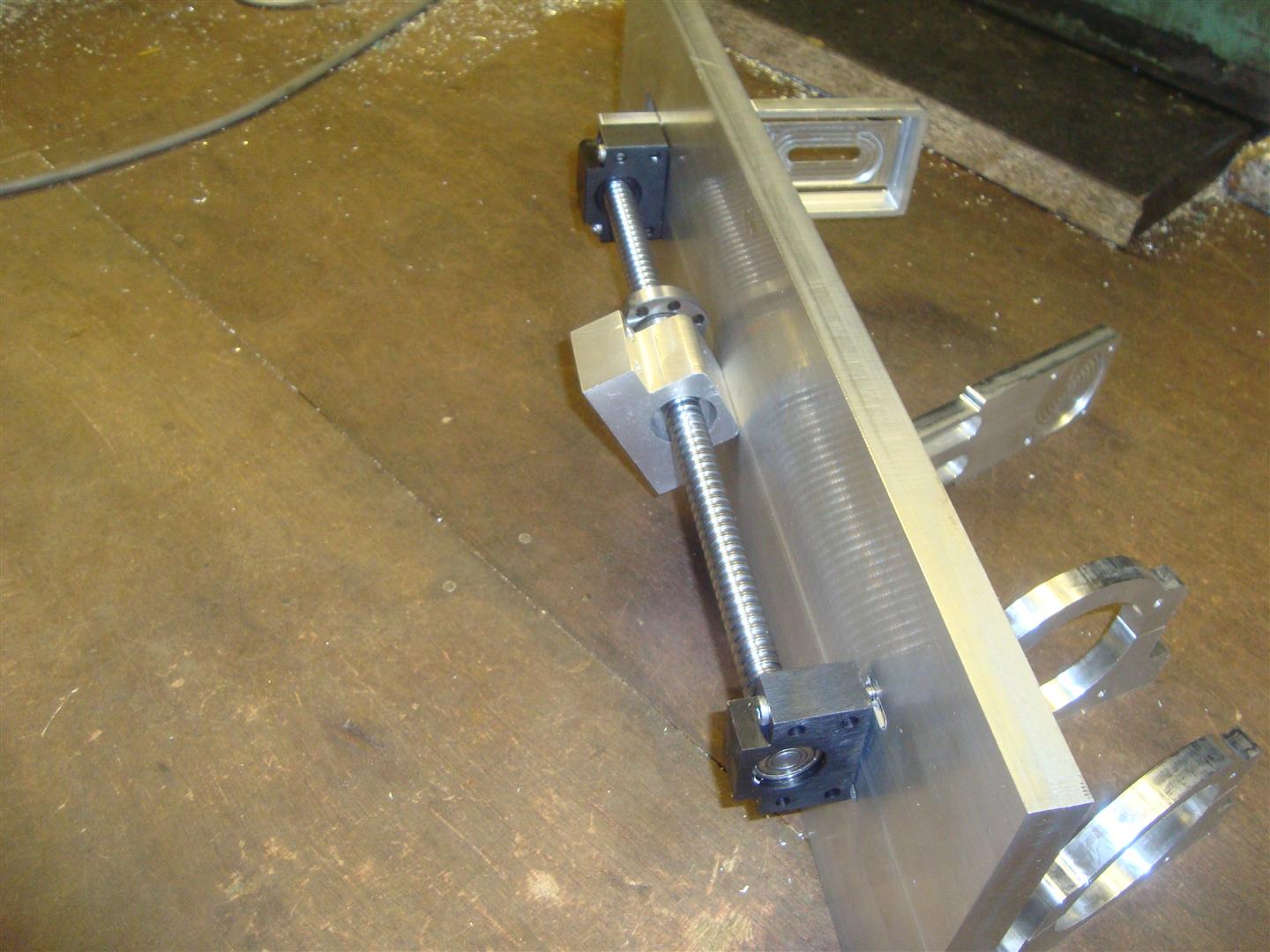

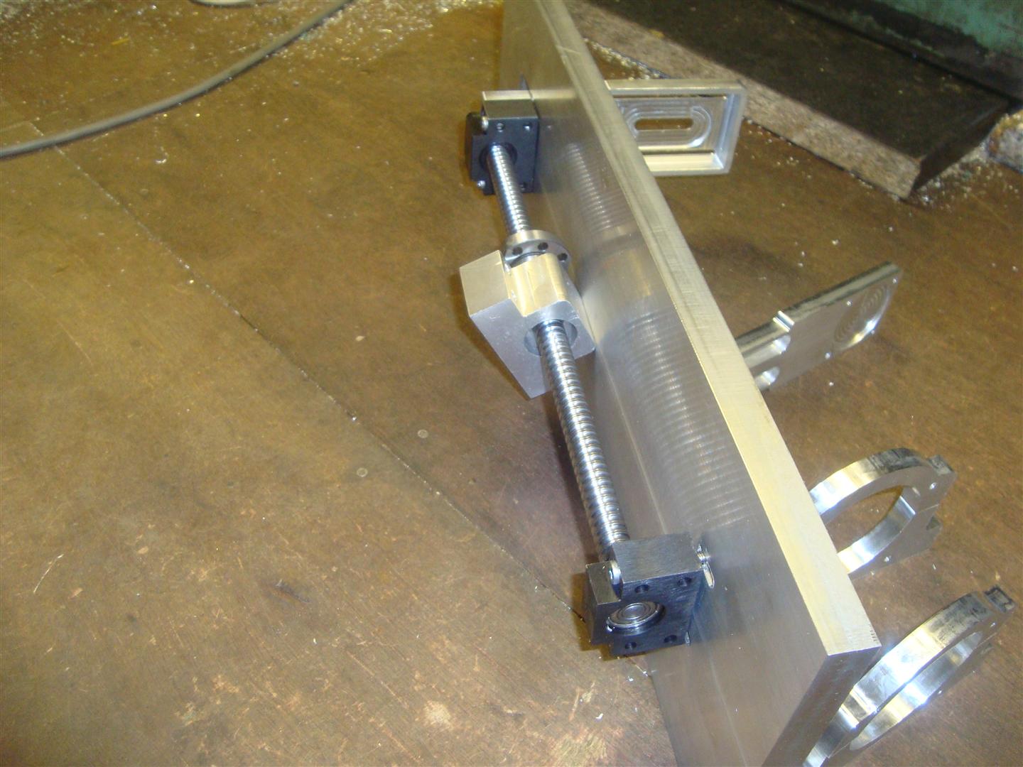

    Z-axis is in progress, plus Y-axis stepper motor mount:
Name:	DSC09110 (Large).JPG
Name:	DSC09107 (Large).JPG
Name:	DSC09108 (Large).JPG
    I reground the cutter (6mm single flute) freehand after the Z-plate as it was chipped. Better finish than ever! :surprised:
Name:	DSC09109 (Large).JPG
    All the bits made, mainly drilling and tapping to do now then check it all fits properly.
    So close now
    Something worth noting for the future is that the aluminium flat bar is nowhere near flat, so in future I will stick with getting aluminium plate like I used for my machine.
    The BK support is partially dismantled in the photo as it's not going to work without modification. Glad I never considered using them on my machine, too much trouble compared to just making the whole thing.

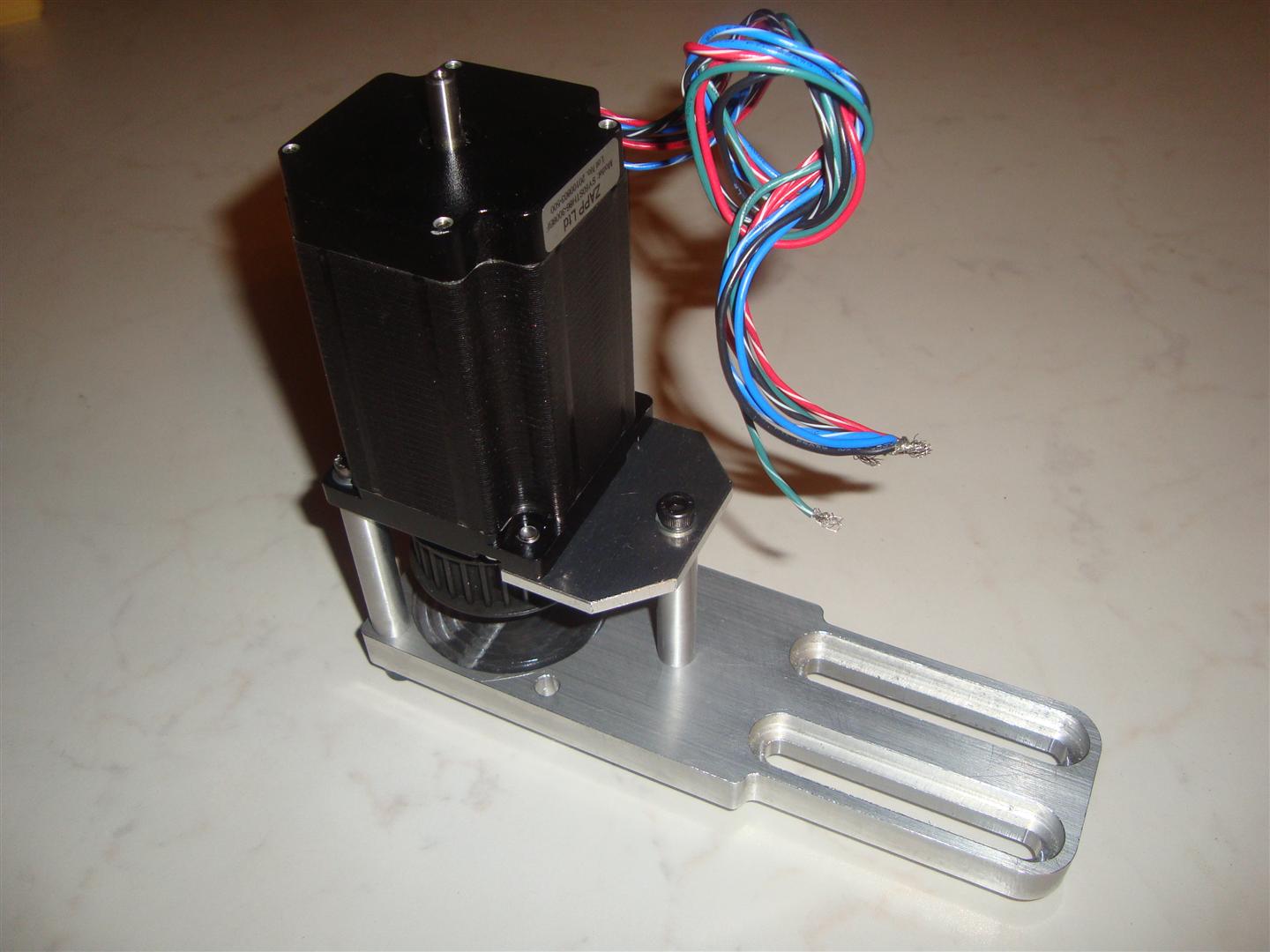

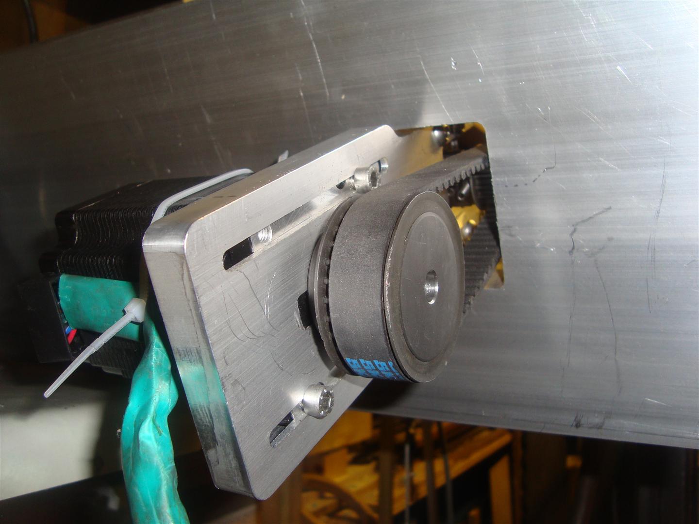

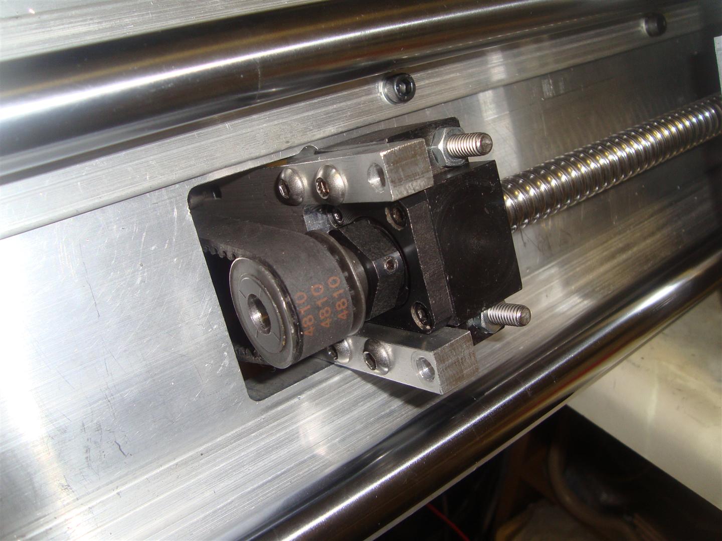

    Few more bolts / holes and it's done:
    Y-motor mount:
Name:	DSC09164 (Large).JPG

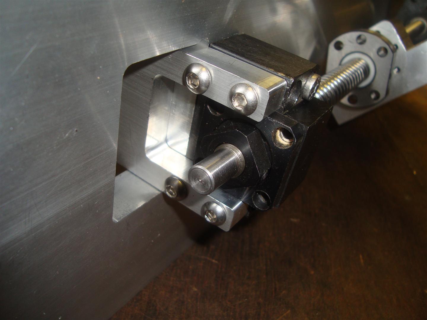

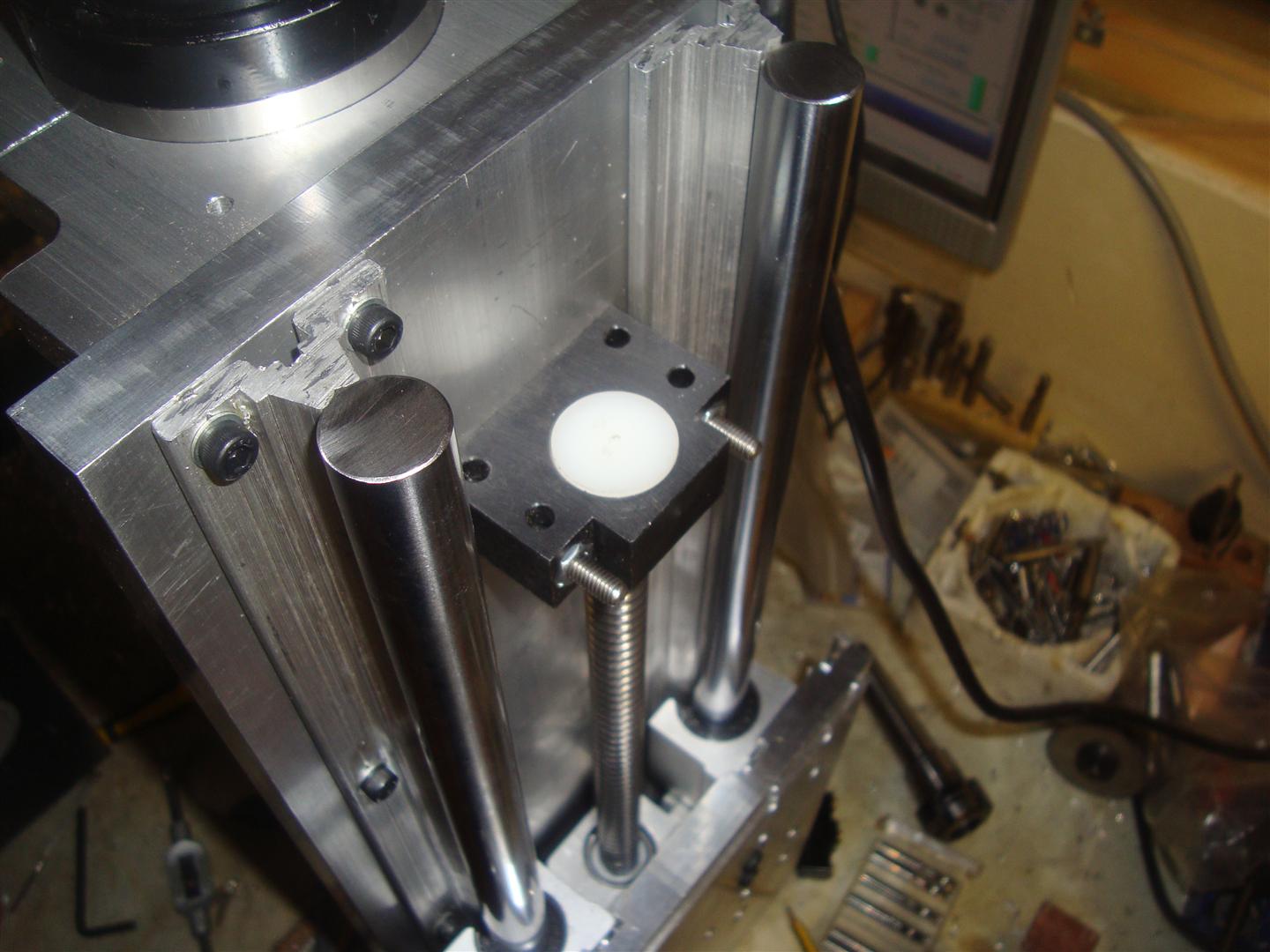

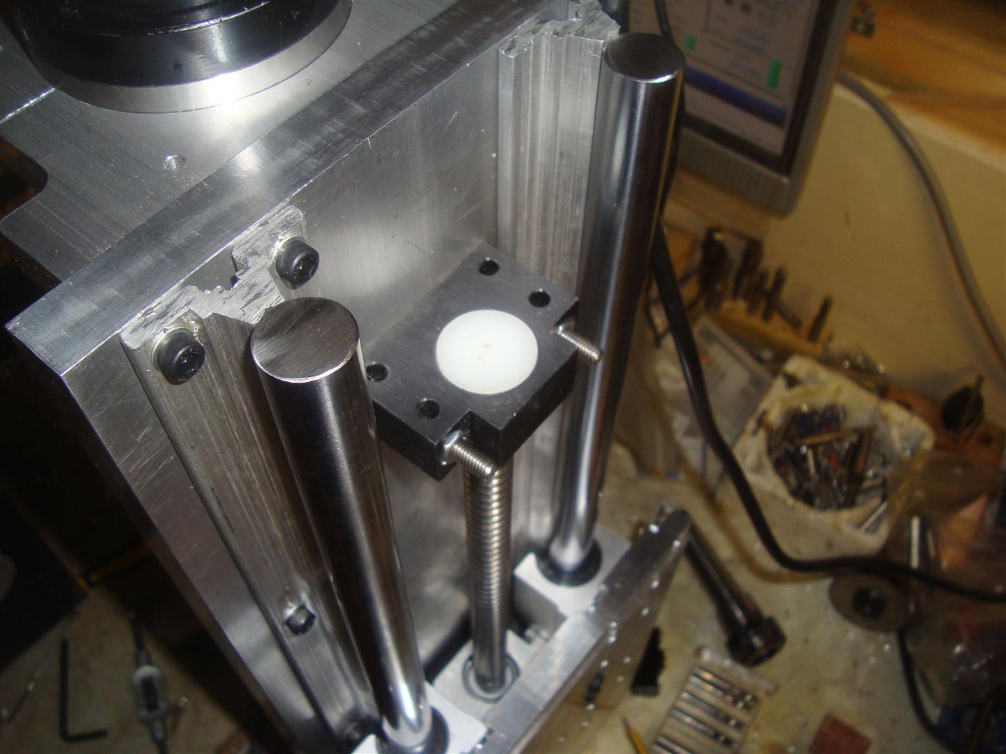

    Z ballscrew fixed end, slightly unusual motor mount. Had to make longer spacer for the bearing support as the existing one wasn't long enough and caused far too much friction.
Name:	DSC09174 (Large).JPG

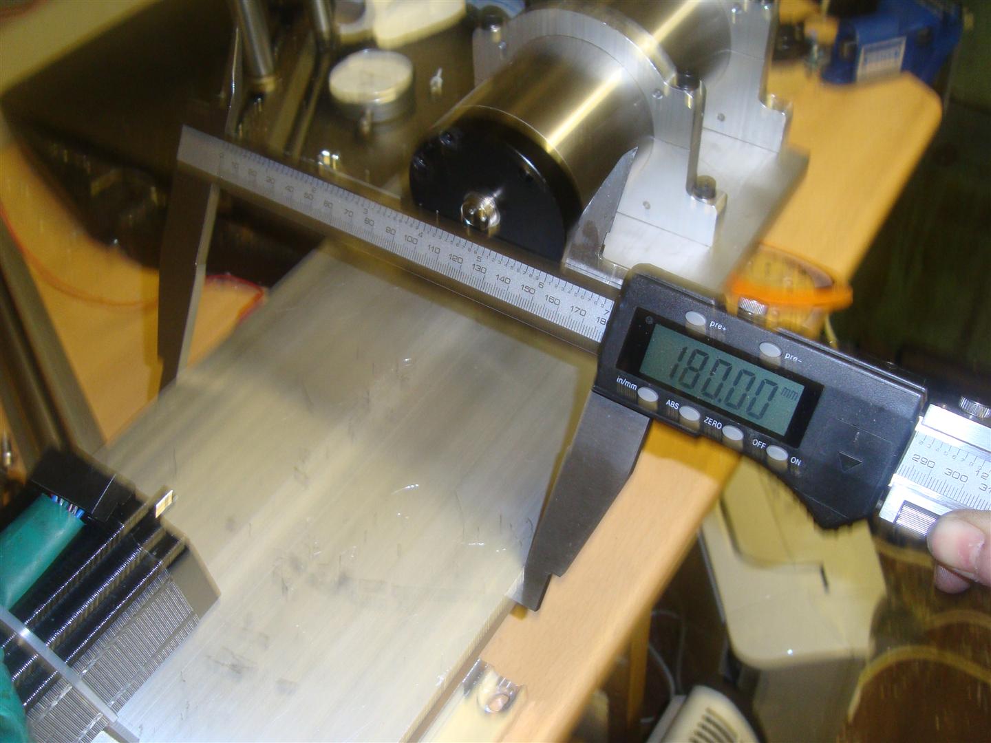

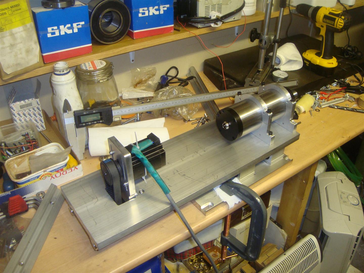

    My router is accurate, but alas still a bit off square:
Name:	DSC09180 (Large).JPG

    Made a quick nylon seal for additional protection as that bearing gets the most dust being right above the cutter:
Name:	DSC09170 (Large).JPG
    Will post a video and more info tomorrowish.
  6. #206
    they look amazing Jonathan
    But image 1 the bracket is inside out, motor needs mounting on the other side Hee Hee
    James
  7. #207
    Quote Originally Posted by luke11cnc View Post
    Oops, yes it does. It fits on both sides.

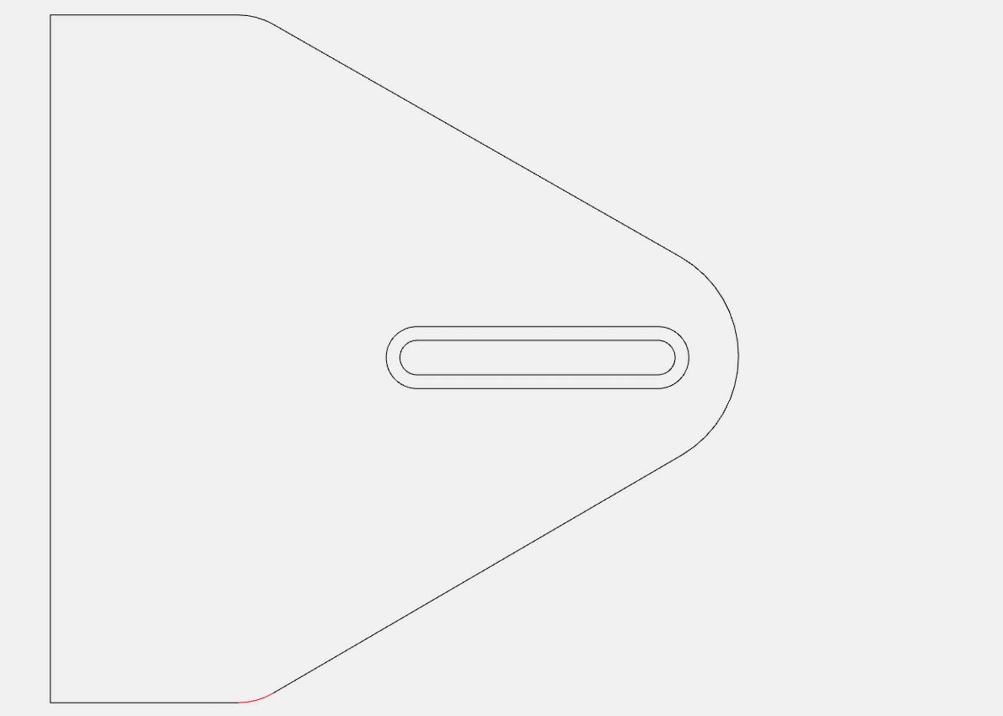

    Jonathan do you think we could make that third leg/mount adjustable ??
    James
  9. #209
    So it look's a bit like this:tup:
    Please note Jonathan this is not to scale
    James and Luke
  10. #210
    Yes I can and will change that.

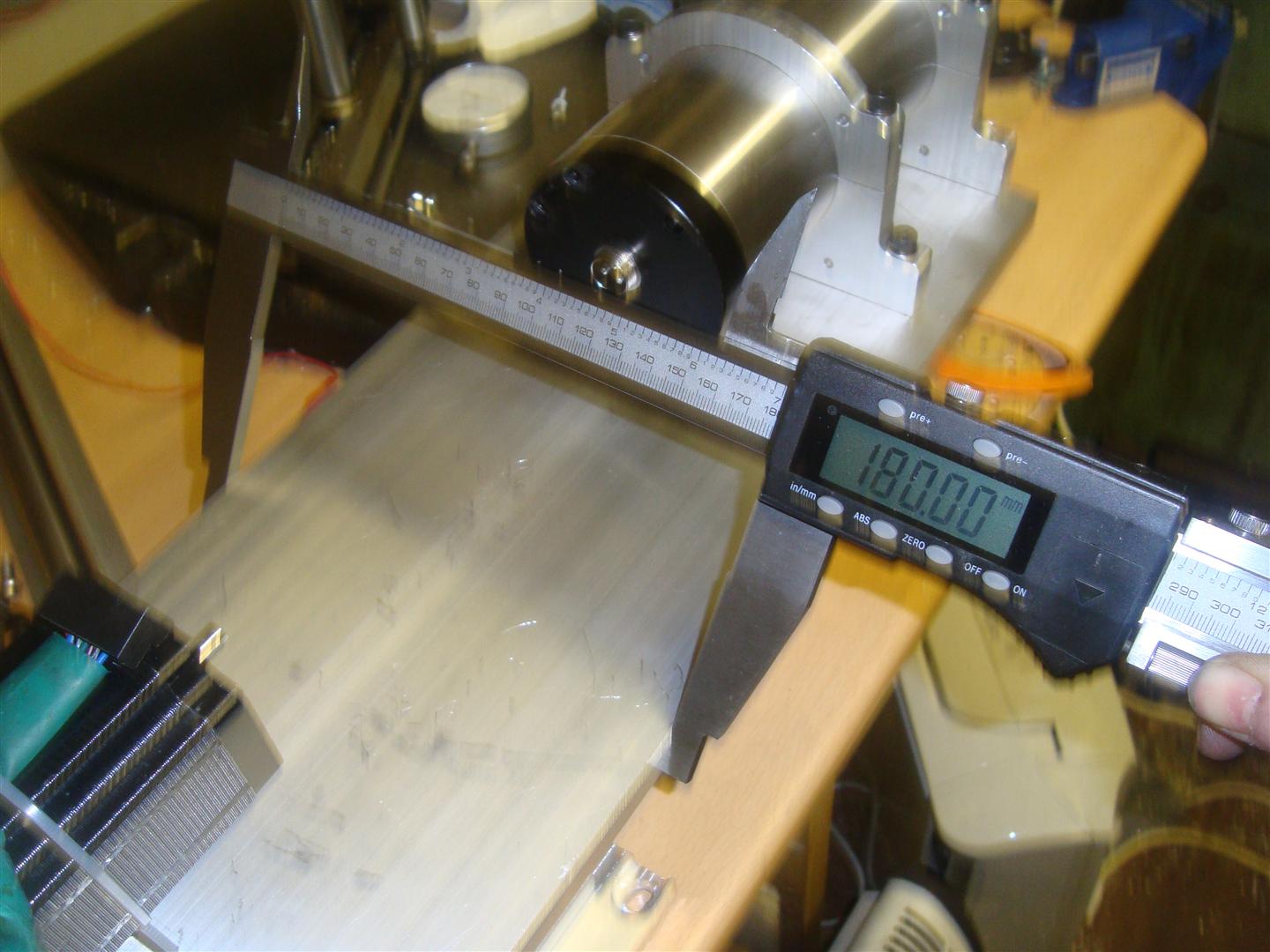

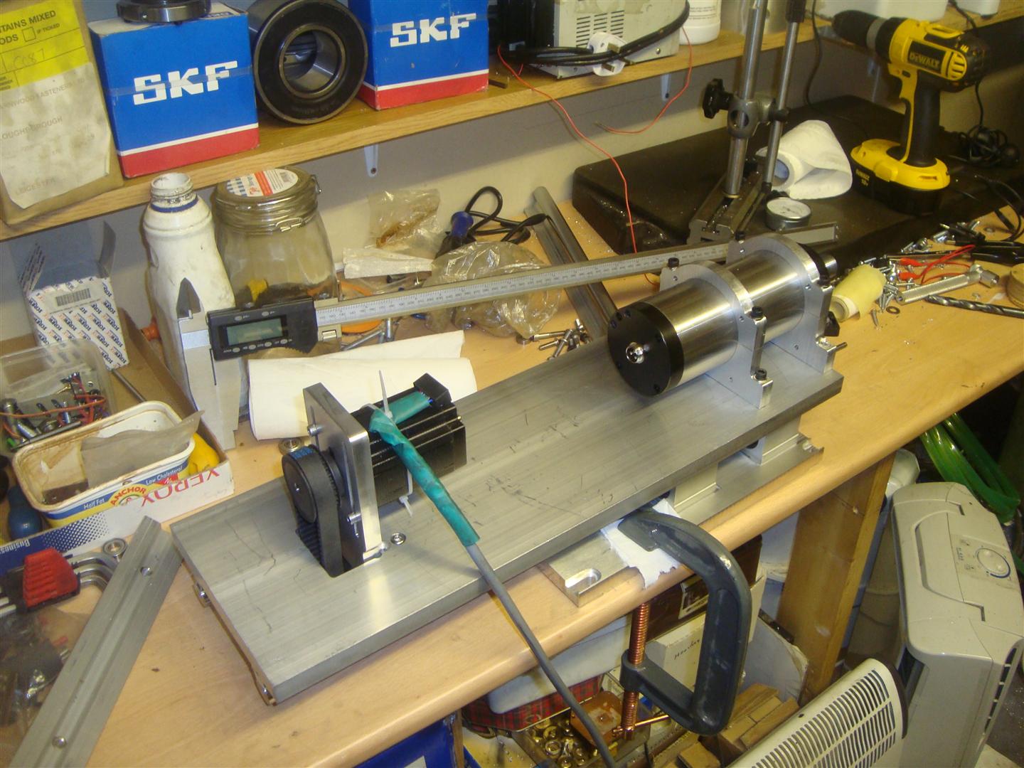

    http://www.youtube.com/watch?v=O4o6t...=youtube_gdata
    Putting the DTI where I did to start with is a bit pointless, but using it to test the runout revealed the runout is 0.06mm measured about 10mm from the chuck, which is poor. It increases linearly with distance too ... so the cutter is held at an angle to the axis of rotation. I measured inside the spindle bore too, and it's the same.
