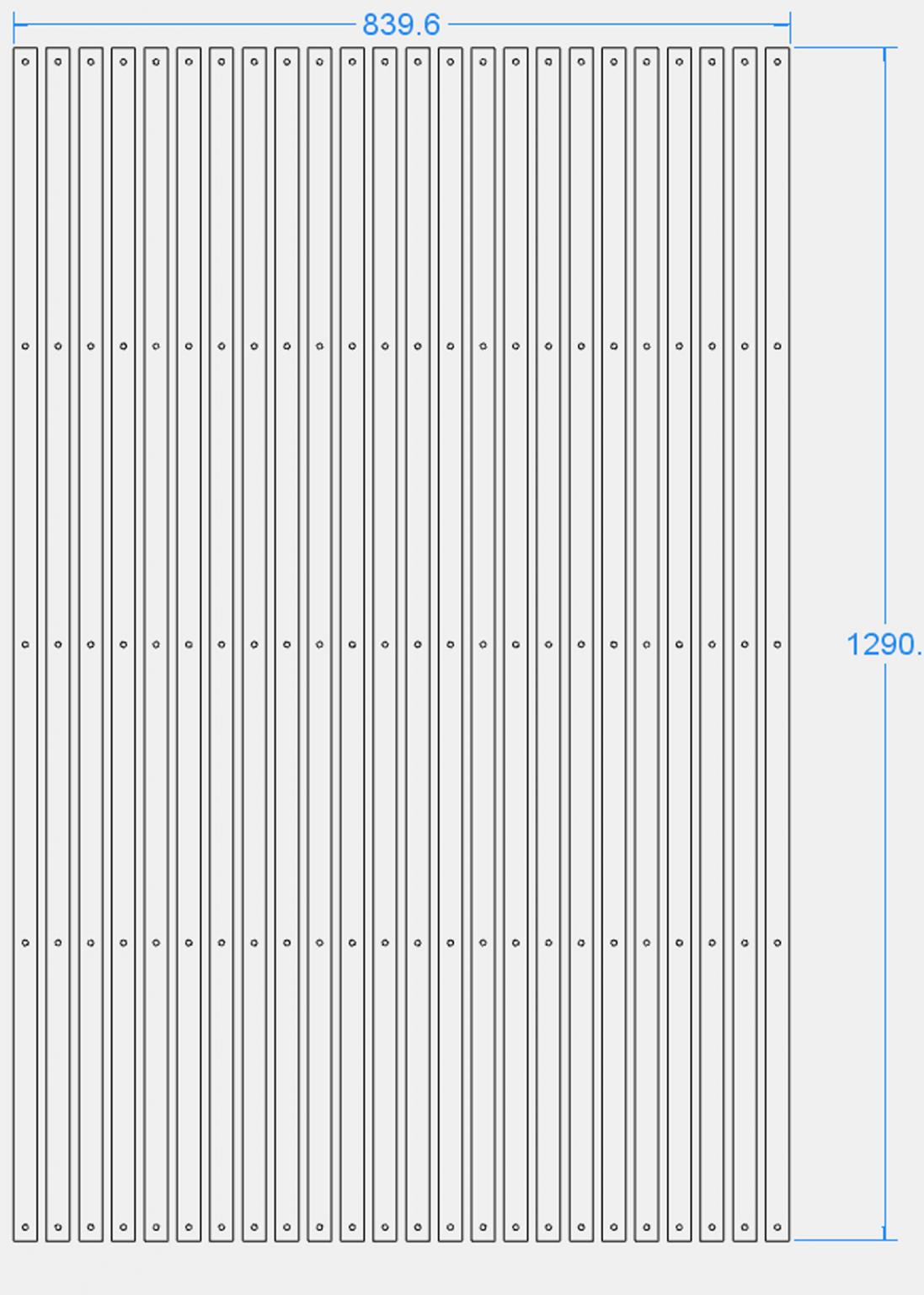

  4. #214
    this will cost me £160.00+vat
    9@4000
    1@2000
    James

    That gives you a roughly 71% aluminium (29% air...) bed, compared to 78% for Jazz's 35mm(?) strips. Not much less to be fair, but more frequent clamping slots, so only slightly weaker but as Jazz says he'd prefer them to be thicker anyway. Probably not much in it, but something to think about.

    That's 840mm wide which is 24 strips and you can get 3 strips per 4m length, so surely that's only 8@4000 (still £160). Or were you thinking of using the other bits for the perpendicular pieces underneath?

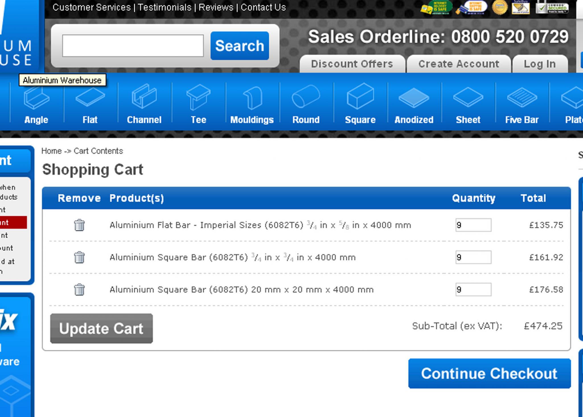

  7. #217
    Looking at the price list Jonathan I may go with 20x20mm so I have 5 or 6 mill worth of surface trimming so it should last me quite a while
    what do you think ??
    James
  8. #218
    It makes sense to use thicker, so yes 20mm. However I'd be inclined to use wider than 20mm strips (only 67% with 20mm and 10mm gap) for additional strength. It's less work to 40x20 compared to 20x20. If you went to maybe 40mm wide you can get two bolts side by side in each strip which should be stronger - less twisting? Not sure...
