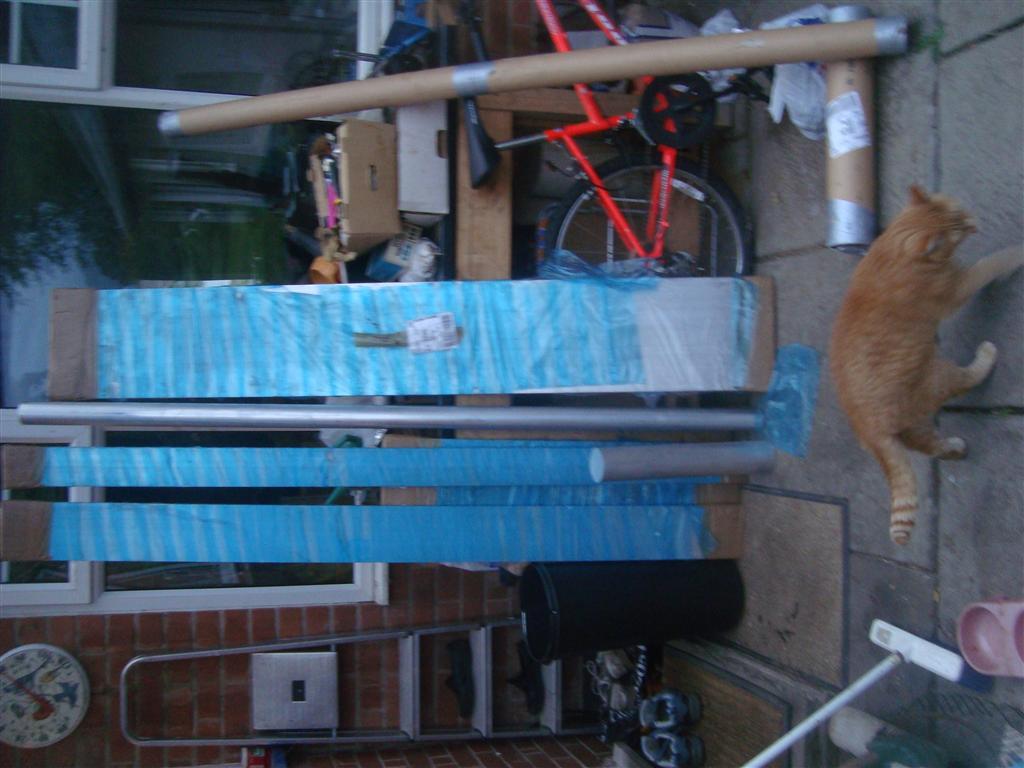

    This should keep us out of trouble for a while :heehee:
Name:	DSC08490 (Medium).JPG
    Edit: Just dropped one bit on the lawn and made a hole ... will be in trouble if I do that again!

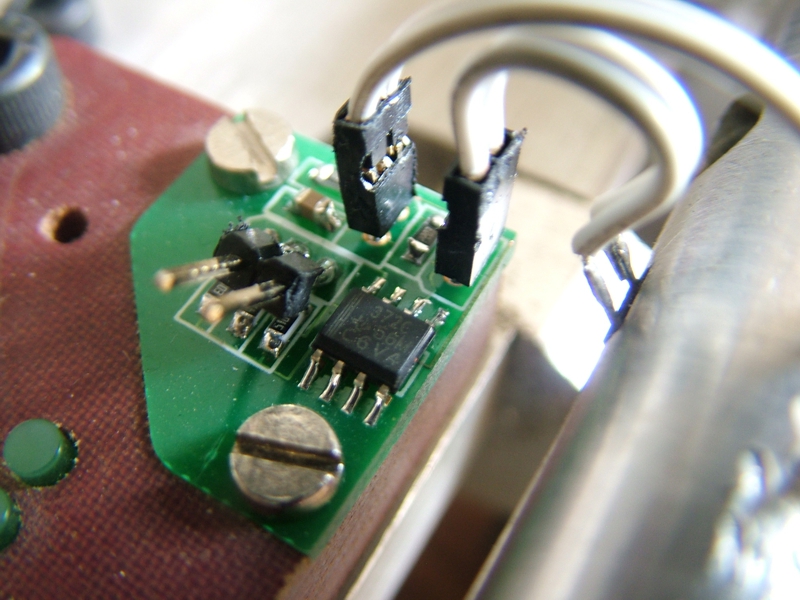

  9. #78
    If you want zero hysteresis consider a standard, photo-transistor opto-slot and feed it into an op-amp wired as a comparator.
    Hi Robin,
    Great advice robin, thou you might as well be talking Marshen if folks are not into electronics:rofl:
    Don't belive James/Luke are into electronics to that level, did consider suggesting opto switch's but didn't want to cause info overload.! . . . simpler to just say use good switch's and warn of the dangers of cheap bad switch's I thought.:question:
    I've considered using opto switch's on my machine when the existing switch's start playing up. . . Thou I'm a bit unsure if they'll be ok due to flying debrie passing the opto falsely triggering switch.? . . How do they handle flying Ali chips.?
    My machine must hold the world record for slinging chip's.! . . . They even make it into the house 20yards away.! . . . Thou my boots may play a part.:naughty:
  10. #79
    Well, in Martian...
    Probably need photo-diodes to pick them up if they have any speed, here's the circuit :heehee:
  11. #80
    Well, in Martian...
    He he spelling ain't my thing.:whistling:
