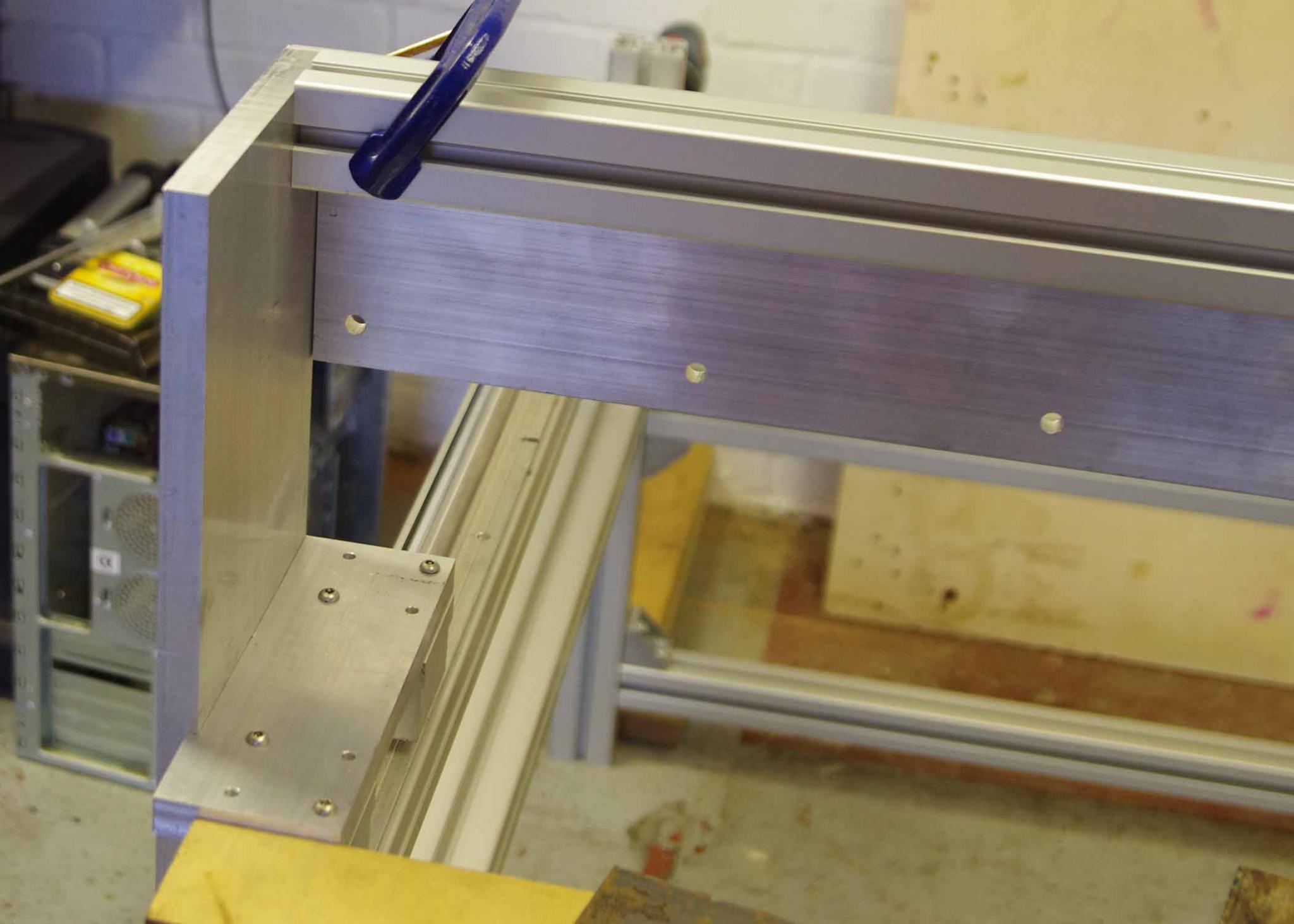

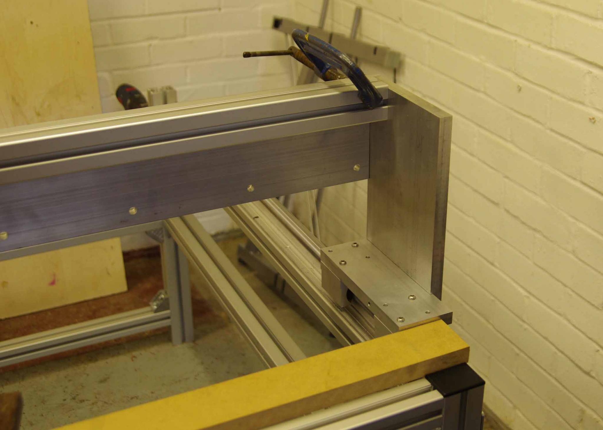

    Well after a long long week
    LUKE has broken his foot now
    So I have decided to crack on with the CNC machine

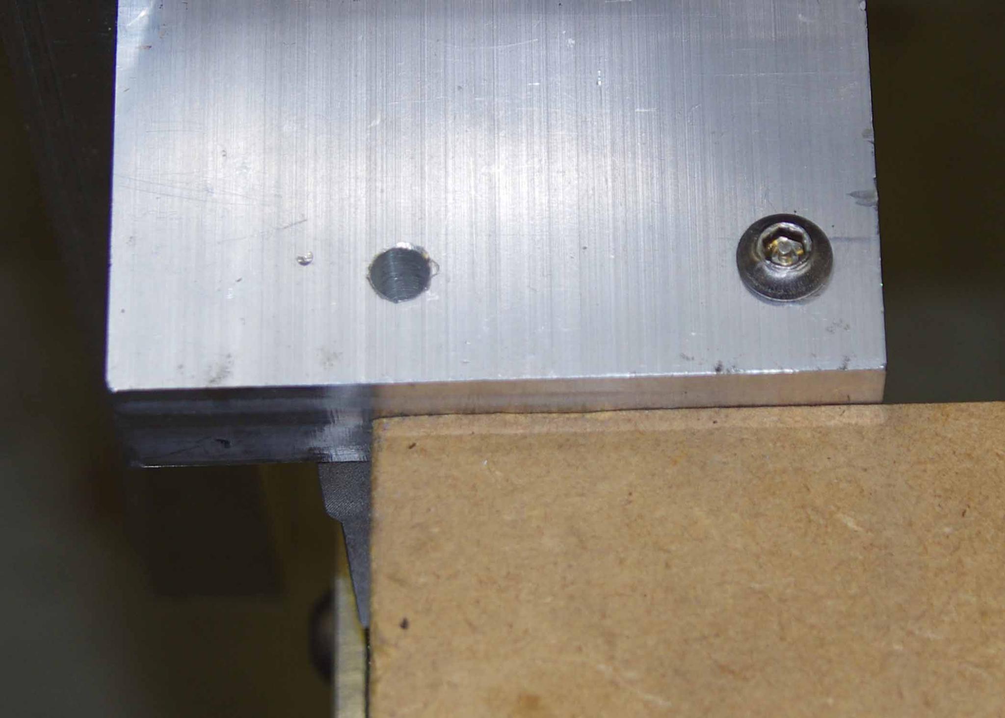

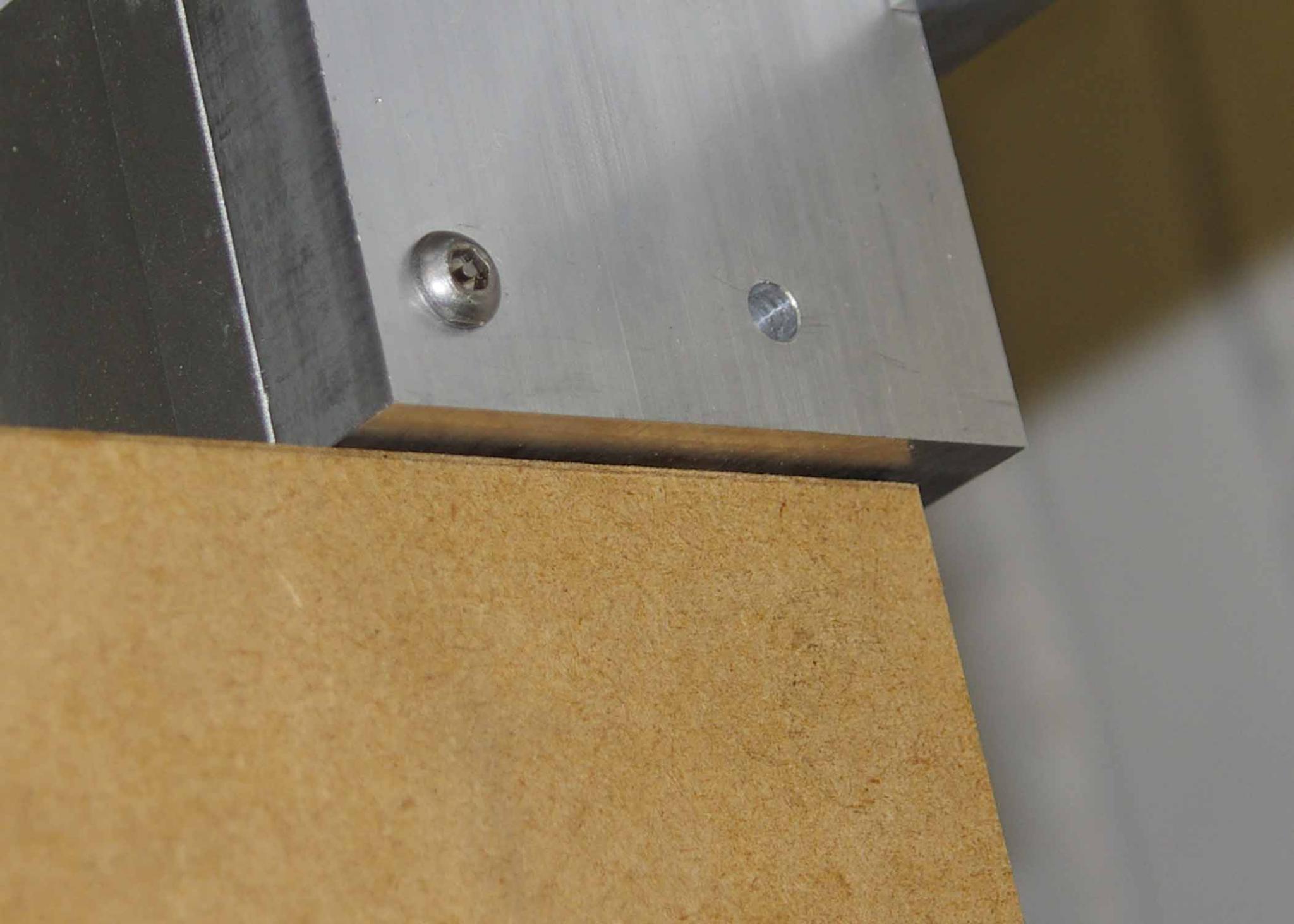

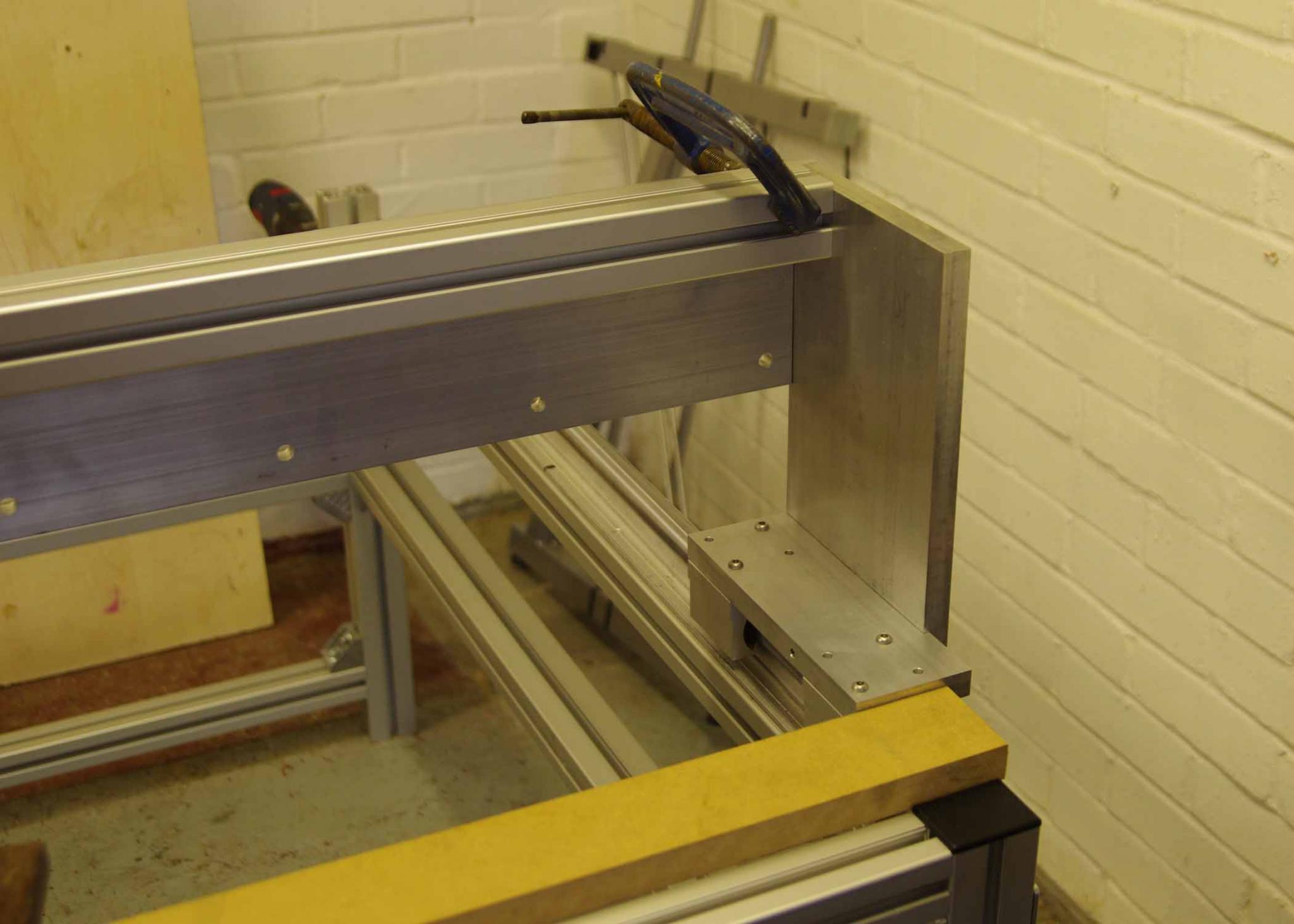

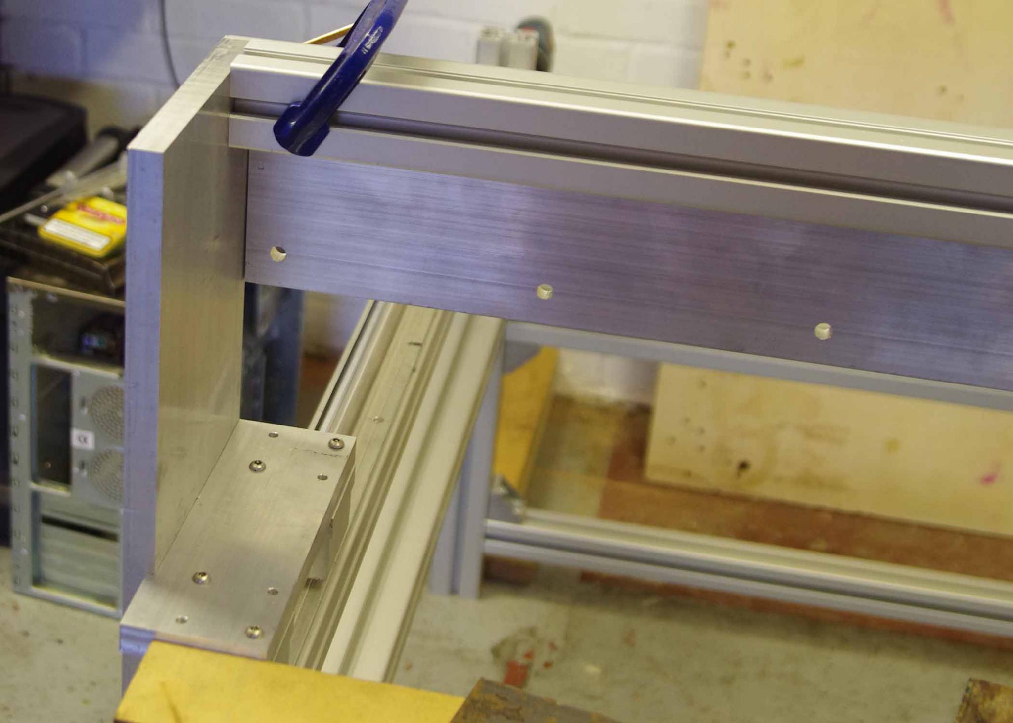

    Now the frame is true and square (spent all day Friday doing this) fitted ONE side of the gantry side to my ballscrew but I have some binding on the other side (about 5mm out)
    My rails are square and parallel but the gantry still refuse's to play. One side hits the end of the table and the other is around 5mm off (I can force the other side to meet the side at a right angel) but this is not right (every fibre of my body says "no, it’s not right") but I am all out of ideas
    I am going to look at the bearing today to see if they are mounted correctly (all facing in the same direction) would this throw my gantry out of square??
    I am at a loss to where things have gone wrong??
    Does it matter if the bearing are pointing in the same way ??
    The only two ways I can get the X-axis to run true is to force the right side over by about 5mm or have the table out of square
    I’ve just taken some images of the machine and its now only out about 2mm
    So I think I was over reacting and it was just crabbing
    But I think I would still like a second opinion

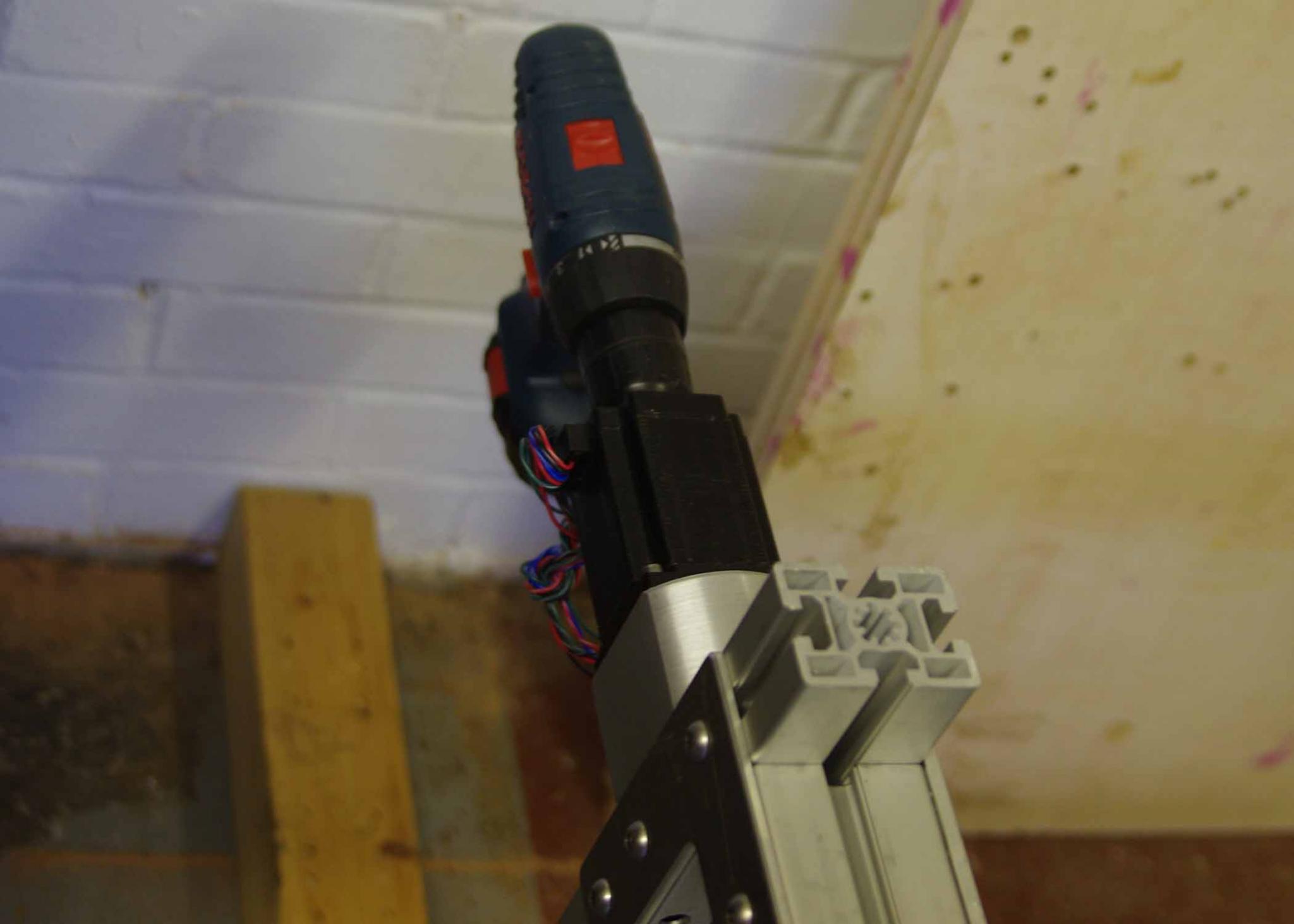

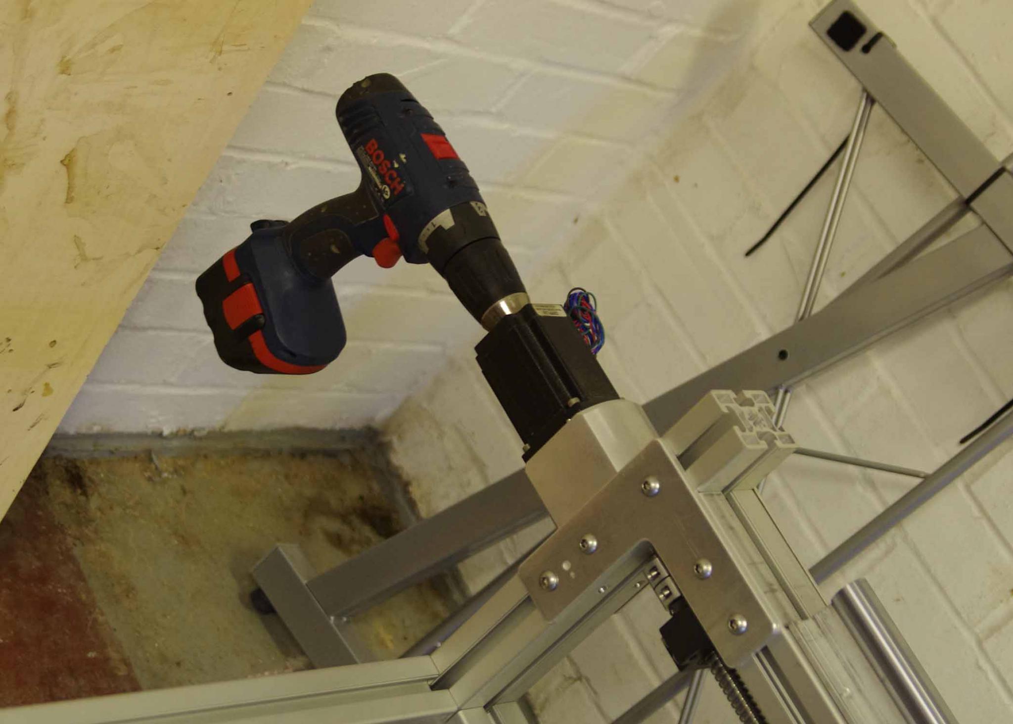

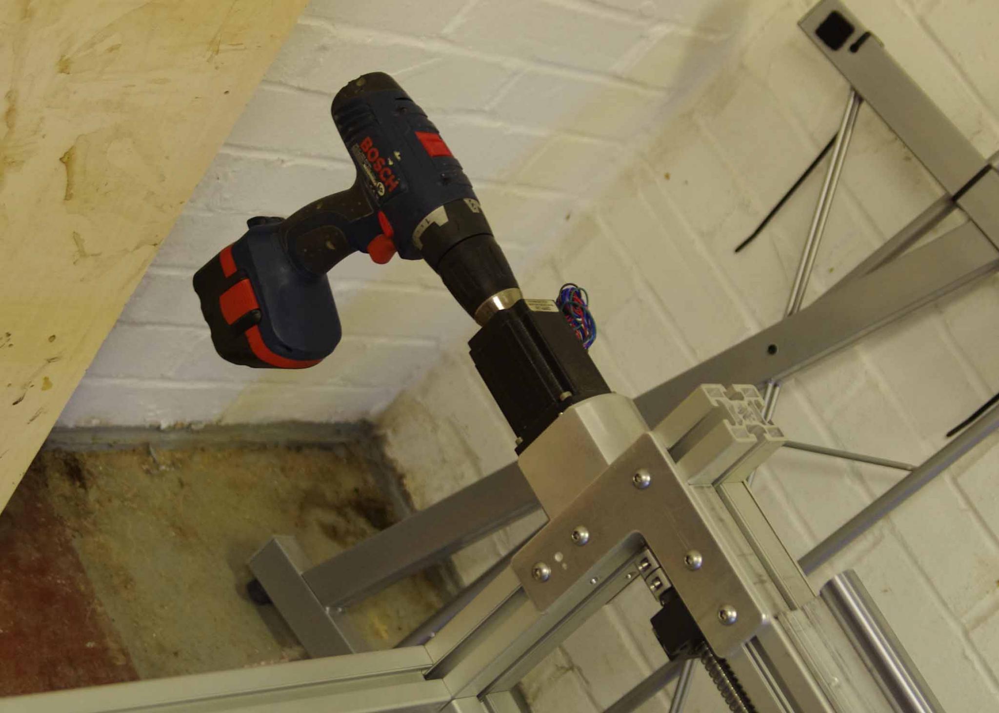

    do you like my drives two Bosch drills :naughty::naughty:
    today I'm going to tap my M10 T-nuts and start mounting the Y-axis
    James:tup::tup:
  4. #144
    James,
    it shoudnt matter which way round you mount the bearings. Keep up the work, your doing well. Can you post a photo of where the parts dont meet so we can get a better idea of whats happening?
    How do you manage to synchronize the bosch drills:heehee:

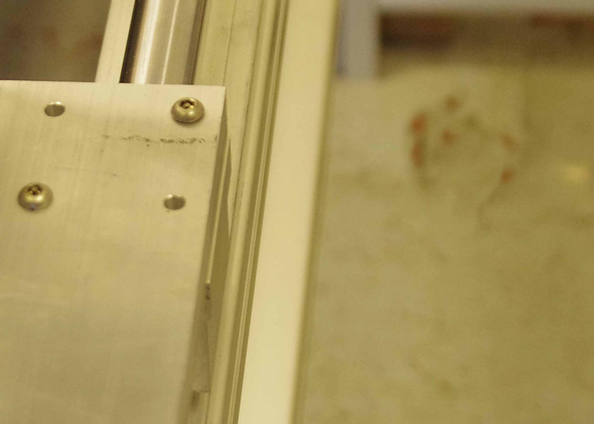

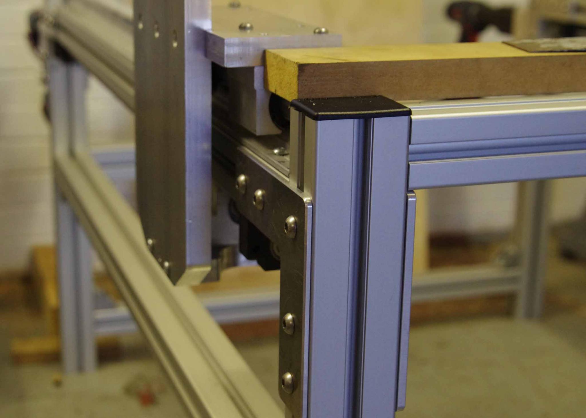

    Thank you Ian I couldn't do it with out help from this web site and it's friendly members

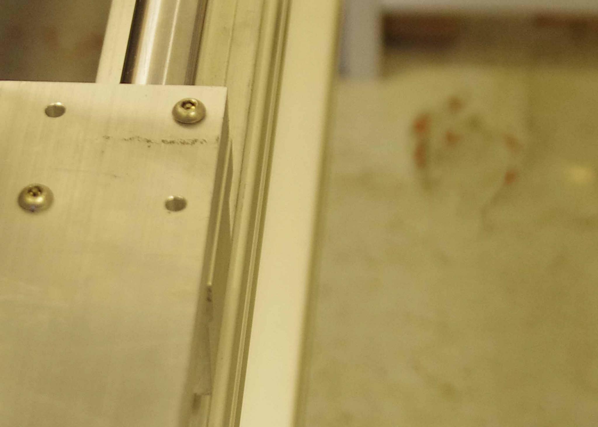

    Here is the two images of the x-axis bearings they should be in line but as you can see the right one is not tight to the MDF (about 1.5mm gap) But I can move it by hand.
ID:	4731 this is the left side
ID:	4732 this is the right side
    Is this just crabbing or should it be in line as It's not under any load ??
    James
  7. #146
    The joint where the 6" wide plate bolts on to the back of the gantry would have to be perfectly square for the gantry to also be square. The distance is so great that the angle on those joints doesn't have to be out by much at all to get 1.5mm out. Also I'd be amazed if the frame is actually perfectly square, so using it as a reference could be misleading. The other thing is the position of the X bearing mount plates and hole positions - they could be slightly out too. All these tolerances stack up, so it's hardly surprising to me that there's a 1.5mm error ... don't worry about it.
    If in the end the machine still wont cut square there's ways round it. If it's not much at all then you can position the X-home switches so that mach3 bends the gantry very slightly to square it when it homes. Clearly that's a bad plan if it's out by a lot as it would put a lot of strain on the structure and motors. You can also compensate in mach3 by using 'formulas' which enable you to make one axis a function of another axis. So you just put X=mY in the X formula box where m is the measured gradient / error. The difficult bit is measuring the error to start with as there's no straightforward reference.
    Maybe he's using the steppers as encoders to provide feedback...

    Thank you Jonathan
    I feel a lot better now did you get my email?
    I think the slight whip on the 12mm gantry support rail is not helping, I should be flat when both extrusions are bolted up to it. I was quite surprised when I offered the extrusion up to it and had to G clamp to get it flat.
