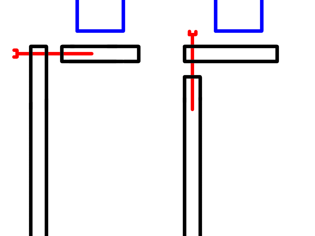

  10. #100
    Bugger,if you see the panel that holds the rails for the Y axis, the motor mount secures onto that on top. but it's a bugger to drill and I just screwed up it!So I'm going to need to get those two panels remade. the motor mount and the panel itself.I've drawn a drawringClick image for larger version.
ID:	5365on the right is how I've done it, this means it's super difficult to drill the hole down properly as I have to do it with a cordless. on the left is how it should have been done and how it is done on my X axis.I will probably post up a RFQ post after this, but this really is a Pain. I was so close to finishing.
