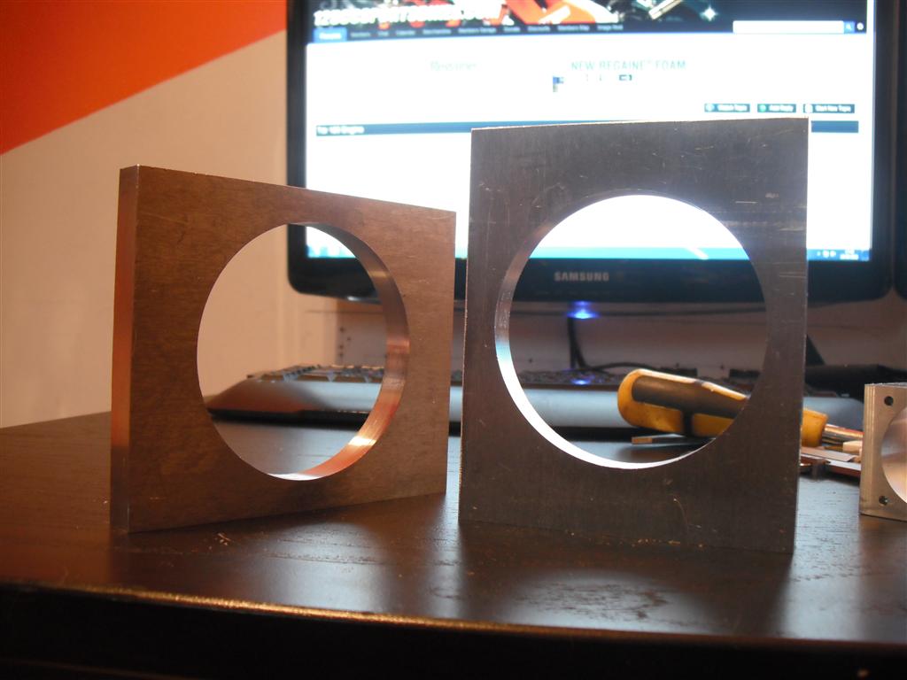

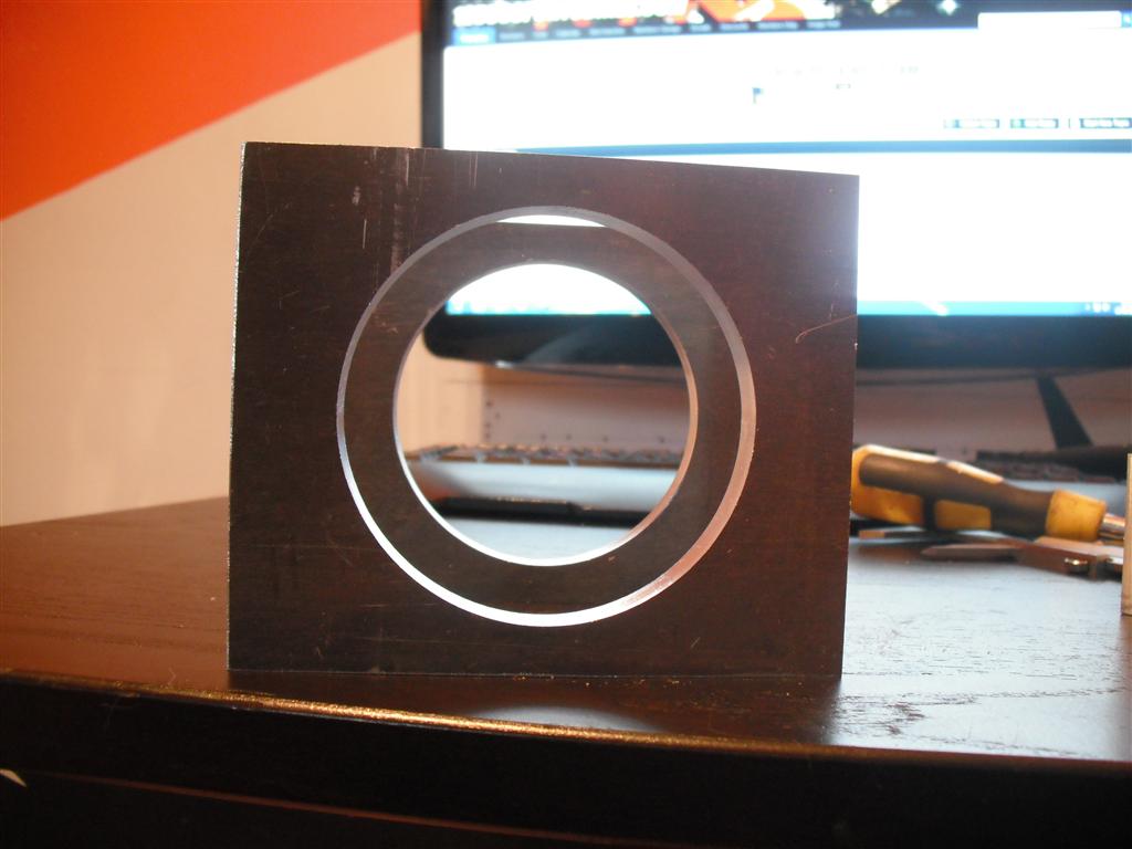

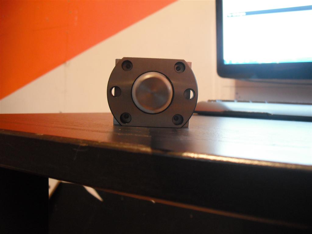

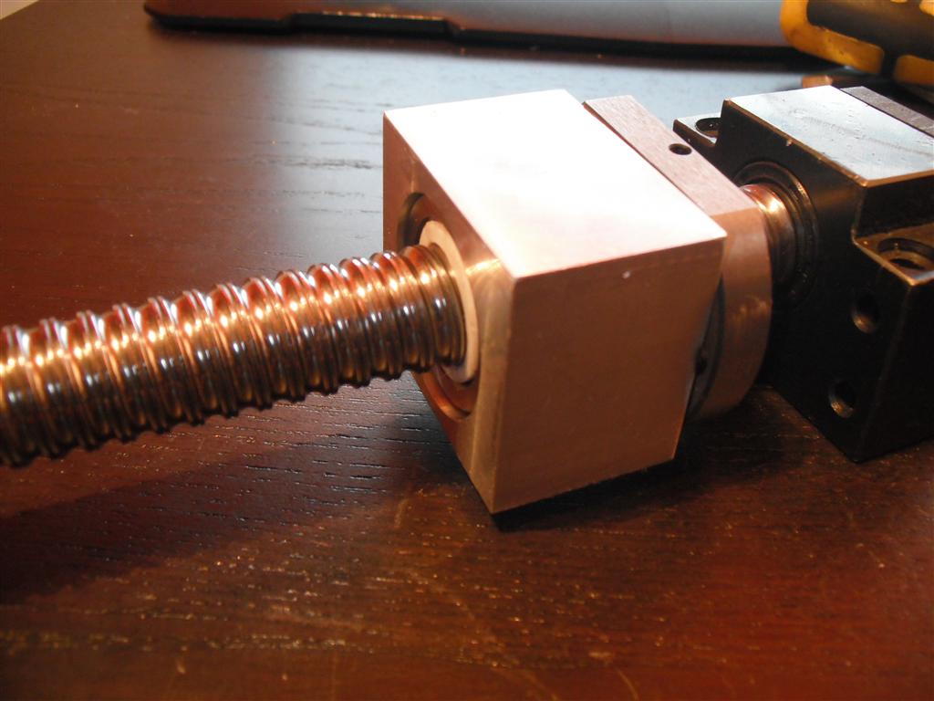

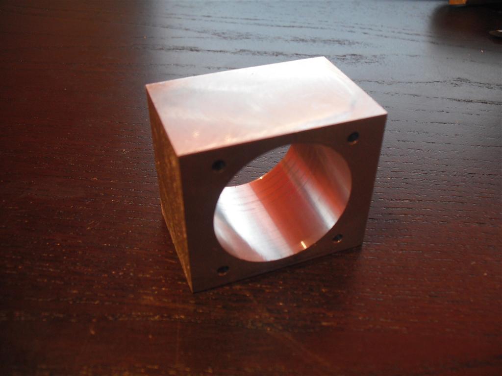

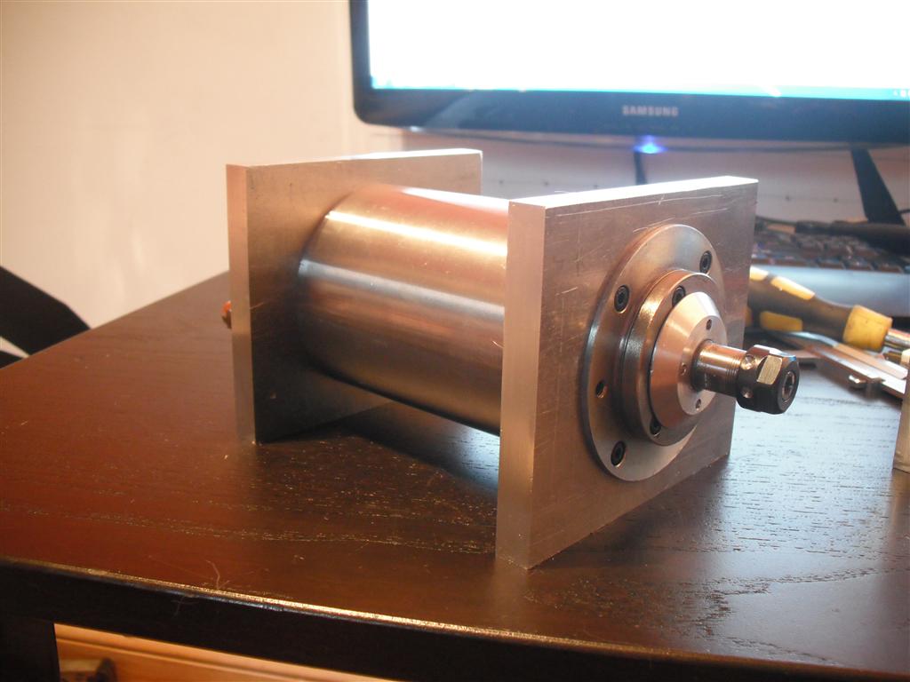

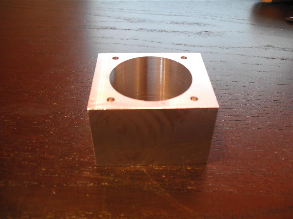

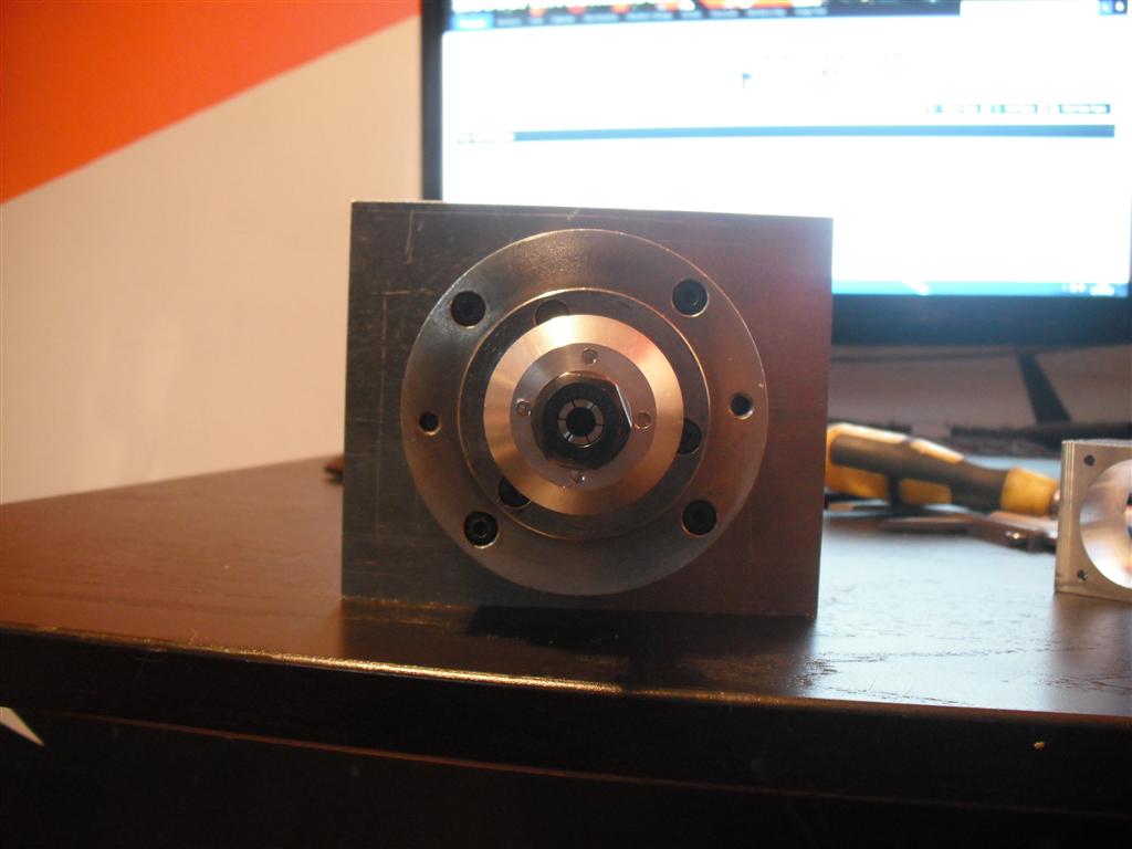

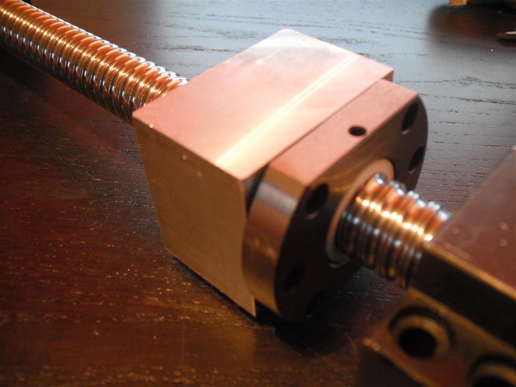

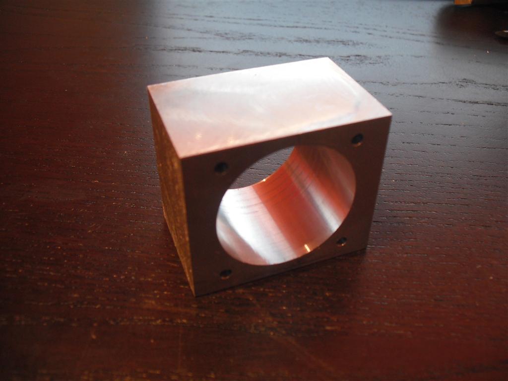

    I've milled most of the big blocks of alu in college so the edges are straight.
    Just need to start mounting everything and it will soon be done :D
    The Mill in college is complete crap, there is a MM of backlash on the X axis! really screws up my work :(
    The Y is ok though.
    Some of I2I's masterclass machining above.

    Looks like a good start :)
    Quote Originally Posted by jcb121 View Post
    1mm of backlash is mildly annoying, but it really doesn't affect the results when using manual milling machine. Unless of course you're not compensating for it / locking the slides if necessary?
  9. #69
    Lives in East Lothian, United Kingdom. Last Activity: 3 Hours Ago Forum Superstar, has done so much to help others, they deserve a medal. Has a total post count of 2,994. Received thanks 376 times, giving thanks to others 9 times.
    Looking good.
    Pictures!
    Only a poor workman blames their tools ;-)
    Every one of my manual machines has play, it's just a case of learning how to deal with it!
