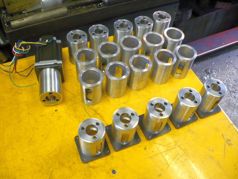

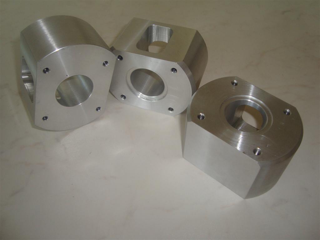

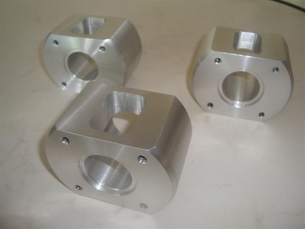

    Hmm, well here's my version:
Name:	DSC08223 (Medium).JPG
Name:	DSC08221 (Medium).JPG
    Took a while to make - next time I'll use CNC.
    How do they fasten to the machine ?
    John S -
    They are tapped M5 on both sides. So either use that or use 4 >50mm M4 bolts through the whole mount... I could put a shoulder on them with parting tool to make it so you can fasten from the same side as the motor without using the same bolts for the motor and fixing to frame.
  4. #14
    Here's one or rather twenty one I made today.
    Attachment 4310
