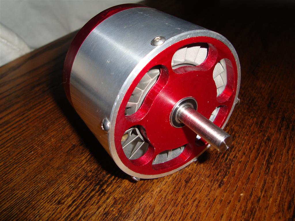

    Have you got the parts anodised, i have just started anodising my self with some great results.
    I have anodised several parts myself before with good results, however this sadly is not one of them.
    This is:

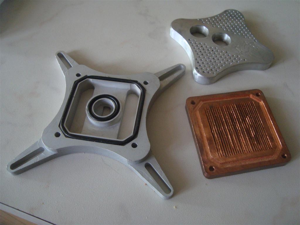

    Quote Originally Posted by fragger6662000 View Post
    i think you might have sealing issue with the o ring groove due to surface finish.
    I chose the correct sizes for the O-ring slots to ensure it seals properly. I will confirm this by submerging it in water and pressurising it with compressed air. If I see bubbles then either there's a problem or I'm using a much higher than operating pressure.

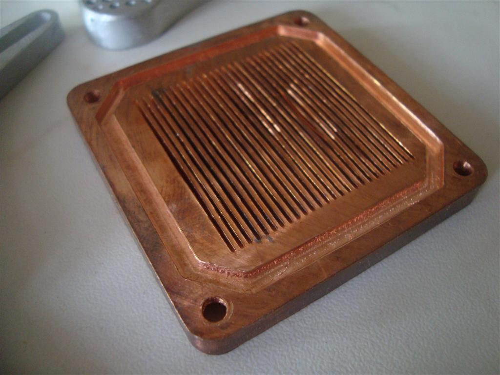

    i would avoid nickel plating the copper as it will affect the thermal transfer.
    While this is true, the effect is rendered neglegible by the several micrometre thickness of the plating. This is widely accepted as the best solution to galvanic corrosion, confirmed by nickel plating throughout the majority of high ended water coolign components.
    Some more pictures showing the copper block and assembled parts:Click image for larger version.

    you did well machining the copper as it does have a tendency to work harden and snatch tools. i was sure you were going to pressure test it, but o rings do need a good surface to seal. I designed something similar and it let in coolant like there was nothing there.

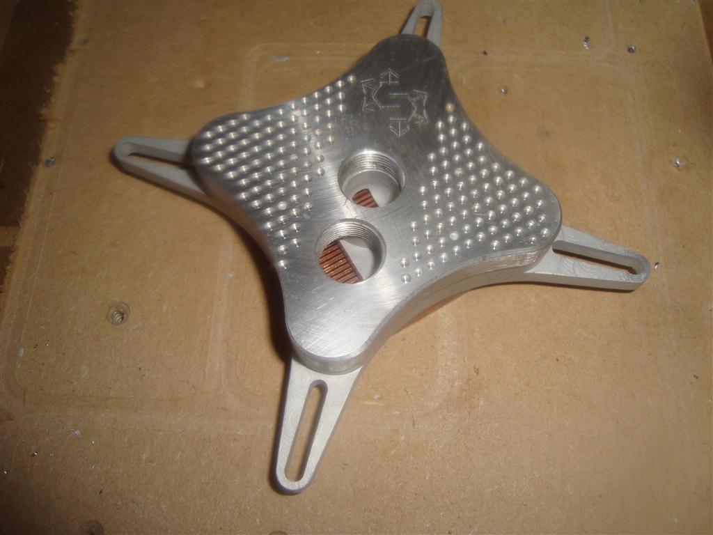

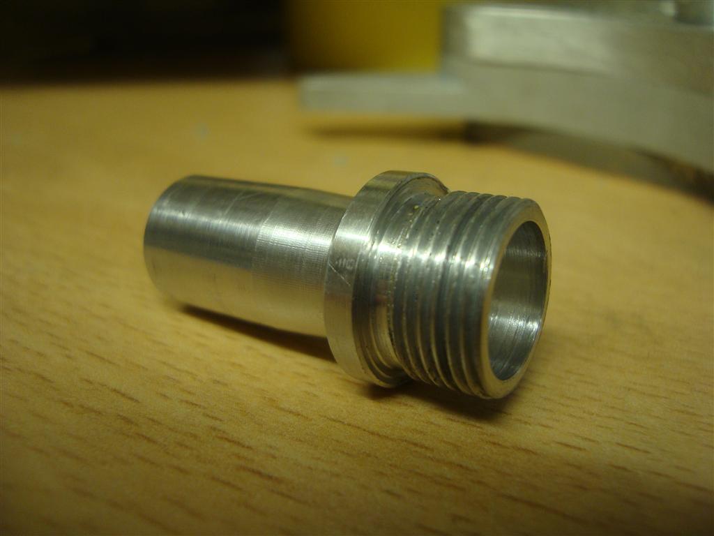

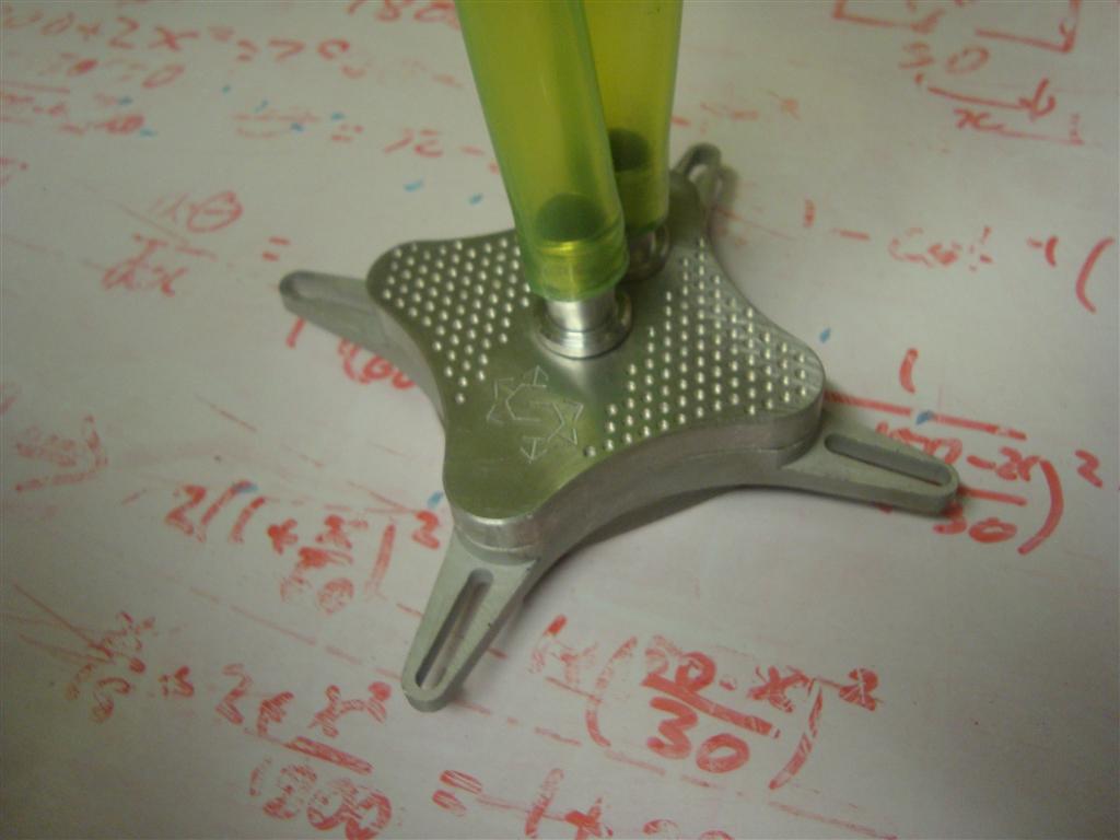

    Cut the connectors for the water tube, nothing special here. Cut the M14x1 thread on the lathe to ensure it's not wonky.
    Also nickel plated the copper which worked well, but forgot to take a photo.
Name:	DSC09263 (Medium).JPG

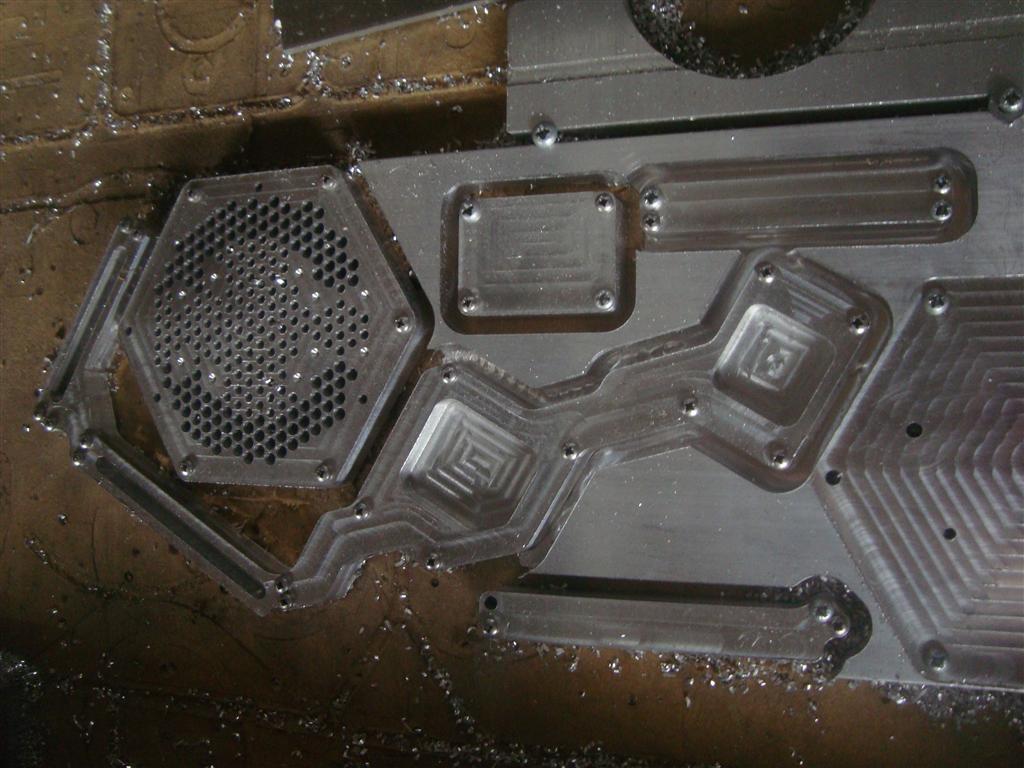

    Almost - I generally get it to drill the holes first, then put screws in those holes and then cut the inside and outside profile. Doing it in that order means the material doesn't have to be clamped to the bed particularly well to start with.
    It gets annoying when, as I have today, there's 180 parts to screw down with 2 screws in each...tried double sided tape but that left a bit of a mess and still needed one screw in each to be sure.
    I found it is good way to mount when cutting lots of small parts. I use drywall screws + power screwdriver- quick and easy. Drywall screws have sharp threads and cross-groove which locks perfectly with screwdriver bits- no slippage thou. And obviously no need to worry to match mounting holes/grooves in machine bed.
