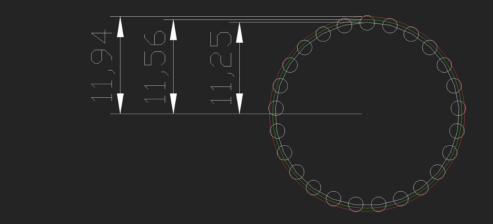

    I like this idea a lot, is there a method to calculate the hole sizes and position around the edge?
  6. Quote Originally Posted by 2e0poz View Post
    I did like this:
    number of holes multiply by the pulley pitch
    25 x 3mm = 75mm circumference of pitch circle
    so the radius will be 75/2 x 3.14 - it's not the pulley diameter which going to be smaller

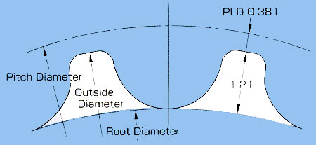

    The hole between teeth diameter is 1.8mm in case of 3m HTD pulley
    From the radius length previously calculated subtract 0.691 mm (as per pics above)
    11.9366 -0.691 = 11.2456mm radius of circle where you drill holes
    In any CAD program draw polygon which number of sides correspond to the teeth number inscribed in circle of diameter previously calculated (11.2456mm - in my case)
    Place circles of 1.8 dia in a peaks of polygon
    and now the resulting ring of small circles is a pattern for cnc to drill
    Hope I described it logically
    I'll try to upload some drawing later

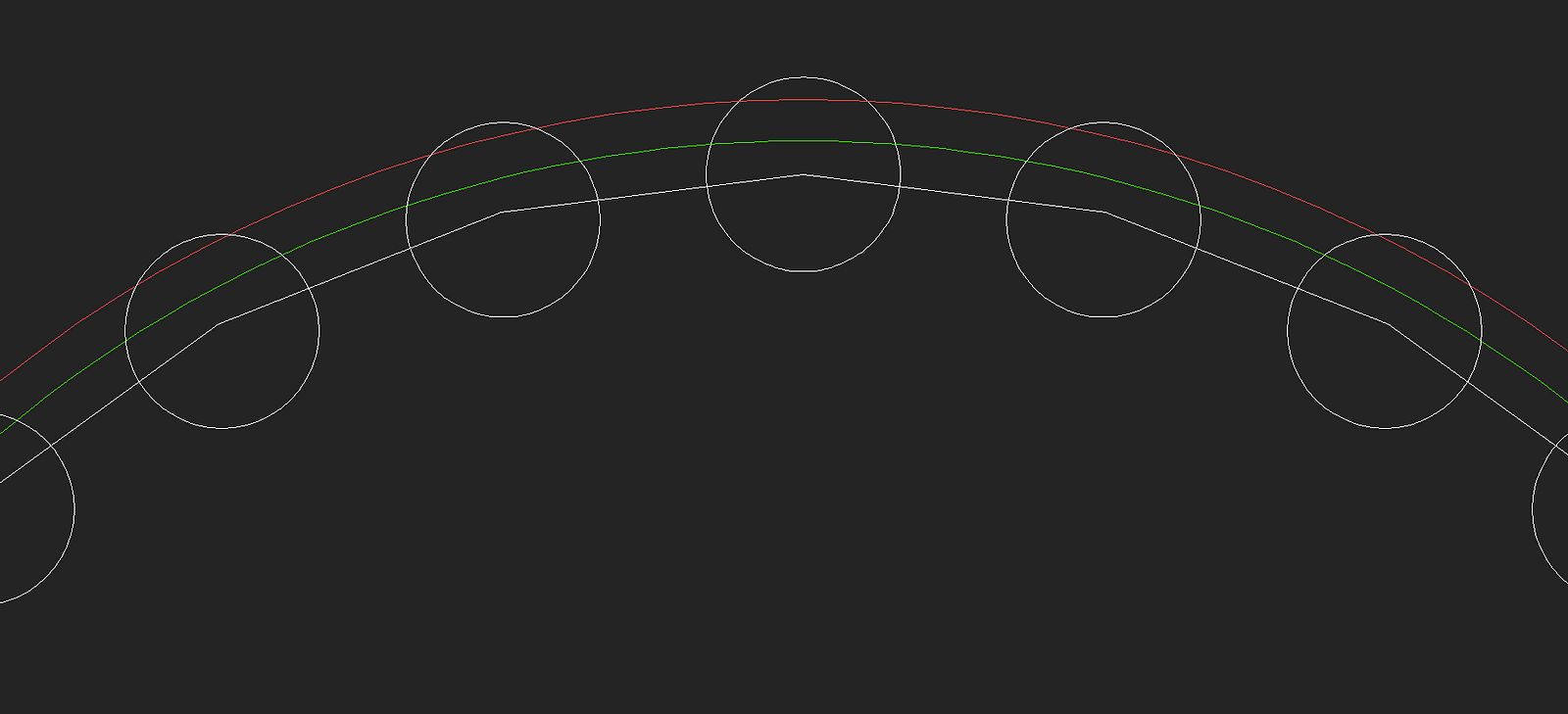

  7. That's an actual drawing of my pulley
    red circle is the pulley pitch
    green - pulley diameter which i turned down after milling + filing to chamfer an edge
    white polygon inscribed in circle of 11.2456mm
    That's the way I did it, but if you have Gearotic it will draw you nice pulley shape- that's easier way, but for my curiosity and making my life more complicated I troubled myself with all the calculations :rofl:.
    Hope it helps
