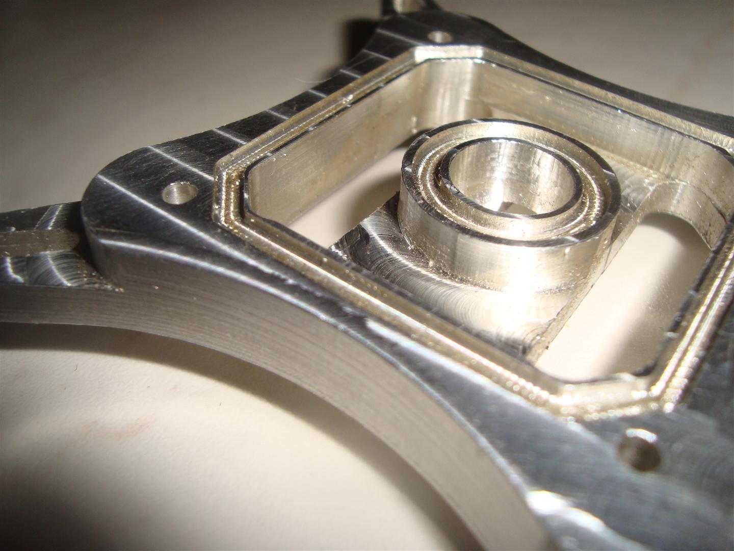

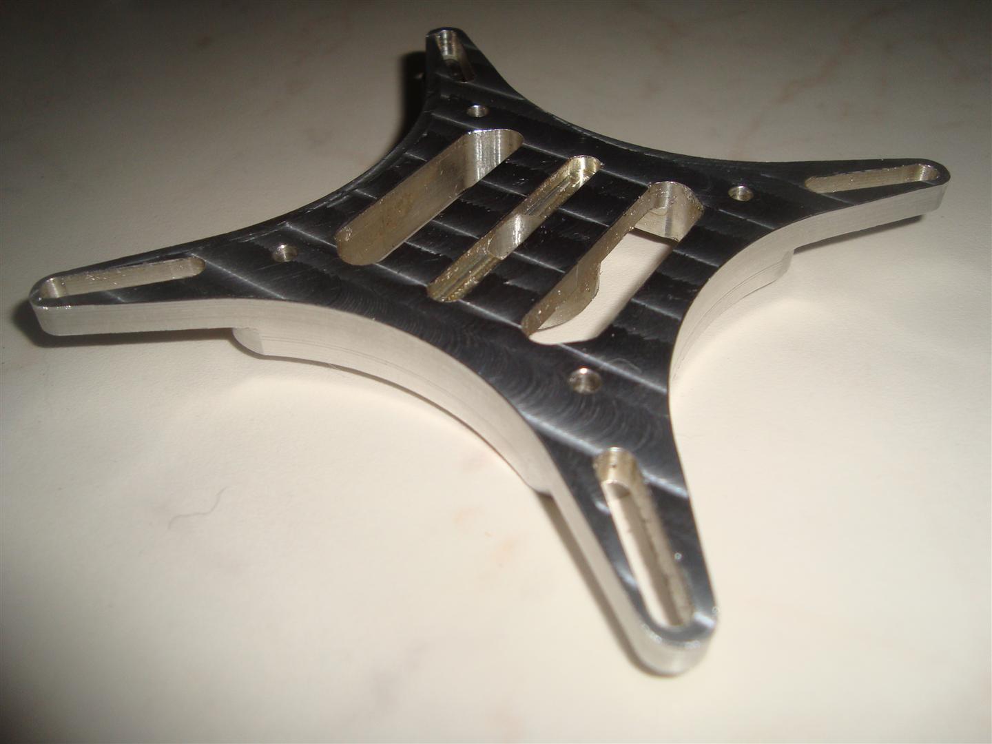

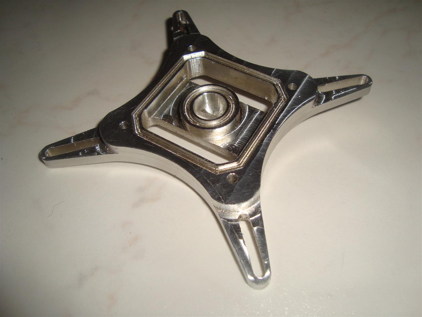

    I'm making a water cooling system for my friend's computer with i7 processor. The cooling block is basically 3 parts, a copper plate that's fixed to the processor, an 'injection plate' which guides the water through the copper plate and a plate on top to attach the pipes.
    Here's the injection plate, just done with my CNC router ... not the milling machine!

    Took quite a while to make that - mainly due to needing 7 different tools (milling cutters from 2mm to 10mm and drills) and machining on both sides. The actual cutting time wasn't too bad.
    It will be anodised next, and the copper part nickel plated.

    nice one man... 10mm!!! looks quite clean, have you lowered your gantry ?

    Thanks for the kind words. The 10mm cutter was used on the router to reduce the thickness from 12.7mm to 10mm (part is 110*110*10mm)... I used 0.8mm depth of cut.

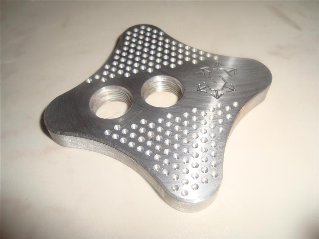

    Some progress with this - here's the block that holds the pipes with decorative engraving done with 0.8mm and 2mm tools:

    Cooling block for motherboard and graphics card to follow shortly ... need to buy some 6mm (or so) aluminium. I'll probably get this as it looks useful:

    Have you got the parts anodised, i have just started anodising my self with some great results.
    i think you might have sealing issue with the o ring groove due to surface finish.
    i would avoid nickel plating the copper as it will affect the thermal transfer.
