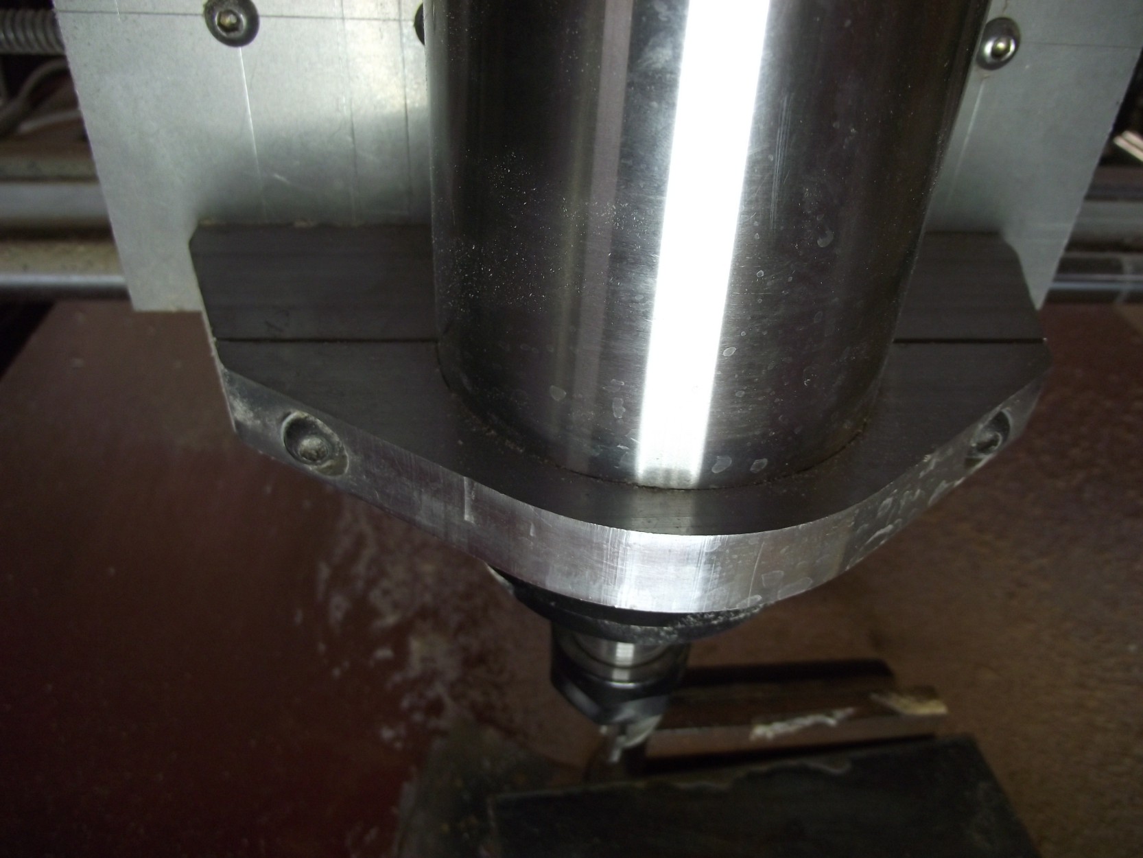

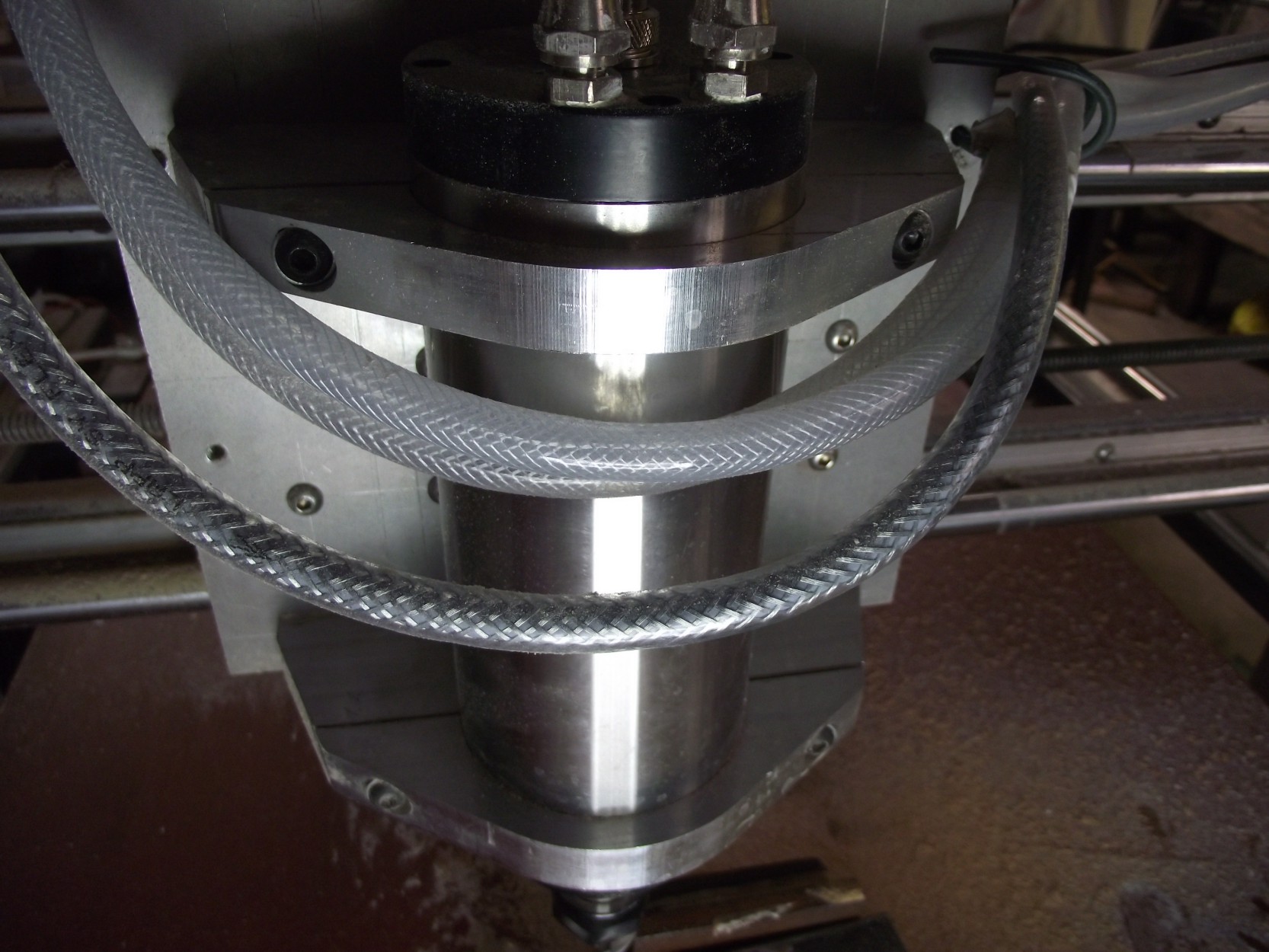

    Oh also, here's some pictures of yet another one:
    It's 188mm wide if I recall correctly.
  10. #20
    Hmmm im torn between the 2 now, is there any sort of difference? apart from the obvious size lol
