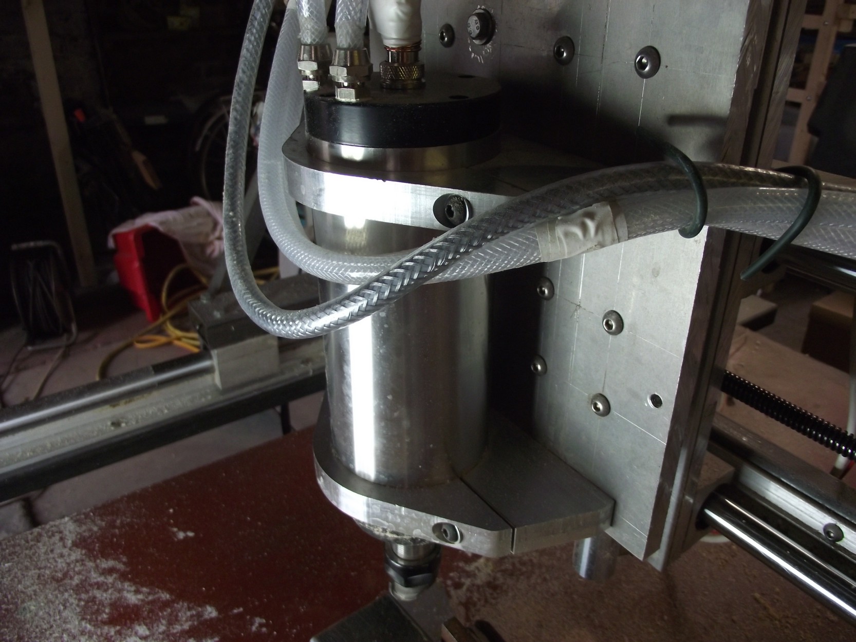

    Possibly a bit late now, but just in case anyone reads this and is interested in one here's the 'latest version' without the aforementioned weaker point:

    One with the clamping bolt at the side:

    Nice bit of work Jonathan.
    I like the second design with the clamp at the side, nice and tidy.
    Ian

    Nice design, but I don't think you were going to have any problems with the originals apart from the sharrp corners. These are tidy though.
  4. #14
    Quote Originally Posted by Peter. View Post
    I agree entirely, but most people immediately point out the sharp corner and start complaining - I though it would be best to rectify it.
    Thanks...I wasn't so sure about the clamp at the side as the clamping pressure is probably less even, and if the spindle is a little too big it won't open up much. Still it's marginally quicker to cut so no problem there!

    Sorry to hijack, but as it goes, I'm presently knocking up spindle mount in CAD for my spindle which has a 43mm throat (or collar?)
    What diameter should I make the spindle holding hole in the mount - bang on 43mm ....or is it standard to say add a 0.5mm, 1mm to the diameter etc?
    Also if adding a little bit to the diameter (to aid getting the actualy spindle into the mount), what 'gap' do you then allow to pinch the bolt onto the spindle?
  7. #17
    Lives in East Lothian, United Kingdom. Last Activity: 14 Hours Ago Forum Superstar, has done so much to help others, they deserve a medal. Has a total post count of 2,994. Received thanks 376 times, giving thanks to others 9 times.
    I'd personally go for bang on, that way you get more even, and better clamping force. The more undersize/oversize you go, the more the collar has to deform to clamp, resulting in a less uniform clamping force on the spindle.
    As for the slot, if you get it bang on, then a hacksaw blade cut should be more than enough, and if needed wedge the slot open a bit with a plain screwdriver until you get the spindle in.
  8. #18
    I agree entirely. I generally bore it on my lathe (to get an optimal finish and accurate circle) using my spindle as a gauge. When my spindle only just slides in I stop. Next I machine the slot with a 1mm slitting saw and on one occasion 0.5mm as the 1mm broke. Doesn't make a difference. Next I put my spindle in the two mounts with one at either end with them resting on surface plate. Then use height gauge to measure difference between centre height at each end and put one or both of the mounts in mill and skim the measured amount off so that the spindle will be held precisely parallel to the Z-axis plate.

    Oh also, here's some pictures of yet another one:

    It's 188mm wide if I recall correctly.
