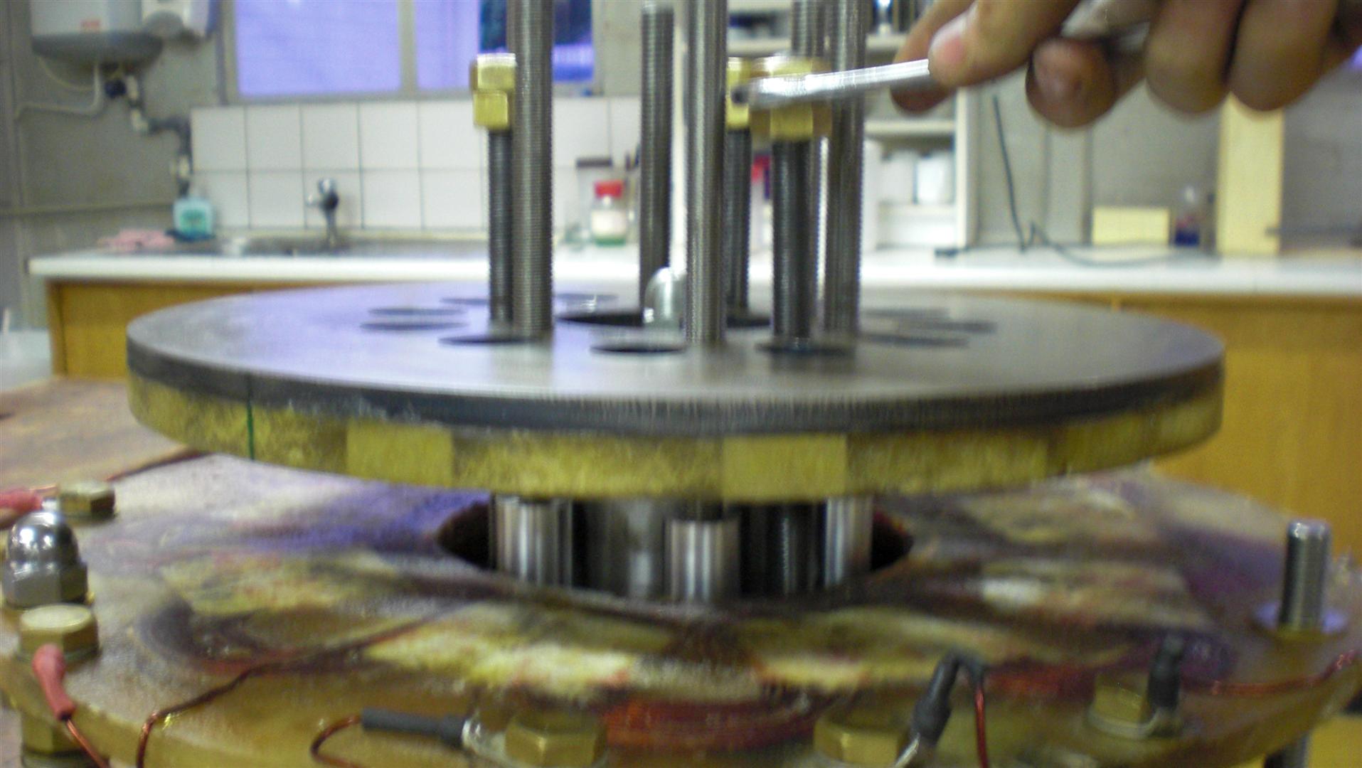

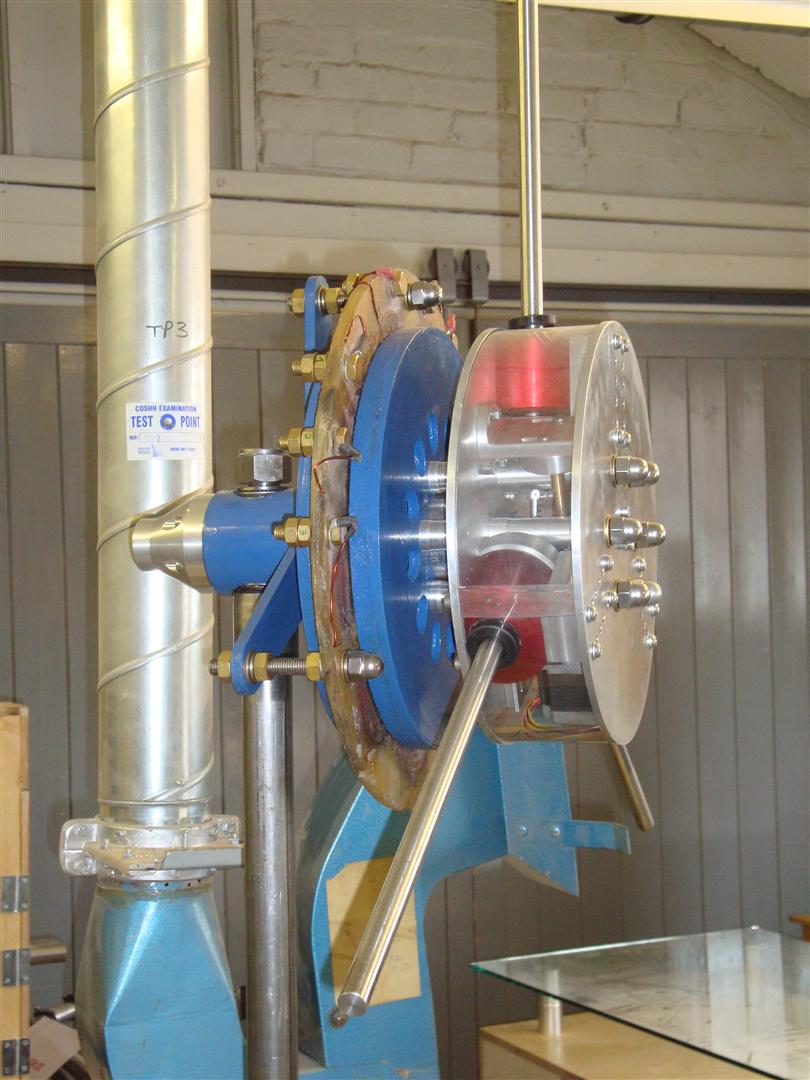

    There's better ways - make your own with neodymium magnets and copper coils. I've made a couple for wind turbines, will post a couple of pictures in a minute.

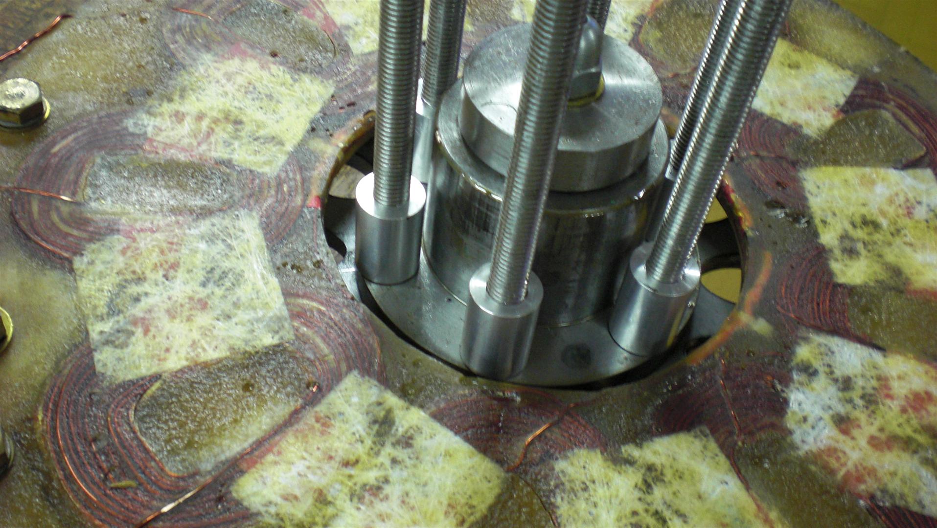

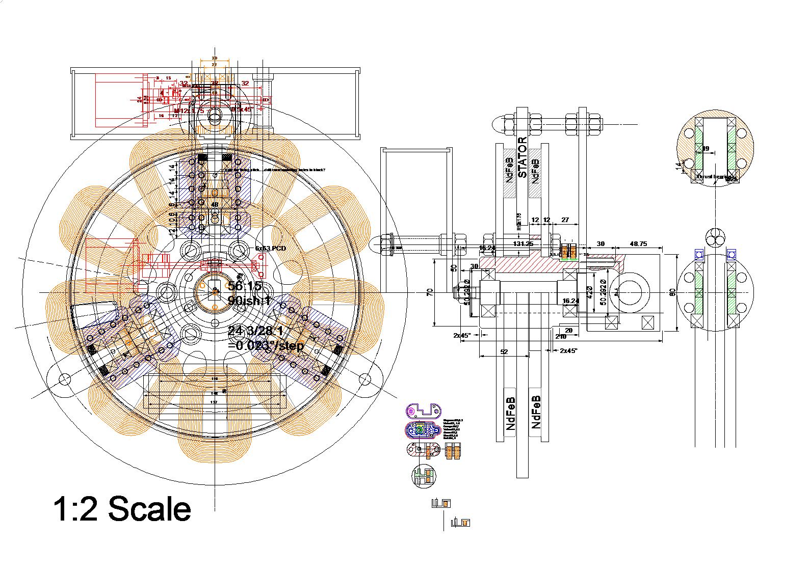

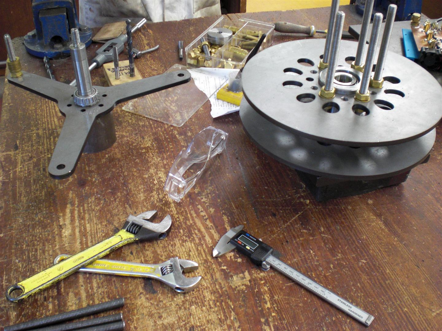

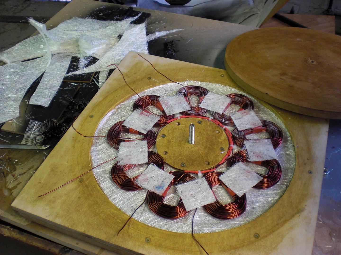

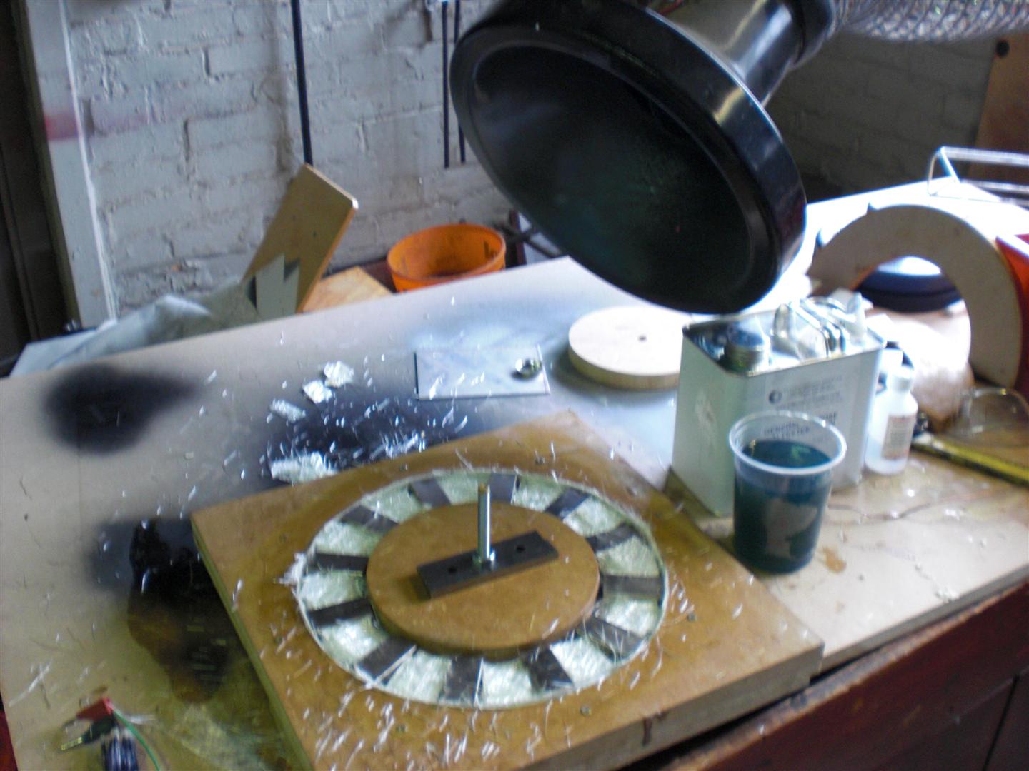

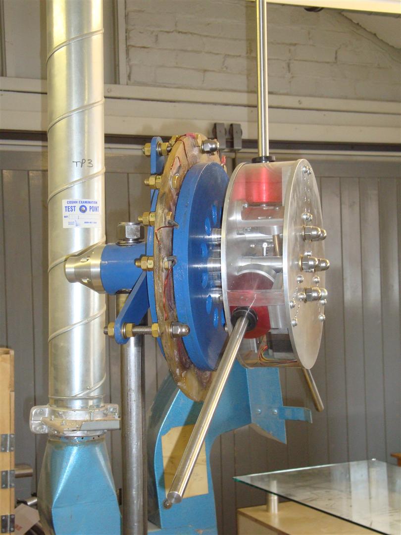

    If you're thinking of making a wind turbine then you might be interested in the (roughly) 1kW generator & variable pitch wind turbine I made:
    (In no particular order)
Name:	CIMG0330 (Large).JPG
Name:	CIMG0212 (Large).JPG
Name:	CIMG0173 (Large).JPG
Name:	CIMG0332 (Large).JPG
Name:	CIMG0162 (Large).JPG
Name:	DSC03946 (Large).JPG

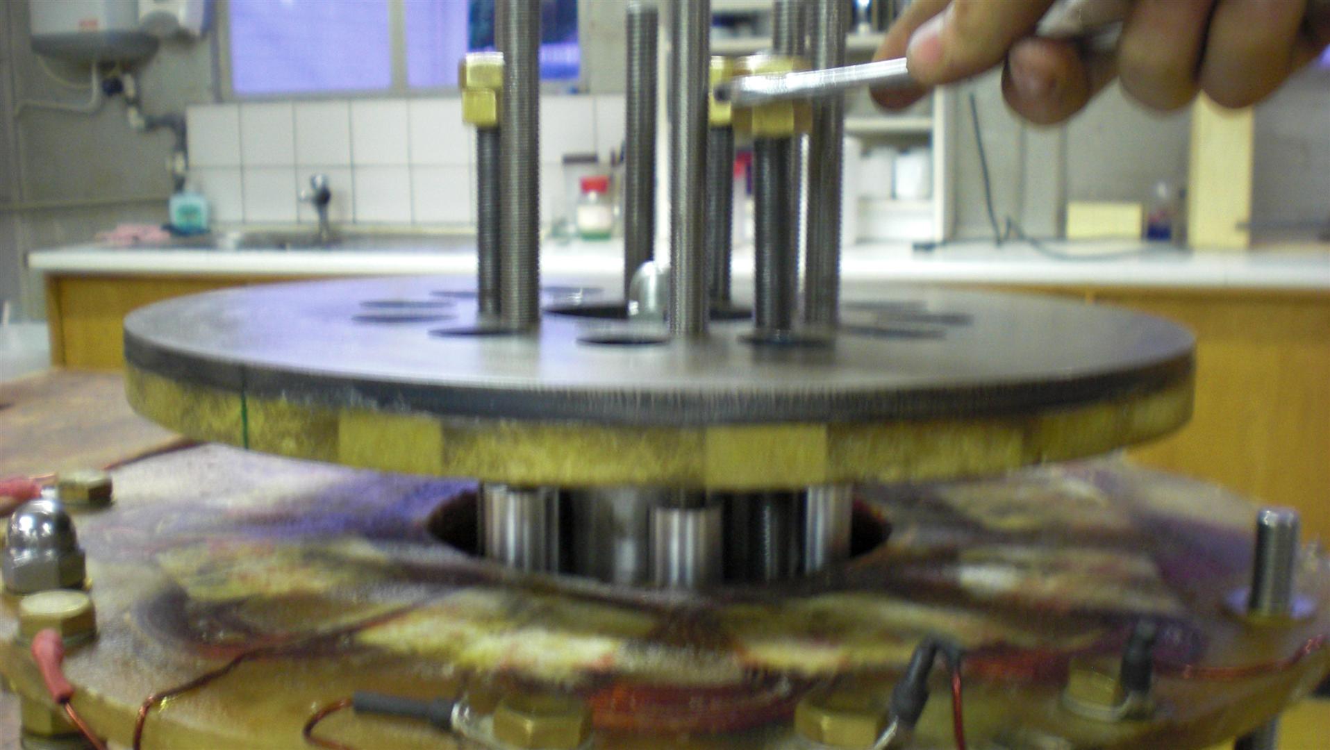

    The good thing with making the generator this way is:
    • It's coreless, so no cogging = low cut-in speed. Energy density/efficiency is worse, but you make up for it with big strong magnets.
    • Since you're winding the coils you can get the right voltage without gearing (less maintenance and SIMPLE).

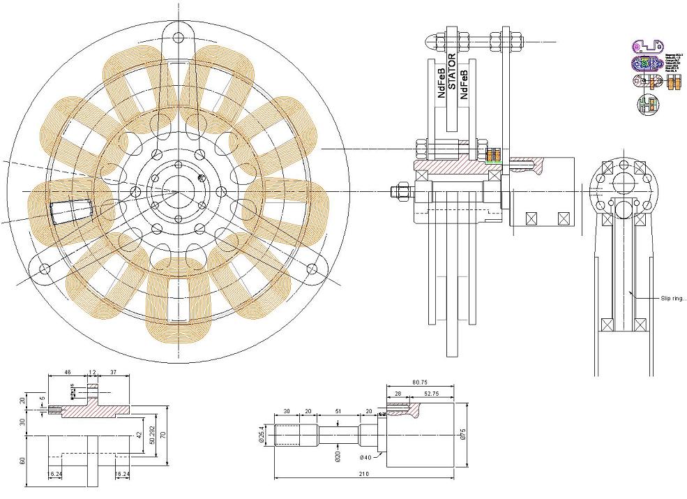

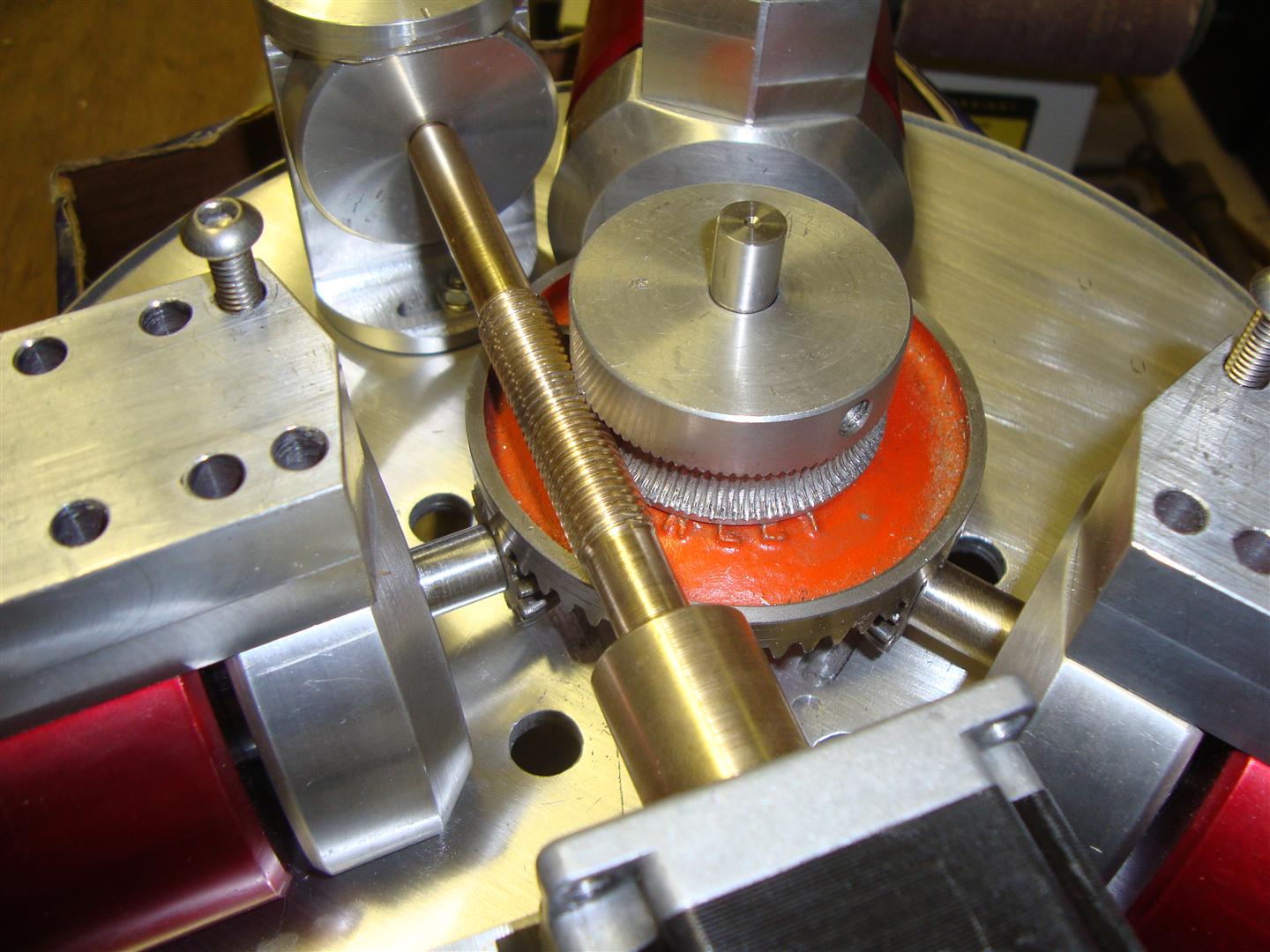

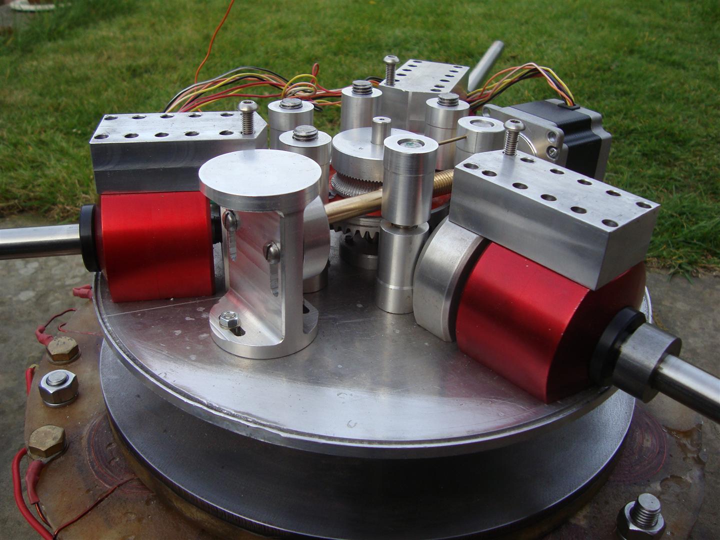

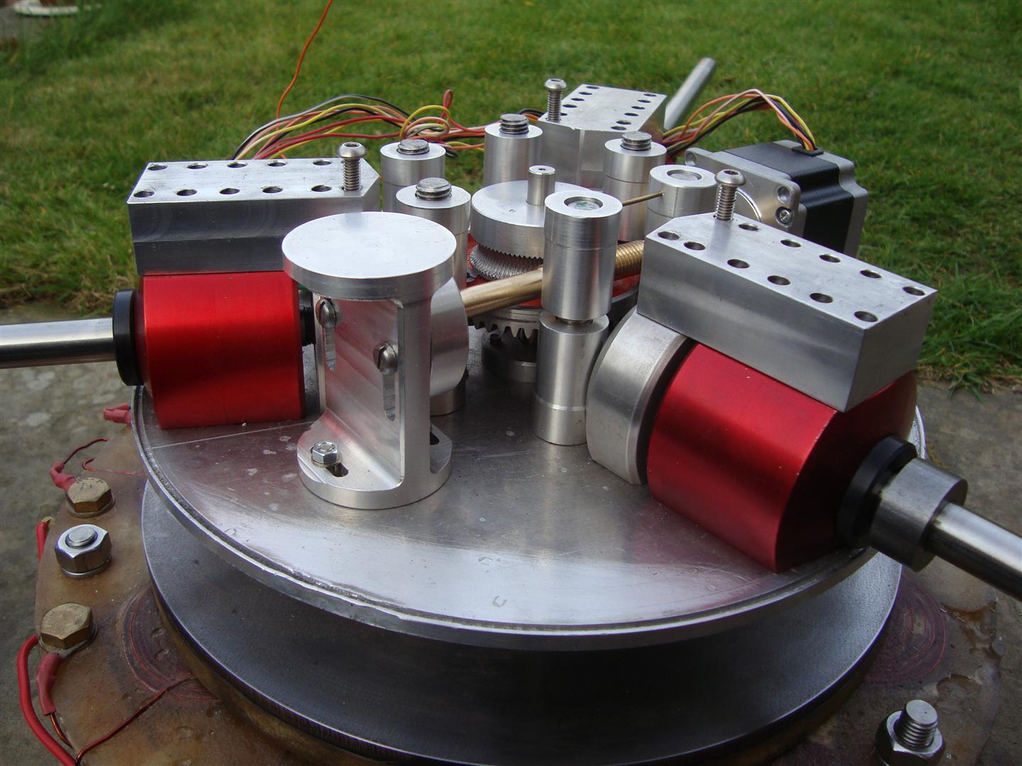

    My wind turbine does use a wind turbine, but not for the generator. It's to vary the pitch of the blades via a worm drive and bevel gears:

    As you can see mine (along with many others) uses a hub (like a trailer wheel hub, except I made one to fit better) and tapered roller bearings. That means the rotor is mounted on six M12 rods which is plenty strong enough.
    The reason I made my CNC router was to make the blades (3.1m diameter) for this wind turbine....which I've still not done as I keep changing my mind.

    Thanks.. it was my A-level project. I've not found another DIY turbine with active pitch control. I went much further than required for the A-level though. I've not done anything with it for over a year now :( ... I'm intending to test the generator with lathe on VFD as that'll be a more accurate setup than using the school Bridgeport to get readings. I machined all the parts manually... no CNC.

    For mine to 'kick' at lower RPM you just need to increase the number of turns on the coils since the voltage is proportional to the number of turns. Just make a test coil out of anything, spin the generator at known RPM. Then you get volts per turn per rpm ... decide what cut-in speed you want and just scale it to get the required number of turns. Then work out the biggest wire you can fit in the available space ... use multiple strands if it's too big to wind easily.
