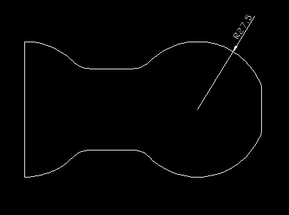

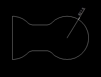

    I am machining a profile on a FANUC 10TF (Lathe), the profile starts with a 55mm dia ball right from x0.0 z0.0.
    I'm using a Seco MDT profile tool with a R1.5 tip and a tool shape No.8 in the geom page.
    It machines the part mostly OK, however it starts the ball with a flat on the front of about 18mm DIA, then the radius of the ball starts?
    I have attached some pictures.
    1st picture is what I want, the 2nd picture is what I'm getting.
    Prog below - can anyone see a problem?
    Many thanks

  2. hi,
    the program look ok.
    I am also amazed why the wrong shape is generated.
