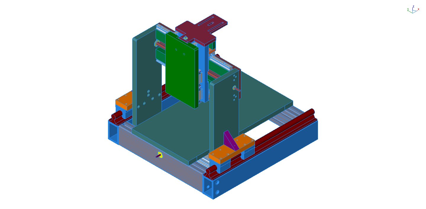

  5. Well folks,
    work and payment recieved have come together to allow me to get the pieces together to buil the model I have below. Support round rails ordered (Thanks Jonathan for challenging my idea and sorry JAZZ for not contacting you first). The rails and 2 of the carriages will be coming from Jonathan. The other 4 carriages and two rails for Y axis JAZZ has helped with me getting. DumpsterCNC anti-backlash nuts ordered and in route via post. Just need to get a hold of JAZZ on cutting and where to have the metal sent to. Also need to get a hold of m_c for the modification on the pieces that are here.
    JAZZ or Jonathan (Heck anyone with more experience then me) please speak up on anything you might see wrong with the design. NO, not all bolt holes have been put into the model yet. Yo uwould be surpirsed how much time doingthat and making sure that there is no conflicts and enough Metal to grab. No the motor mounts are not all present and the gear i put in the top of Z keeps vanishing.
Name:	Gantry for Wee Beastiev5d.jpg
    Thanks for all the advice and will get pic's up when all the pieces go together.
    Michael
  6. #66
    It's just occurred to me that your gantry has very poor torsional stiffness. Normally that's not a problem as with two ballscrews it can't twist, however with only one nut in the middle when the cutter is near either edge of the bed the gantry can twist causing deflection. Given the tolerances you require that could cause problems. You're essentially only relying on the joint between the gantry back plate as sides, so I'd be inclined to reinforce that. The rail mount blocks will help...also don't remember what joining the bottom of the gantry sides, that will make a difference.
  7. Well,
    Thanks to a Large amount of help from JAZZ the stress and pressure have been relieved greatly. Now finishing up a redesign that I have been working on with JAZZ and hope to start working on getting all the pieces to him for cutting soon. Additional good news is that linearmotionbearings on flea- bay has FF/FK support bearings for RM1605 ballscrews. Still going with the single central ballscrew and given the level of reinforcement going into it, I doubt racking will be a problem. right now looking at seeing if removing some of the internal metal (creating a web like effect) could be done to decrease weight while keeping stiffness up where it needs to be. Outside of that busy with work and another convention this weekend North of me (Luckily only going for one day as have too much to do to afford all three days of the event).
    Will post pictures once I have something worth looking at done (Have most the structure done just adding some finishing touches but want it right first).

  10. Okay,
    Update on the machine design and build. Design has been finalized with Jazz and materials are coming together. Rails from Luke and James have helped greatly in the moving forward portion. After working up all the different cost of items, the direction was given to go with twin X axis ballscrews as that was actually cheaper with the resources we have to get the parts. Plate has been ordered and paid for; as have the ballscrews which should be shipping here shortly. I will post a JPG later of the finalized design and should have a full model with bolt holes and everything for folks who find it an interesting design.
    Now comes the prepping the space in the shed for it foot print of 677mm by 1200 not including the X axis stepper motors which I need to buy one more of those to have a full set. I will be currently using the System 4 set up I have from DIYCNC but will be moving to a higher voltage set up once funds allow.
    Cutting area is looking to be 850mm (X) by 355mm(Y) by 150 to 175(Z) Depending on bed height. Bed at first will be MDF two piece configuration (Thanks for the idea Jazz) and I might change over to HDPE or Acrylic (as currently the price of a piece of Ali' that big is scary let alone getting the slots milled into it).
