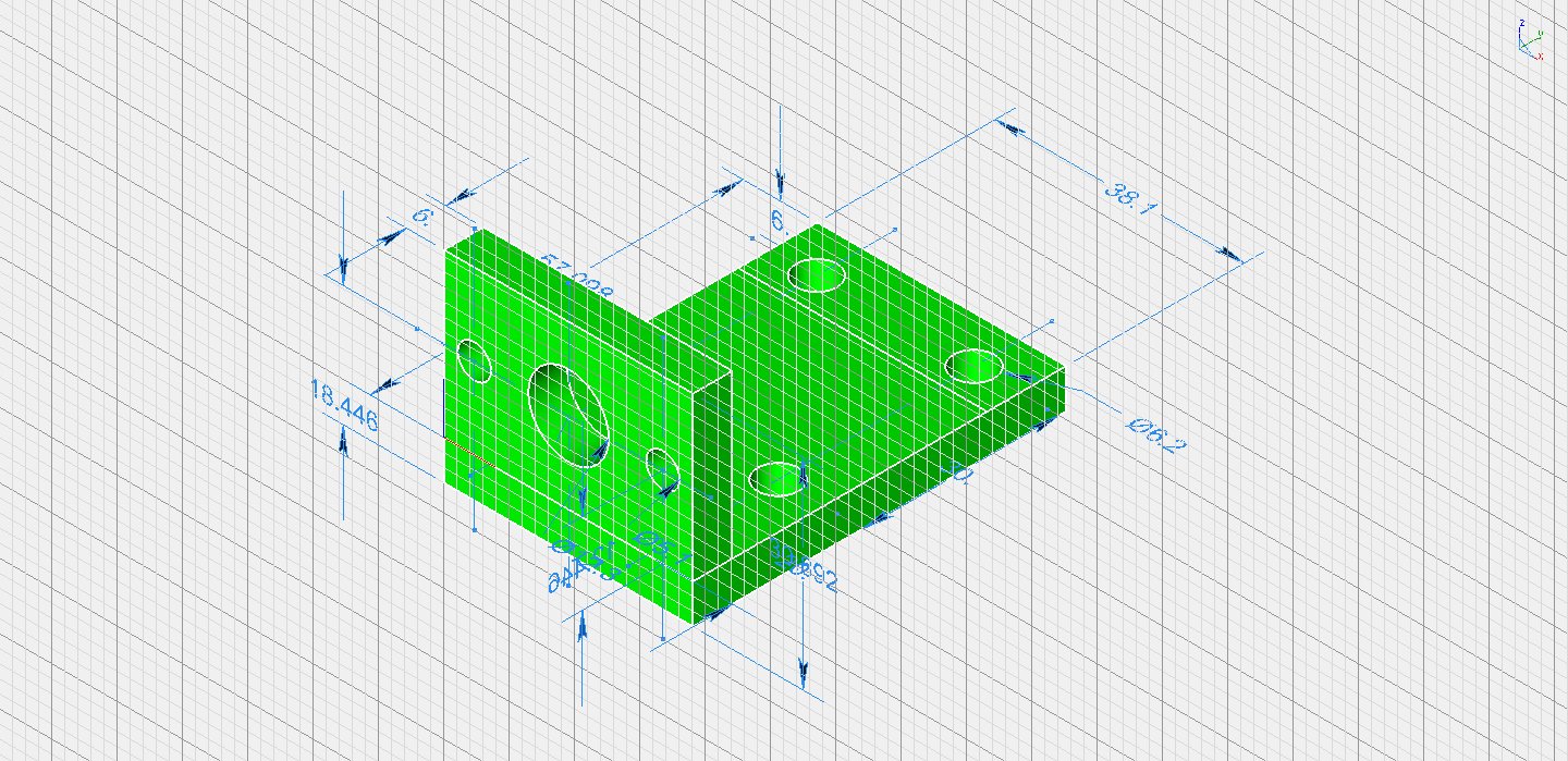

    If I've worked it out right, all that's needed is a bit angle, with four holes on one side for bolting to the cross brace, then on the other side a big hole (21.5mm) for the anti-backlash nut to pass through, with another two holes for bolting the nut on via the flange (having looked at the dumpsterCNC site, I'm guessing you're for the 25mm cut-down flange option?).
    Something suitable could be made with a pillar drill, a couple drill bits, and a hole saw.
    Regarding mounting the nut, I'd use a couple nyloc nuts with plain washers to spread the load. I'd also put the bolts through from the alloy side, tighten them into the flange, then use the nylocs to make sure the bolts can't move.

    Sorry that they are jpeg's as it would not let me load the .dwg or .iges file format. That is the bracket I designed to go with a dumpsterCNC anti backlash nut for a 12mm trapezoid leadscrew. Clearance is only 40mm in height. Any opinions???
    Also Checking on available box Aluminium in the area but is looking like I have a really good source of off cuts (some over 2 metres) of 12mm Aluminium plate. Any and all views would be greatly appreciated.
    Michael
  4. #14
    How are you joining the two pieces together? That joint needs to be strong so that an axial force on the screw does not bend the bracket. I'd be inclined to either make it out of one piece, or use something thicker for the vertical part.

    Looks fine. If you can't find a bit suitable angle, it could be roughed from a bit solid alu with minimal effort.
    Or if you could survive with steel, I might even have a bit suitable angle lying around (I think I came across some 2 or 3" angle during a search for something else the other week!).

  6. The idea was for it to be of a single piece of either angle or mill from block. That should insure the rigidity of the piece. As far as the Aluminium is concerned drop me a line folks and will try to arrange something. I need to be going down there any how to see if they have any square tube stock that could be drilled and bolt together for the new frame.

  7. What took so long and what is taking time. Is a drawing I am working on to improve my skill working with the new program. I really like ViaCAD 2D/3Dv8 for CAD work over the program I was using. To give you an idea of what I was doing here is a Jpeg of the Nut.Click image for larger version.
