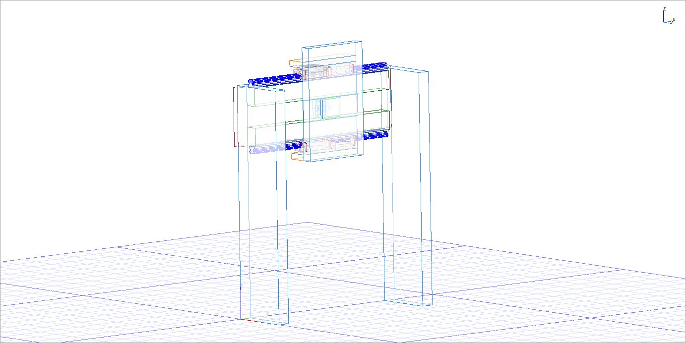

  5. Okay Mark and Jazz,
    Here is an idea for the rails on the Y axis
Name:	Y axis idea.jpg
    The leadscrew will run down the channel between the two rail supports and the back plate will be bolted to it and the the uprights. At that point I think I will be able to move the spindle closer to centre that way.
    I am going to get some sleep and get on this tomorrow. Thanks for all the input folks and will work on things to the best possible.
    Michael
  6. Okay,
    Further drawing, as promised. With additional information.
    Uprights of gantry are currently looking to be either 20 to 25mm (or 3/4 to1") thick. The rails are bolted down to 25 x 38mm bars that are going to be bolted to the back plate (12mm). The Z base plate is 20 (or 3/4") . I hope the way I had the jpeg done allows folks to see more of what is going on without getting a headache. This is a rough sketch done with ViaCAD 2D/3D and no I don't own any part of the company nor have vested interest in it.
Name:	Y axis idea N2.jpg
    Any and all opinions are please.
    Michael
  7. #46
    the preportion of flex along the Y axis looks like it will be huge compared to the X and Z
    if the aspect ratio on your gantry absolutly has to be that tall id be tempted to go for a fixed gantry (heavily made) with a moving bed
  8. I agree,
    But space is an issue. I am thinking of using an old bridge builders trick and bolts some strengthening rails to the outside to help add rigidity. overall hight is 475mm will have the distances shortly between it and the rails it will run on. still working on it. design gets to be nightmarish after awhile.
    Michael
  9. #48
    Lives in East Lothian, United Kingdom. Last Activity: 12 Hours Ago Forum Superstar, has done so much to help others, they deserve a medal. Has a total post count of 2,992. Received thanks 376 times, giving thanks to others 9 times.
    You could always build tall sides for the base, to reduce the distance between the x-axis supports and the y-axis.
    It would mean that when you're machining on the base, the cutter would effectively be working below the x-axis supports, but the higher rails should improve ridgidity.
  10. #49
    Yes, that combined with a bed which you can adjust the height of is by far the most rigid way to do it. As there are effectively no gantry sides you have eliminated the flex they cause. You can make the rest of the frame as heavy, and therefore strong, as you want as it is now stationary. I changed my router to that configuration and it has made a huge difference:
    http://www.mycncuk.com/forums/showth...ll=1#post22767
    It is interesting that you seem to have profile rails yet cannot afford ballscrews? Is that because you spend all your money on the rails!
