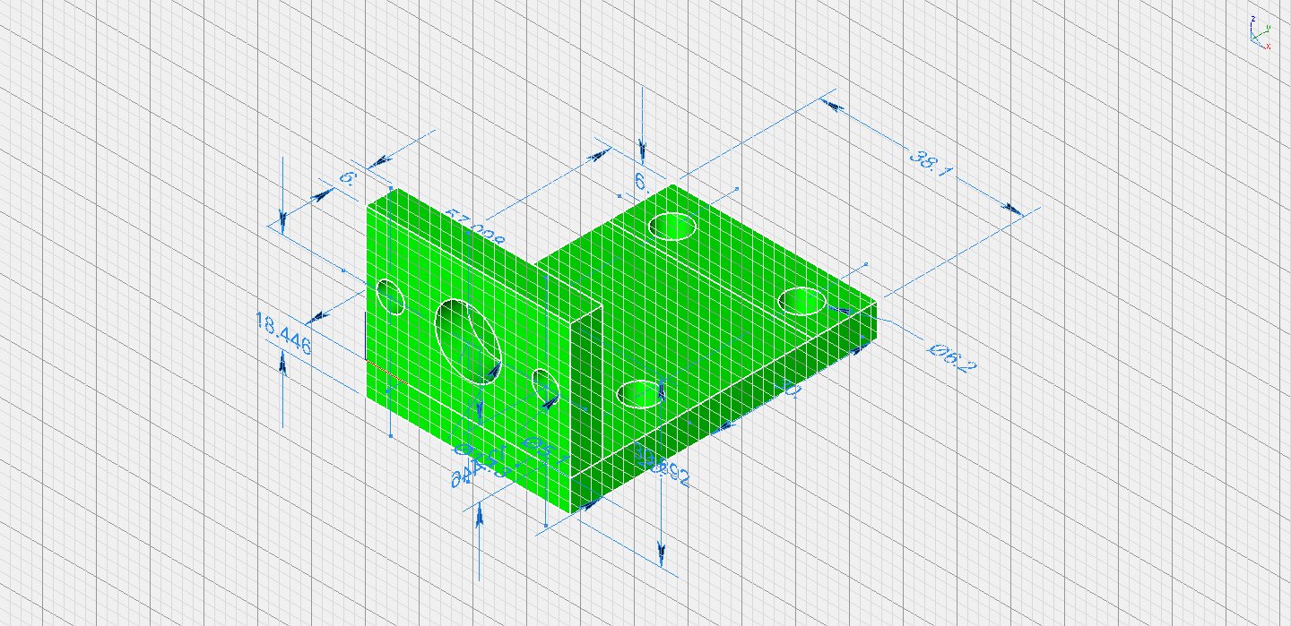

    How are you joining the two pieces together? That joint needs to be strong so that an axial force on the screw does not bend the bracket. I'd be inclined to either make it out of one piece, or use something thicker for the vertical part.
    Quote Originally Posted by m.marino View Post
    Also Checking on available box Aluminium in the area but is looking like I have a really good source of off cuts (some over 2 metres) of 12mm Aluminium plate. Any and all views would be greatly appreciated.
    Excellent, can I have some ?

    Looks fine. If you can't find a bit suitable angle, it could be roughed from a bit solid alu with minimal effort.
    Or if you could survive with steel, I might even have a bit suitable angle lying around (I think I came across some 2 or 3" angle during a search for something else the other week!).
    I'm nearer and can collect :naughty:
  3. What took so long and what is taking time. Is a drawing I am working on to improve my skill working with the new program. I really like ViaCAD 2D/3Dv8 for CAD work over the program I was using. To give you an idea of what I was doing here is a Jpeg of the Nut.Click image for larger version.
