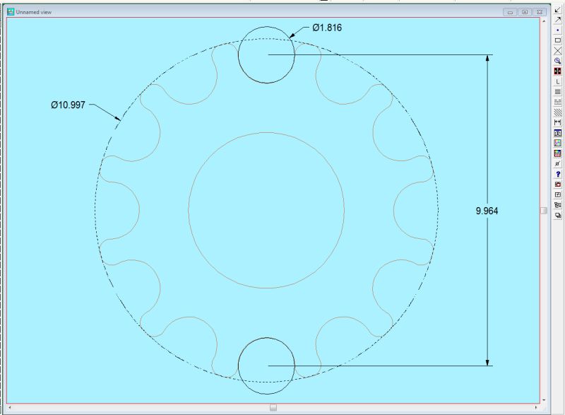

    The first job i need to do is to cut 12 tooth 3m htd pulley from steel bar so I'm thinking about holding a stock in a chuck. Another issue is to produce a cutter to cut 3m hdt profile. I searched internet but it looks like the only option is to make cutter myself
    Quote Originally Posted by wiatroda View Post
    That's what I did for XL pulleys ... but then that's only a trapezium.
    Small ball nose cutter and several passes to get the right profile? Would take ages but if it's a one off why not?

    What about to drill 12 holes 1.8 mm dia then turn it to proper outside size???? Eventually tweak corners a bit

    That looks like the profile for the belt, not the pulley. There's generally a small difference.
    I've seen pictures of it done by drilling, so I suppose it's worth a try. I can't think of any reason for the holes not to be accurate. I would use 1.9mm as you'll be a bit stuck if the cut-outs are too small and it does not fit.
    You might be able to 'tweak' the corners well enough with a chamfer. Maybe put it in a lathe and spin whilst holding a piece of wet and dry to it.
  8. #18
    Drill 12 holes 1.8mm dia on a 9.96 PCD.
    Then turn the OD back down to 11mm and give it a stiff wire brush up.

  9. I think I'll go for self center chuck and eventually in a future for independent jaws.
    Thanks Jon for calculations to do pulley this way will save me hassle with producing a cutter. What's the program by the way????
  10. #20
    Pulley generated in Gearotic,
    www.gearotic.com
    Then saved as 2D DXF, brought into CAD and the two circles added and dimensioned.
    John S -
