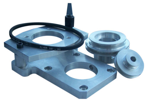

    Hi guys just had my gearbox go my mill got no hi / low was working then made some
    funny sounds then it stoped thought it would be the nylon gear on top but no thats in mint condition lol
    going to strip it down tomorrow to see whats going on it a Xj9512 mill china thing i think lol
    basicley a variants of the X2
    looking for a belt drive convertion at a cheep cheep price broke lol
    would make it my self but dont have a lathe to make pulleys
    Found RGDTools cheap for pullys....

    The pulleys have to be specific sizes and bores to fit the machine, stock pulleys won't fit and the guy doesn't have a lathe............................................. .......
    John S -
    There are different bore sizes on almost all the pullys in RGD site ie same size pully but with different bores.
    Oh wow,just had a look at that X2mill parts list and they're using the same head stock as used on the C2and C3 MiniLathe. lol
    Yup same lathe you have.
    Right he needs two 2 step pulleys one bored 9mm and one bored 1.180" and keywayed, remember, no lathe............
    John S -
    Don't one of the pullys fit on the spindle?
    Spindle size here......
    http://www.littlemachineshop.com/pro...7SpindleR8.pdf
    http://www.littlemachineshop.com/pro...Spindle3MT.pdf
    Yes 1.180" x 25.4 is equal to 30mm, the original kit was designed in the states hence the imperial measurement.
    Here's a picture of the main pulley, so you'll see it's not an off the shelf item.
