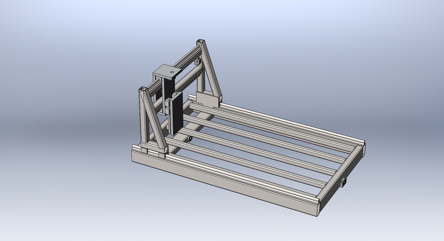

    Here are some pics of what I have come up with so far.

    X Rails are 1500mm 20dia supported. Y is 800mm 16dia supported. Z is 300mm 16dia supported.

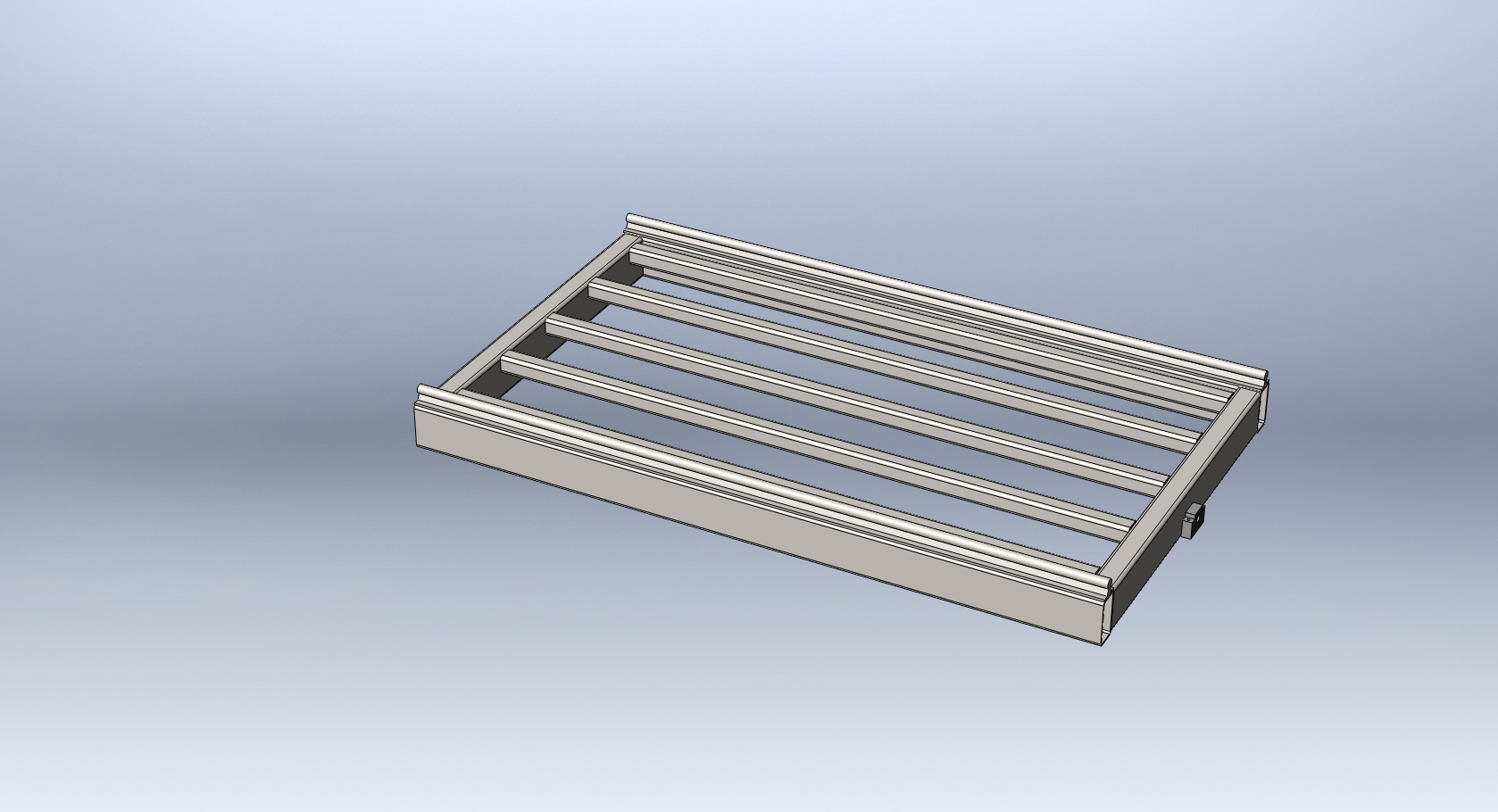

    Outer section is 100x50 Steel Box. Bed supports are 40x40. 20mm x 5mm pitch ballscrew will be in the center of the frame.

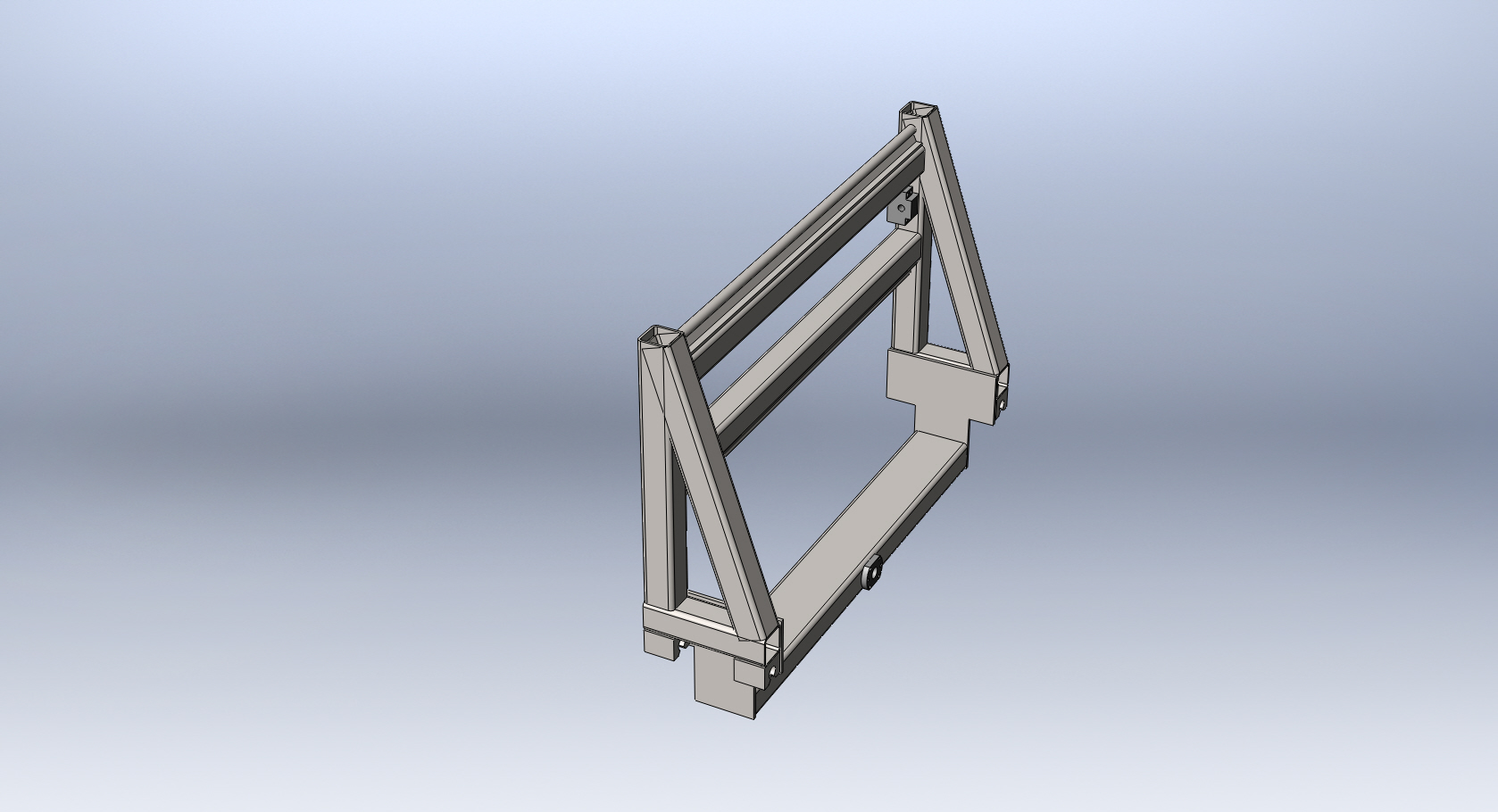

    Gantry is 50x50 Steel box. The strut at the bottom with the ballnut is some more of the 100x50. 16mm x 5mm pitch Y Ballscrew will run between the 2 horizontal 50x50 Y Rail supports.

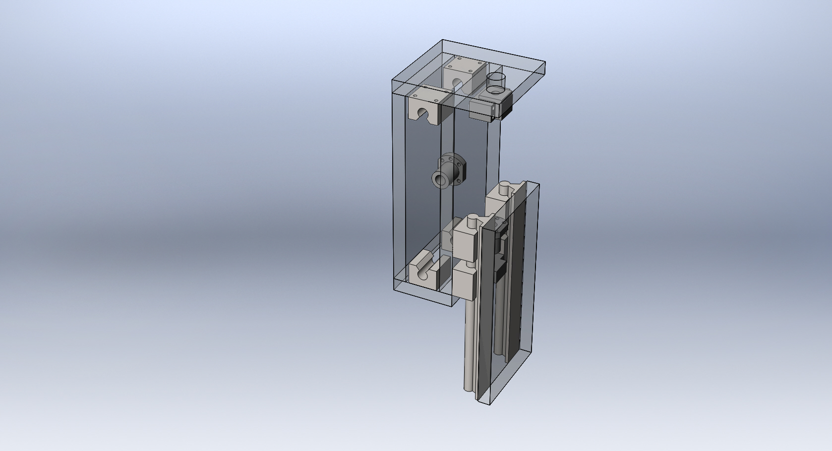

    Z Assembly is 300 x 150 x 20mm Ali plate with a 16mm x 5mm pitch Z Ballscrew. Approx 190mm Z travel.
    I would really appreciate some feedback from you guys, nothing has been ordered yet so its not to late to change anything if it looks like I have missed anything out.
    There are a few constraints that I would like to stick to:
    I will be re using my existing electronics and spindle to keep the costs down. Kress 1050 spindle and 3NM NEMA23 Steppers.
    I want the cutting area to be 2' x 4' so I can buy a 8' x 4' sheet and get them to get it cut into 4 at the store and drop it straight on the machine.
    I may do some bits of Ail work on it, but the main use will be for acrylic and wood.
    I do have a few things that I am unsure of:
    I am not sure if my steppers will be up to the task of moving the heavy gantry around, I would really like to be able to take some pretty fast and aggresive cuts on wood and acrylic, I'm thinking quick direction changes in the X direction might be a problem?
    Will I have problems with the X and Y leadscrews whiping?
    Anyway I look forward to hearing some feedback.

    Your Z axis linear bearing blocks look too close together for that travel.

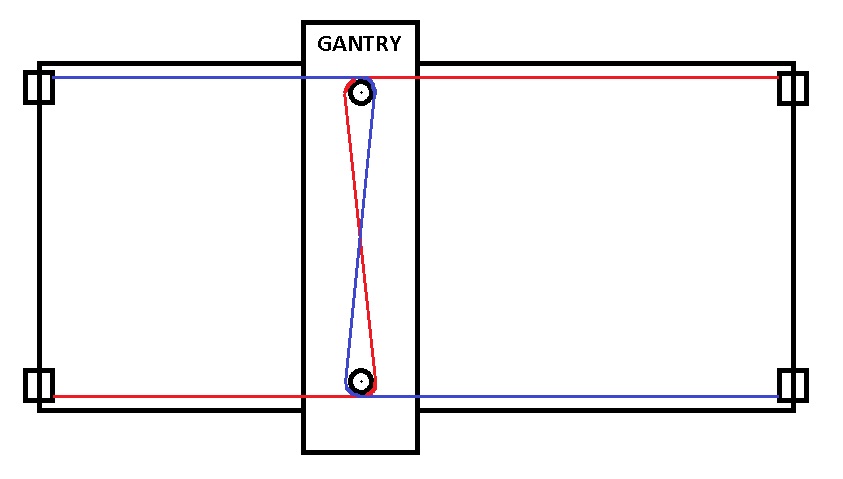

    If you don't want go spend a lot on another stepper/driver (fair enough) then why not link the two ballscrews with a pulley on each and a timing belt. Ideally 3 or 4 pulleys with the motor in between so that belt stretch is even... easer than the cable method I think.

    For those who have not seen it before here is the pully system I was talking about.

    I reckon the pulley diagram you posted wouldn't work very well because the acute angle between the crossing wires is very small. Too tired to calculate it properly now, but I'm pretty sure you'd want the same sort of thing but with one pulley on each corner of the frame, like on a drawing board ruler...

    I dont think you would have any problems with racking if you have a single drive on the x axis. Your gantry is identical to mine and I get no problems even on aggressive cuts.

    Z Assembly is going to be changed a bit to reduce flex, I will be increasing the distance between the bearings and extending the front plate holding the router. The stepper and ball screw will also be mounted there (I will post up a new drawing soon).
