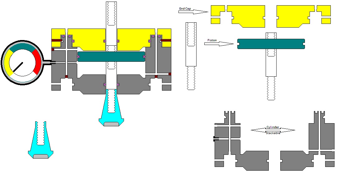

    This will be the first major project but as you can see it is only a concept drawing at the moment.:idea:

    What is the part you've drawn for? It looks simple enough to do an a manual lathe...
    It is a simple air ram for my ATC but the main body needs to be repeatable to a resonable level of accuracy. Its a Stacking design
    the more pressure you require the more cylinders and pistons you bolt on..
    I see, that explains a lot.
    Clearly it depends how many you need to make - there's no reason for it not to be precise on a manual lathe...just obviously takes a bit longer.

    I think i could make 1 no problems but a few of my friends have seen my ATC plans and they all want one so i just dont have the time to stand there pushing them out..
    Thats Given me an idea....
    Ok is there a way of recording me making the first piece and then switching it over to auto repeat.

    Second screen on Mach, the MDI screen.
    Press Teach then do all your commands using the MDI input, when finished press Stop Teach.
    Then go to C:\Mach3\Gcode and there will be a file called Teach.tap Rename this file to waht you want as next time you use teach it will over write it, it always calls the file teach.tap.
    That's it but you may have to do a couple of tries to get used to Teach, remember that it remembers accurately what you are doing, if you forget to start the spindle on the first try it will not start the spindle when you run the file !

    If you're going to do it with the MDI screen you might as well just write the Gcode in notepad to start with. I think that's a safer option as you'll notice on the toolpath display if it's going to hit the chuck or something...
    It's all straight lines so should be straightforward. Advantage of doing it yourself is you can do the most efficient toolpath.

    About the only decent lathe program I have seen is Dolphin.
    Many software writers treat lathe as a two axis mill when in fact it isn't, believe it or not lathe is far harder.
    On a mill the cutting tip of a cutter is on the corner and can be mapped very accurately. On a lathe the cutting edge is inside the theoretical corner to take into account the tool nose radius and as you work round a radius on the work this point is constantly changing.
    On most jobs that are just 'shapes' this doesn't matter but a good software must take this into account, most don't.
