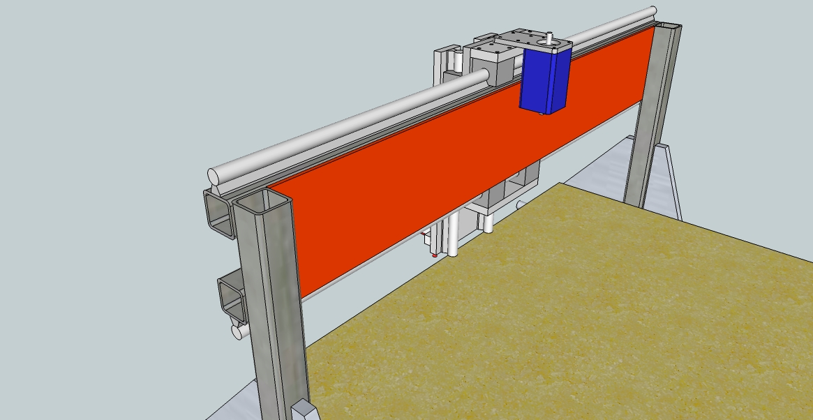

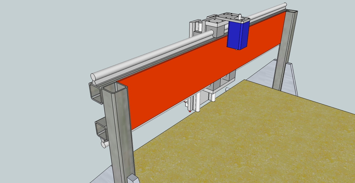

    Ok ive just done enough tinkering to give you an idea, of where bracing could do with looking at.
    It may also be an idea to widen up underneath the table on the gantry just enough to stop the diagonal flex when the spindle is working at the far reaches of the gantry axis.
    All the best Rick

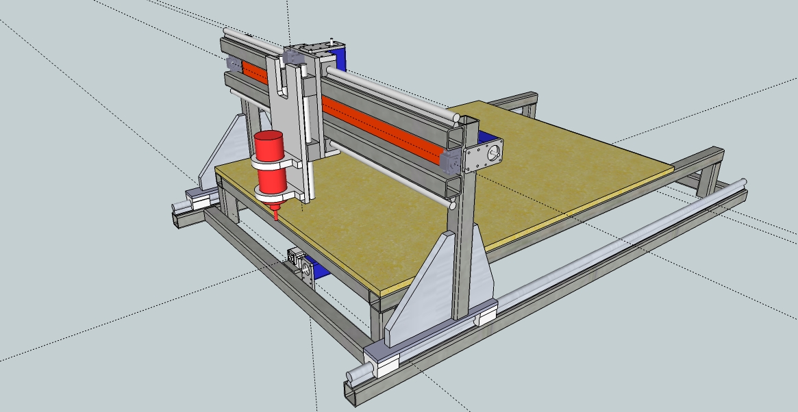

    If I was to mount a plate (as shown in pic) to the back of the axis with many fixings would that stiffen up the gantry sufficiently?

    The current design supported round rail, but this was down to cost and if available I would use profiled rail.
    I also think the 25mm ballscrew is OTT but now that it has been mentioned I'll look at 20mm with 5mm pitch with pulleys and belts. I am concerned about whip in the 16mm screws, but again it could be a saving.
    I am hoping to use a single ballscrew on each axis but if I find problems I think it would be easy enough to add an additional one, so I'll look out for a 4 motor and driver package.
    Never thought about resonance, but kiln dry'd sand could be a good solution.
    Thanks for all your input and please feel free to continue.
    Jim
    I can see this becoming a bit of a monster and it has to fit in my garage with all my junk.

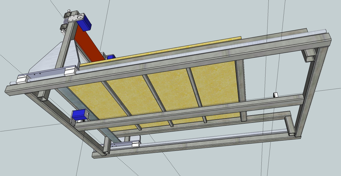

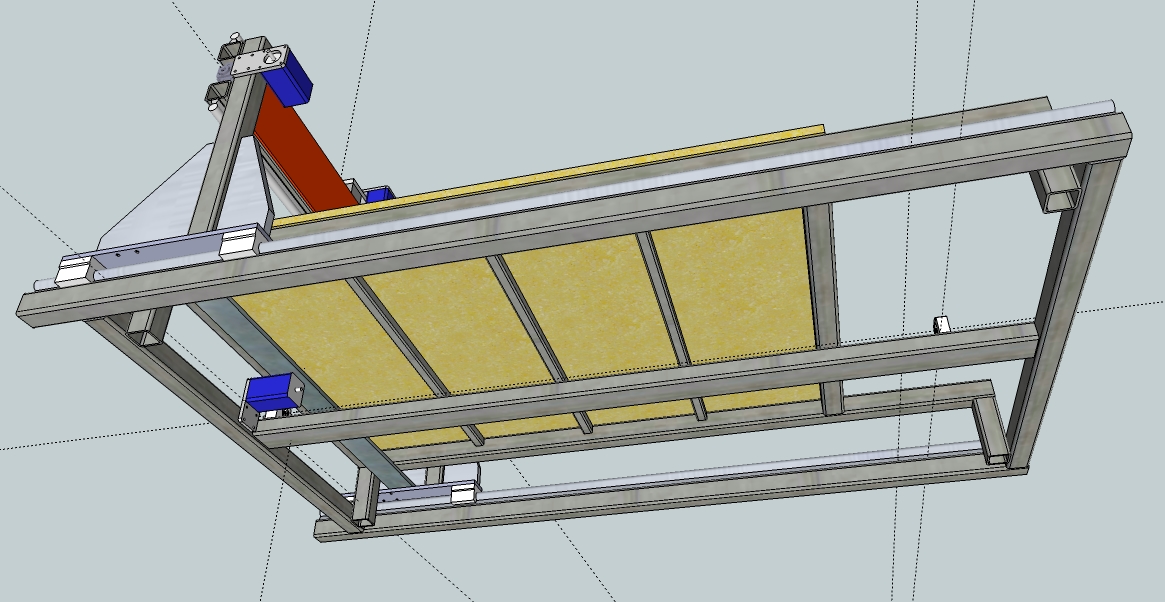

    Just a couple of more sketchs showing potential positions for ball screws and motors.
Name:	Frame & Gantry2.jpg
Name:	Frame & Gantry3.jpg
    Keep the comments comming as I will be buying materials soon.
    Jim

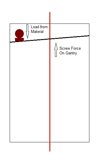

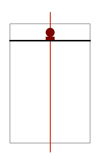

    Ok let me show some diagrams..
    With no load and Spindle central this is the look of the machine from above.
    Now cutting brings in to play these forces and consequences.
    As the others have touched on instead of using 1 screw in the center if you use 1 on each side that will sort it out but at the end of the day it is all down to cost and accuracy. if you take the above examples and apply them to the other two axis you will see the weaknesses in your structure at the time of design not when you have spent the money, most of us on here have been through the building process and made the mistakes for you...:whistling:

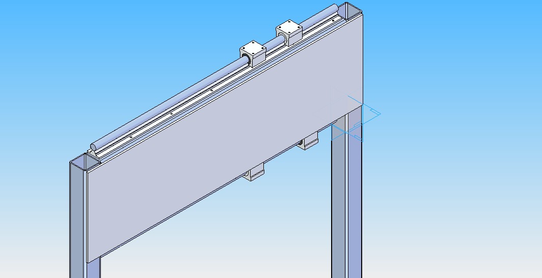

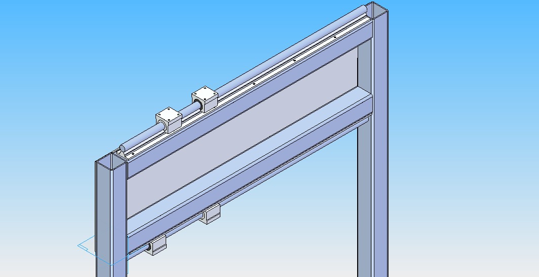

    The plate on the gantry to stiffen it is an excellent plan. I think you need to consider more how you are joining the box section, and gantry sides to bearings. Currently you have drawn the box section attached on just one face which is a bit weak.
    I have done a drawing for you to illustrate how I think it can be made stronger:
Name:	Mycncuk stiffened gantry 1.jpg
Name:	Mycncuk stiffened gantry 2.jpg
    That way the sheet reinforces the joints in addition to the general structure. I would be inclined to weld it for good measure. If not put plates (say 20mm thick) in the ends of the box section and bolt into them.

    Jonathans suggestion is a good one not just for strength but also it protects the ballscrew from flying debrie.
    If you must go with 1 screw done the middle then I suggest you make the cross piece that the ballnut fastens to wide as possible. you need strong bracing and width to counteract racking with a single screw.
    Something like the pics below will handle just about most jobs at this width with a single screw. A 16mm 10mm pitch would work nicely.
    Edit: The sketchs are rough quick knock up's and I would add some more corner braces to the cross piece but it should give you an idea of what I mean.
    It probably looks a bit extreme but honestly it's not and the extra work and slightly more expense would be worth every minute and penny spent belive me.
    Dont under estimate the forces's even with steppers.!! . . The forces can be extreme when cutting Ali and hard materials and the torque produced by steppers and ballscrews can twist and mangle a gantry built like this in the blink of an eye when the stick stuff it's the fan. :surprised:

    Thank you all for your very good comments.
    Rick - I will redesign the frame and go with 2 ball screws as suggested, possibly 16mm 10pitch.
    Jonathan – In my initial sketches the axis was constructed in a similar manor to your drawings but I found the spindle did not cover the whole of the table. So I either extended the frame of the base or took the rails to the extreme of the axis allowing the spindle to go past the work surface while keeping the foot print of the machine as small as possible. But as you have pointed out it has created a weakness and I will take this on board.
    JAZZCNC – I also agree Jonathans suggestion is a good one, but as for the protection of the ball screw I was hoping to use brush seals fixed to the gantry to prevent wood chips causing damage. I’m sure I’ve seen this being used on a machine on this site.
    I also like your design for the gantry, so I’m back off to the drawing board. I’ll keep you posted.
    What are your thoughts on these Chinese screws as I don’t want to work to microns?
    As you are all well aware of, everything is a compromise.
    Jim
