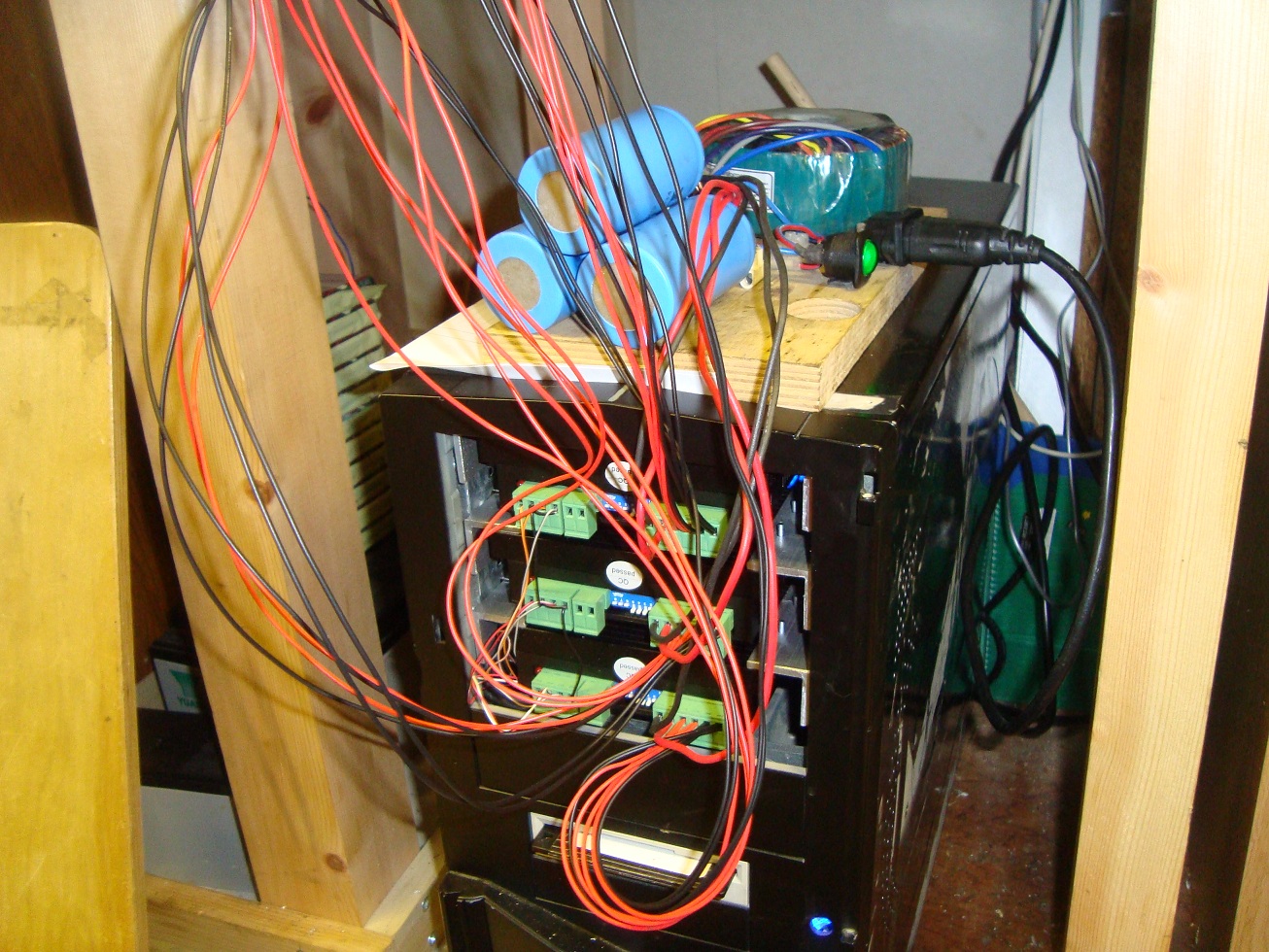

    I mounted my stepper drivers in the computer case CD drive bays so it's nice and compact. If you didn't have the computer in there you could get the transformer in too, and good cooling as long as you make sure the fans don't suck in all the dust.
    Old photo, before I used the right wire, but you get the idea:
    Not saying that's the best way to do it... but it's convenient and cheap. They're mounted on 1" aluminium angle.
