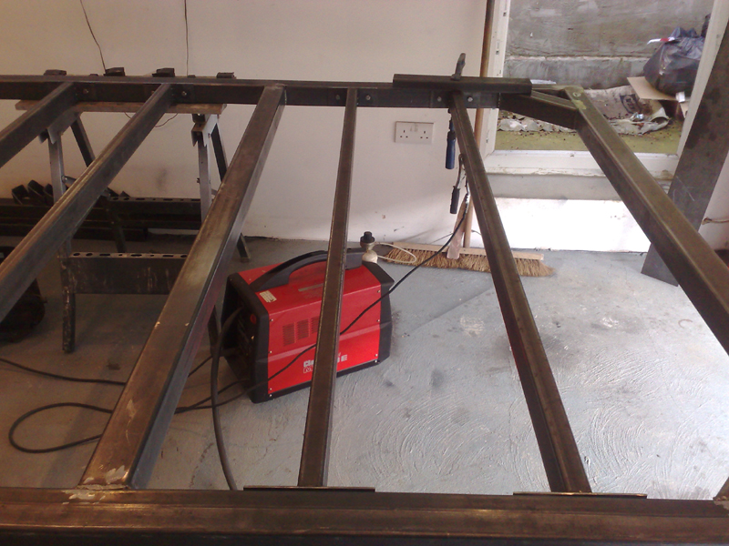

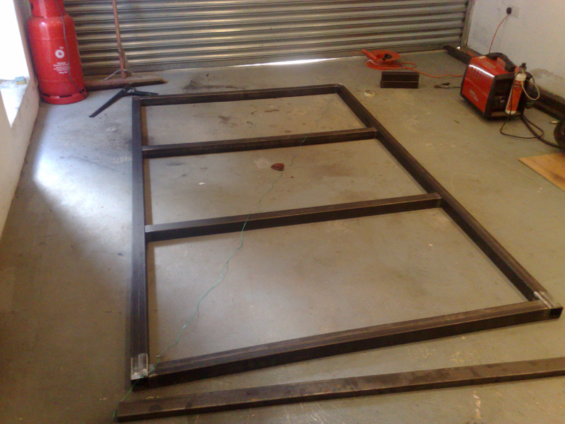

  3. #43

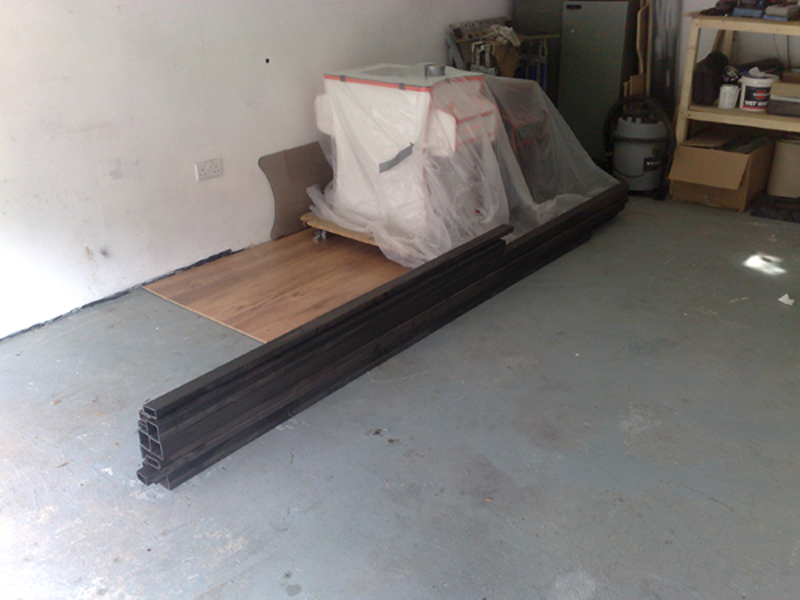

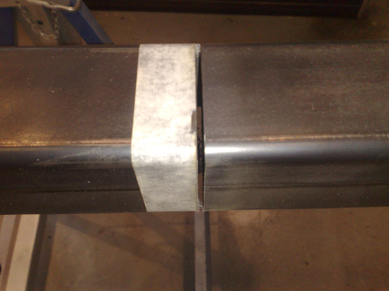

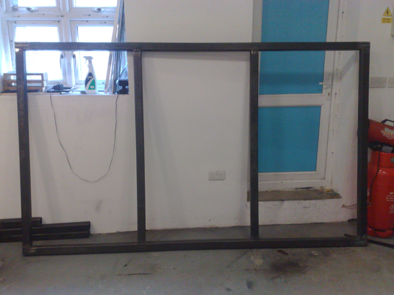

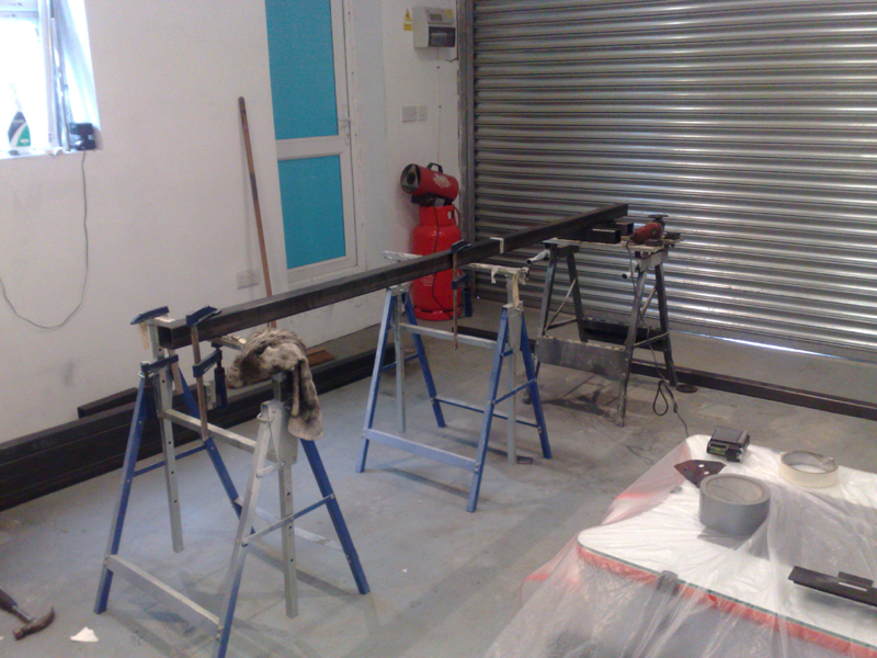

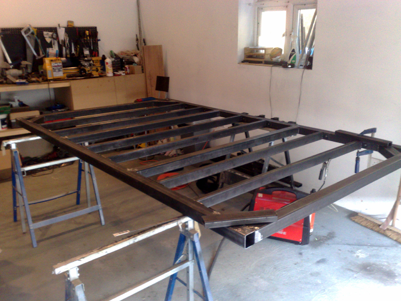

    Little update....
    Got all the outer sections cut yesterday and welded together today, now I need to get some flat 3mm sheet for the plates to make all the removable braces.
    I was a little worried about getting the cuts perfect but you've gotta love plasma discs for perfect thins cuts
    The frame all measures the same from corner to corner and the gaps between each brace is spot on so I'm pretty chuffed nothing got messed up in the welding process, only thing I was a little concerned about was the weld penetration. There seemed to be quite a lot of weld laying on top even though the welder was set to maximum.
    However I moved it all around and nothings fallen of yet so it seems to be ok :rofl:
    @JAZZ - I've got 4 offcuts leftover with which I'll use to brace the four corners, when you suggested the removable braces should run the same way and said three per bay that would make 12 in total including the larger 60 x 60 pieces?

  4. #44
    Quote Originally Posted by trounce View Post
    Yep thats what's required IMO 3 piece's, thou it's not much more material than the way you had it in squares.
    Don't under build the bed for the sake of bit extra steel, If you must use less steel then at least drill the holes ready and add it later. (Thou before you start using it or never will get fitted.!)
    Looking good. . . keep the pics flowing and we'll turn a blind eye to any chicken shit runs we see. .:lol:

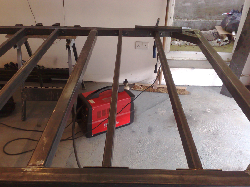

  5. #45

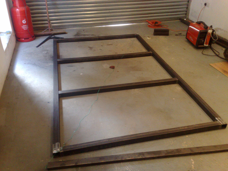

    Its been a while since I've managed to get any more work done on the bed but its now almost finished.
    It took me forever to cut all the damn brackets and then drill and tap all the holes but thankfully that tedious job is over and done with :tup:
    Just a bit of tidying up on a few of the welds that ended up looking pretty dire and then to give it all a nice coat of paint.
