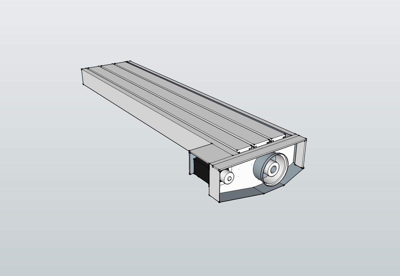

    Well here is an idea, im sure there will be people with experience of this sort of thing.
    just a basic concept and yes There are covers missing for clarity...
    This type of thing is what i was looking into and it all misses the y axis as well so no loss of x or y. excuse the drawing its my first google sketchup

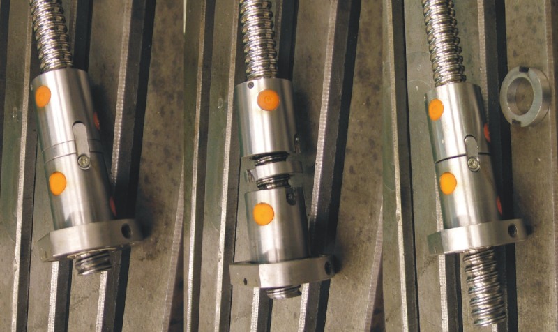

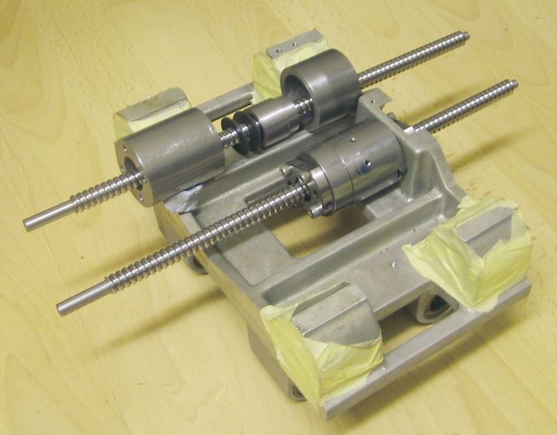

    .001mm is one micron. Standard ball nuts give you 50 microns, shimmed gives you 20, the only way to get 1 is to use double nuts and spring them. Helps if you can hold the screws in tension with more springs. The Belleville washer is your friend.
    By double nuts do you mean the "double ballnut" that somewhere like Zapp sells, or do you mean using two seperate nuts and combining them with the spring?
    I've seen the latter in different places around the internet, but I didn't know if the former was simply a commercial version of the latter.
  6. #26
    I'm pretty sure Robin will mean two nuts sprung, hence the Belleville washers. I think the commercial versions are just shimmed. To eliminate backlash you need them to be pushed apart using a spring applying a force greater than any cutting force plus acceleration, F=ma, you anticipate.
  7. #27
    [whisper]I think someone on this forum is considering it / has done it...[/whisper]
    I'm playing with the idea, primarily because I think it looks good, effectiveness be damned! :twisted:
    On a related note, I also asked similar questions about the under-table mounting, the consensus seemed to be that it wasn't a problem. The following thread might have useful things for you: http://www.mycncuk.com/forums/showth...or-under-table
  8. #28
    Quote Originally Posted by Rogue View Post
    Either, if you use a double take the shim out
