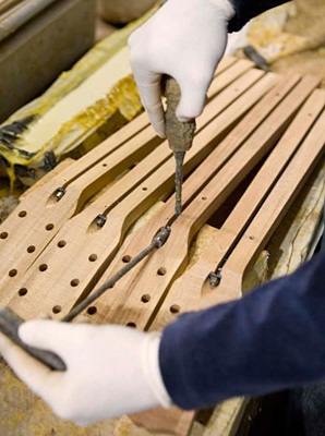

    Hi. so the picture below is what you would like to achieve but after the neck is constructed??
    I did always wonder how they did it...

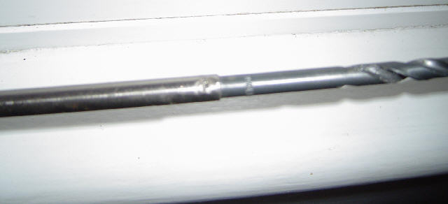

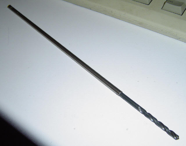

    Well it look like gun drilling is the answer...the problem is the bit holder, I'm not gonna get one of these down B "do you want decking" &Q...
    http://www.youtube.com/watch?v=SE9sTRFeCBg
