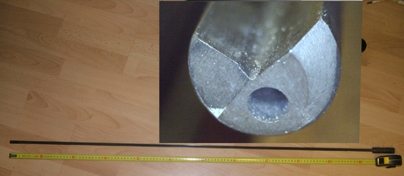

    I just took pics of a gun drill. They are a bit odd.

    As you say...odd (thanks for the pic)
    Re not being able to keep the workpiece static (& rotate the bit), this page suggests it's one of the methods....
    http://www.gundrillingsolutions.com/Pages/basicpr.html
    Bill, the method you outlined I'd considered...I have no sliding rail though, so would have to contempate making one...but then I saw the cost of a pair of support rails @1.2mm long - gulp.
  3. Bill, the method you outlined I'd considered...I have no sliding rail though, so would have to contempate making one...but then I saw the cost of a pair of support rails @1.2mm long - gulp.
    They don't have to be that strong, they just have to be straight.
