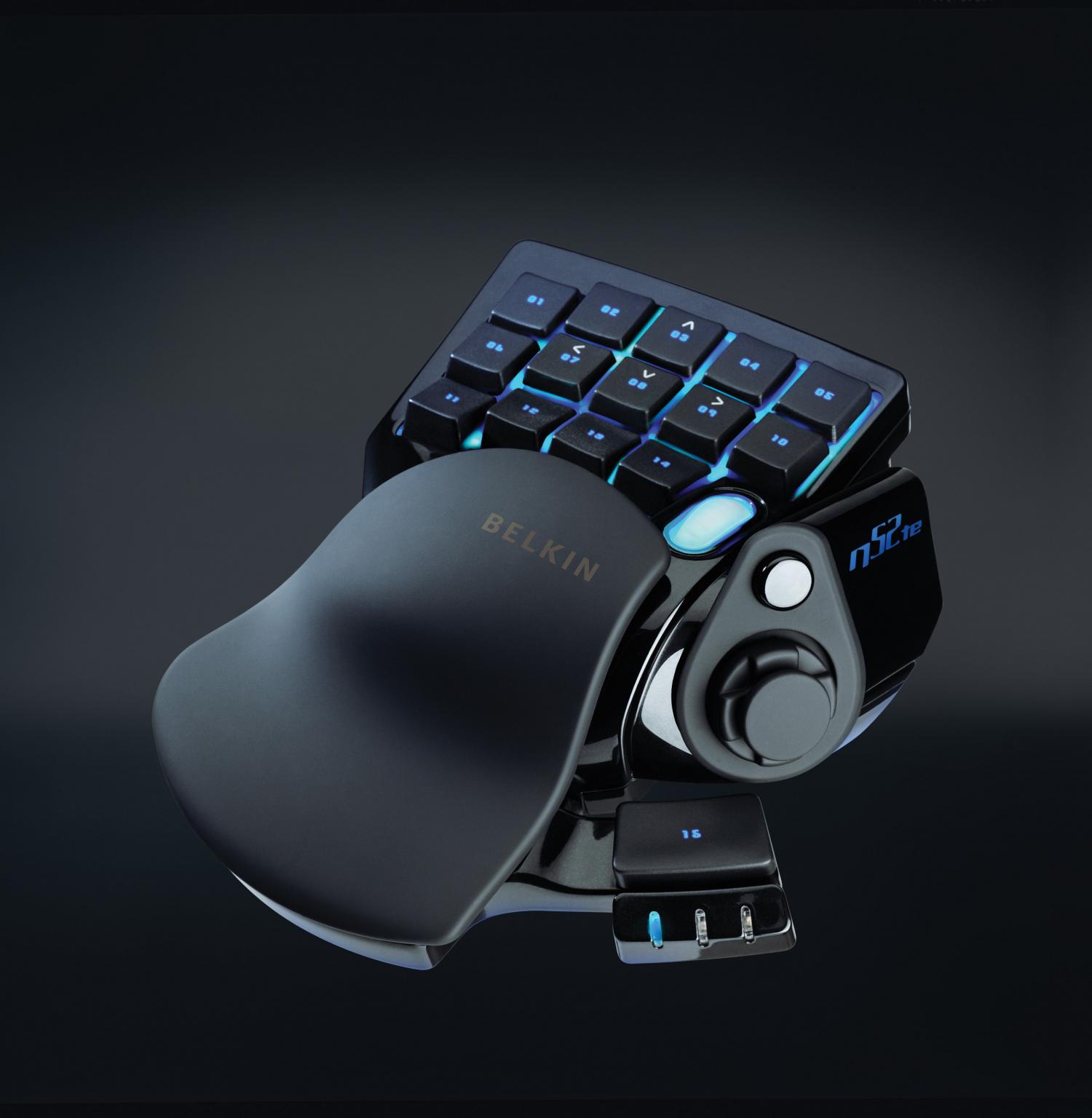

    Rummaging in a draw, I found an old combined 16 key and mouse controller called an N52te which might get do the job as a pendant...

    I have a Nostromo (N52) too and there is a thread somewhere on the net with a configuration tool to use it under EMC2.

    thanks, just found it. I'd done a quick search on Mach3 and n52 but found nothing. Looks like it might work?

    Let me have it and I'll getting working for you.!. . . Thou I may lose your return address if I like it. .:naughty:
    Post the link to the info or anything about the pendent and I'll have a look to see I figure making it work with Mach. . . It will probably just need a plug-in or script writing/altering.
    I would Put a post on the mach forum and pritty sure someone will know about it.

    lol, it's designed for left handed use...but it comes with some programming software which doesn't get in the way of game software.. just sends keypresses to the PC.. I'm assuming here that mach 3 has shortcut keys?
    here's some pics;
