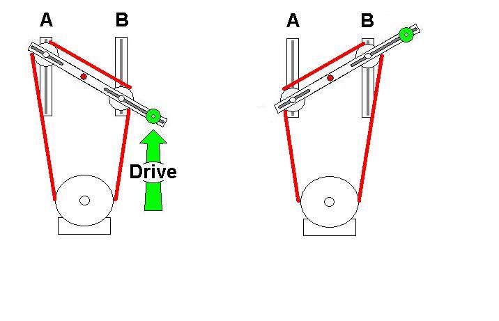

    Oooh, what if there was an idler that moved in such a way as to maintain the same tension on the belt as the spindle moved up and down? I've just given myself an idea there, assuming it's a viable option...
    Is the following system viable do you think?

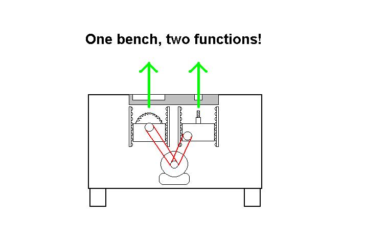

    The idea is for pulley B to be powering something like a circular saw than can be raised or lowered by moving the green bit, either through a lever or stepper-controlled screw, etc.
    The reason for this kind of setup is because that same motor could be used to power another tool located nearby - not at the same time, of course. The tool that is not in use could be retracted beneath the table and disconnected from the motor perhaps.

    Lots of machinery have pulleys that move in relation to the power source, but they rely on spring loading to ensure the belt remains tight.
    It all depends on what kind of power you need to transmit, and the type of belt you're using.
    Normal V-belts don't need much tension to grip, whereas as smaller multi-groove belts require a lot of tension to grip.
    Spring loading! Why didn't I think of that? Now I feel really stupid...

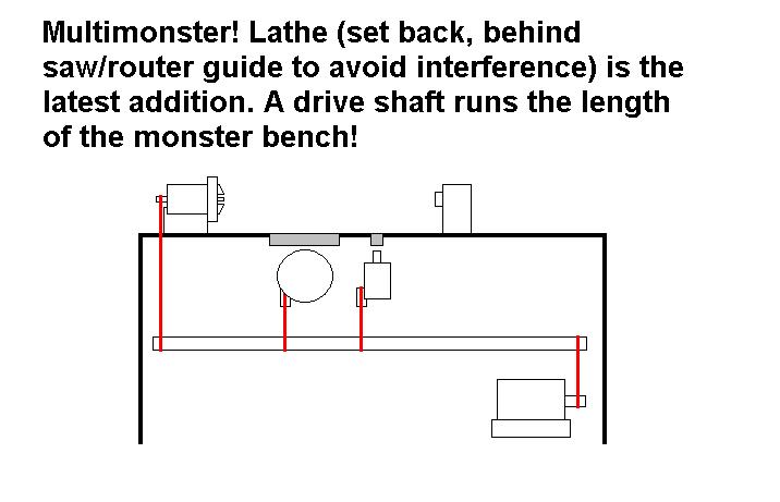

    Oh great. Now my mind just raced into overkill
    Edited to add: Inspired by the old line shaft system for belt driven machines...
