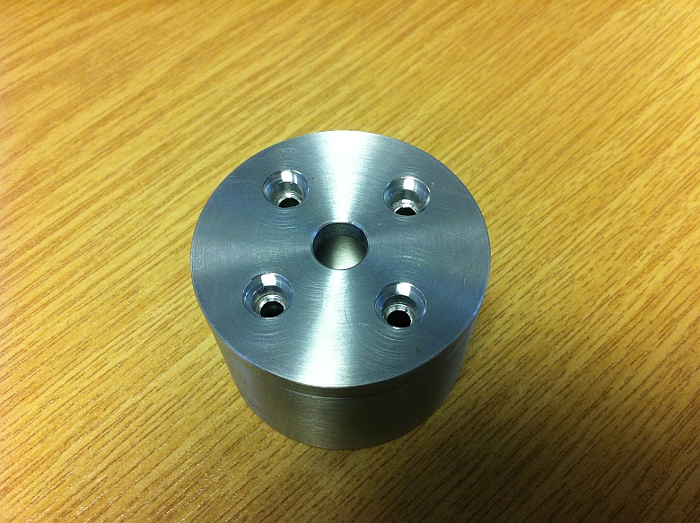

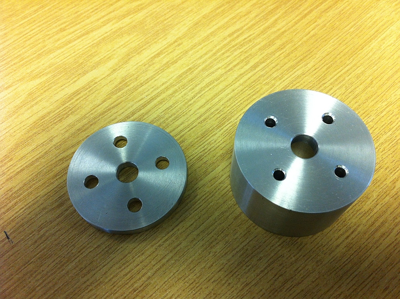

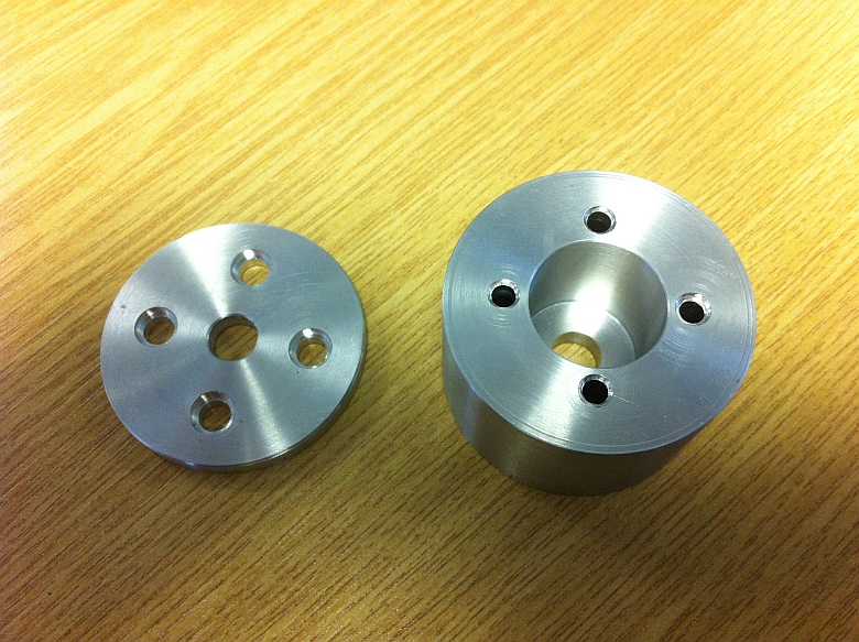

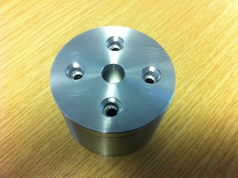

    Made some progress on this after concentrating on helis for the last goodness knows how long. The amount I've spent on helis recently I probably could have built a reallt top notch router by now.....oh well still having fun with the helis so not too worried :D
    Anyway....below is the progress I've made with the spindle housing, will dig out the bits from the box in the cupboard tonight and see if I can put it together tonight (minus the bellville washers as I've forgotten to order them!!)
ID:	7095Click image for larger version.
ID:	7096Click image for larger version.
ID:	7097Click image for larger version.
    Neil...
    Build log...here

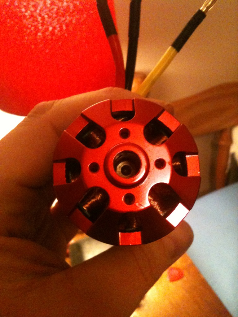

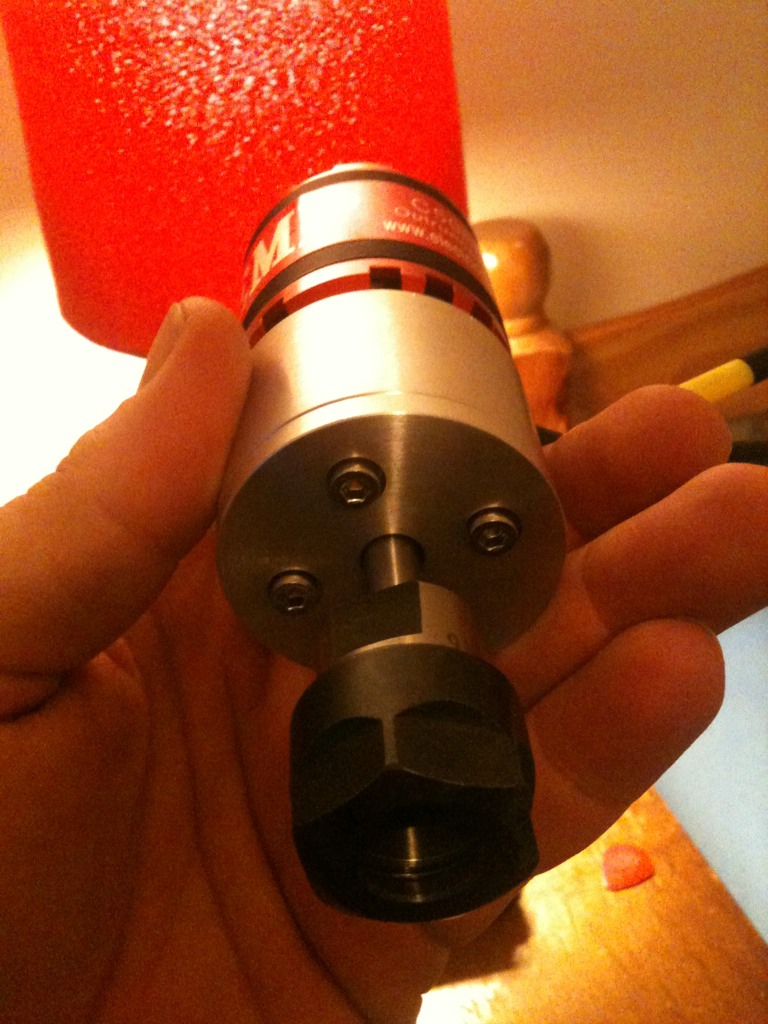

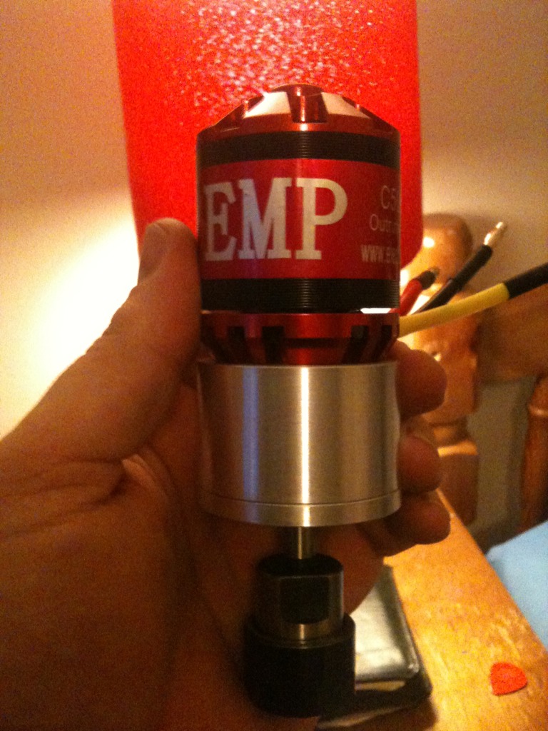

  7. #117
    Here it is roughly assembled....I know the shaft is sticking down by 12mm ish as I've not put it all the way in the motor bell, see last pic! I'm waiting on getting some Bellville washers then I can finish it off :)
    Neil...
    Build log...here
    i could have sworn i sent you some

    I can't take any credit as I followed what blackburnmark did, ok I adapted it a bit but the principle was the same :)
    I'm going to be using one of the cheap 40A 24V psu's from eBay...
