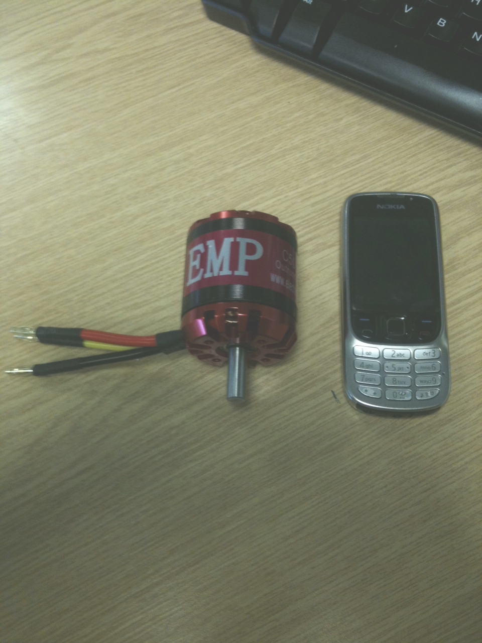

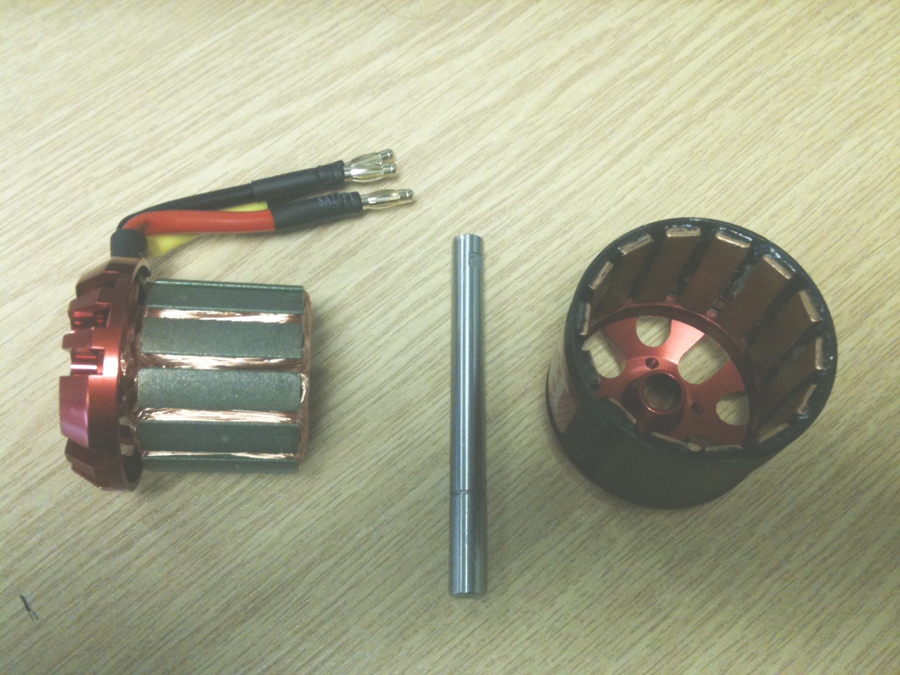

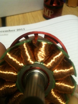

    removing the exsiting spindle shaft can be a pain but this one came out pretty easy

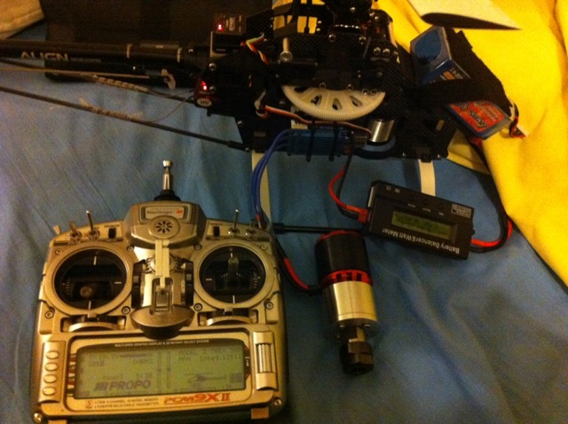

    servo controller and 100A ESP

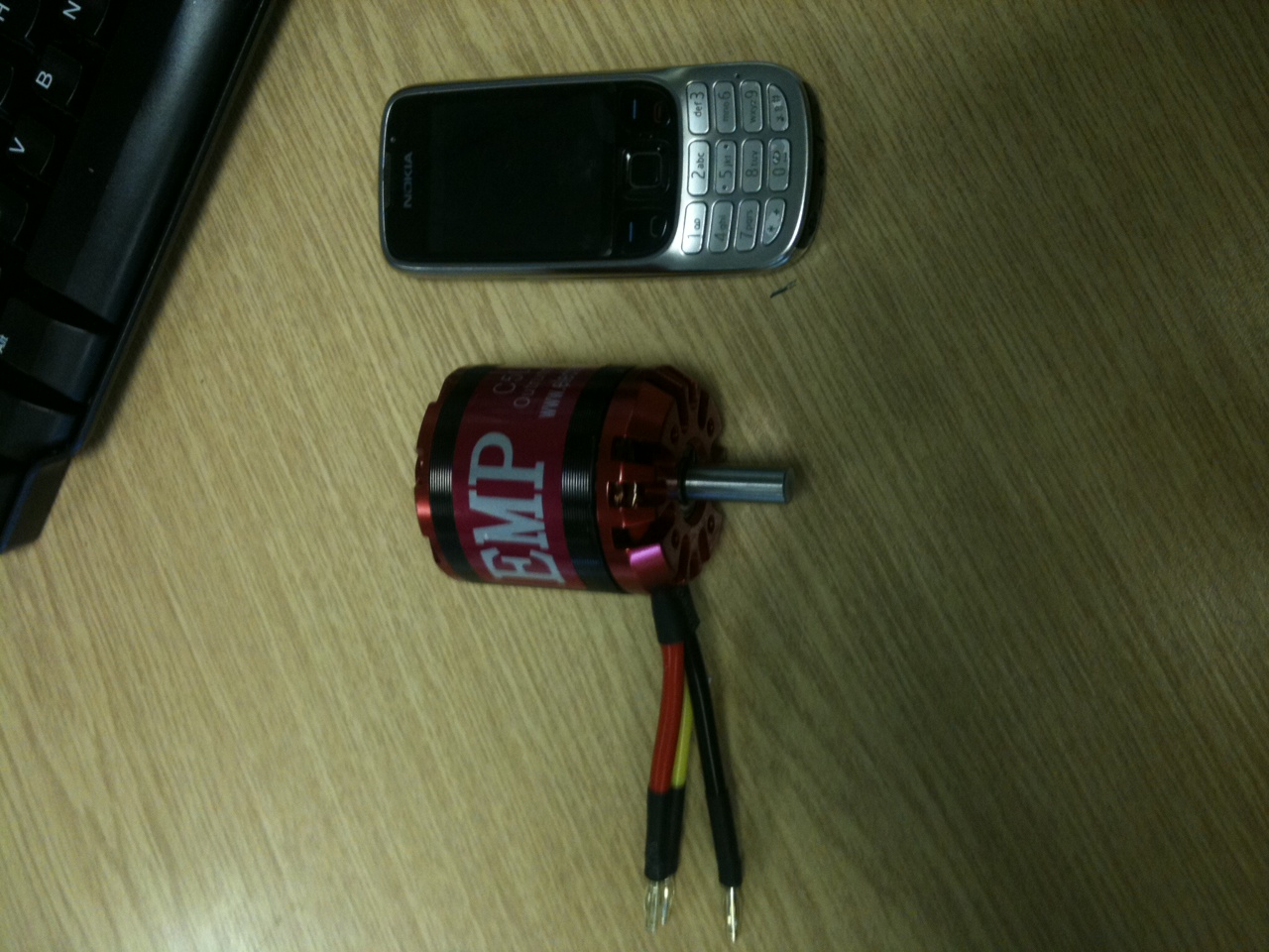

    looking at this photo has me thinking im developing a bit of a fetish for these brushless motors :twisted:
    the blue motor is the "cheep" one that has an extreamly out of balance bell, also in my rush to get it finished i managed to take to much material off the bearing body and had to use aluminum tape to shim it out to fit my clamp its seen me though a couple of tight spots though and will now be retired as a spare
    the small one will run up to a theoretical 48000rpm on 12v but i cant see the bearings lasting long at that speed, i keep daring myself to test it to destruction but i just cant bring myself to do it and i get by with it running below 20000rpm
    the yellow one will run upto 10000rpm and i tend to use that for tool grinding

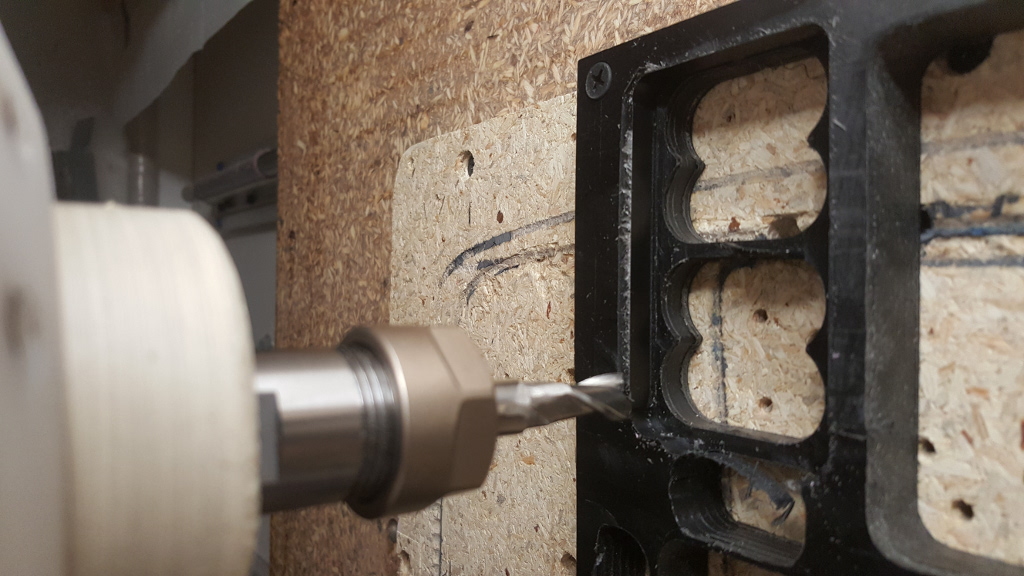

    exsample of some of the work done with these spindles... i love cutting acetal and i love thread milling M3 in acetal, if things go awry you tend not to snap the tool....
    thread milling should be re classified as an extream sport.... its WELL exciting ... or is that just me being sad ?
