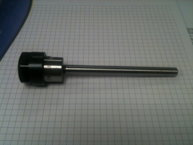

    Bought a turning tool last week and did some turning of my second piece at lunch....much better results.
    Got to buy a boring tool now as some ijit used it and has knackered it. Getting there slowly...

    The second piece is for the cap, I've rough (rough bring the operative word!!) turned the first piece but should really have bought a longer piece of Ali...so I'm going to turn a shoulder in the end of the first piece to more accurately hold it in the jaws (so I can then finish machine out the jaw marks) then finish machine, bore it for the bearings and part off ( couldn't get the parting off tool near enough without hitting the jaws before)...
    Well that's the cunning plan anyway ;-)
