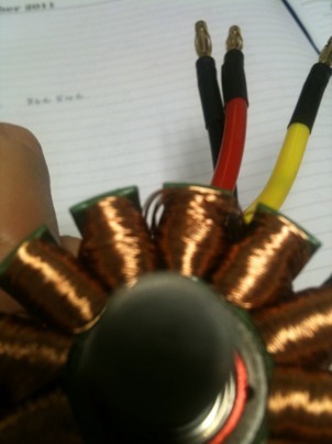

    At some stage I'll re-wind it as the winding is poor and also the potting/epoxying of the magnets wasn't too clever either as some was proud and was rubbing on the armature. Still you get what you pay for so I shouldn't be too surprised I guess...

    Adam, I don't know how much effort it will take. I'll do it to tidy up the winding (see photos) as it's not very neat but will not bother at first as I want to get the spindle up and running first!

    You'll find lots of info on rewinding this type of motor on the rcgroups forum. If it works fine I wouldn't worry ... but if you want to change the number of turns to get optimal kv then it's got to be the way to go.
    I wouldn't say you've got what you paid for when you paid more than the going rate for that motor:
    http://www.hobbyking.com/hobbyking/s...idProduct=4913
    I've not had any from hobbyking with poor magnet potting...but I've only bought about 10 and not the one you got.
