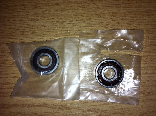

    Single AC bearings finally arrived today, this is the second lot as the first lot never made it...
    Run out of time to do the spindle this side of Xmas as off visiting relatives after the end of this week till the New Year!

    Neil,
    Sorry, I'm on lunch at work so I didn't have time to look through the thread... you are putting one bearing in front and one in back (of the housing which is out front of the motor), correct? What type of fit are looking for on 1) the shaft and 2) in the housing. Press fit I'm assuming, but roughly how much force?
    I'm assuming this will cause some pre-load on the bearings... and with more interference on the fit, the more preload on the bearing.
    Have a good holiday... anything I should not miss up in Newcastle? I'll be there for a couple weeks...
    Adam
  4. #74
    Hi Adam, not been on here for a while as work was mad (trying to get a quote out and clear my desk) last week, 57 hour week...
    I've tried the bearings on the ER16 collet shaft and they are disappointingly a loose sliding fit...will be a light press fit (heat housing first and slide the back bearing in) in the housing with Bellville washers pretensioning the inner races. Will have to locktite one bearing to the shaft and I guess leave the other a loose fit to keep the pretension? If the bearing starts skidding on the shaft (like Mark's did) then I'll have to locktite that too I guess.
