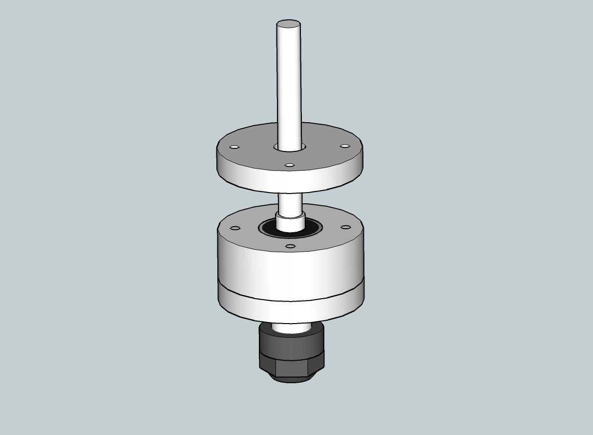

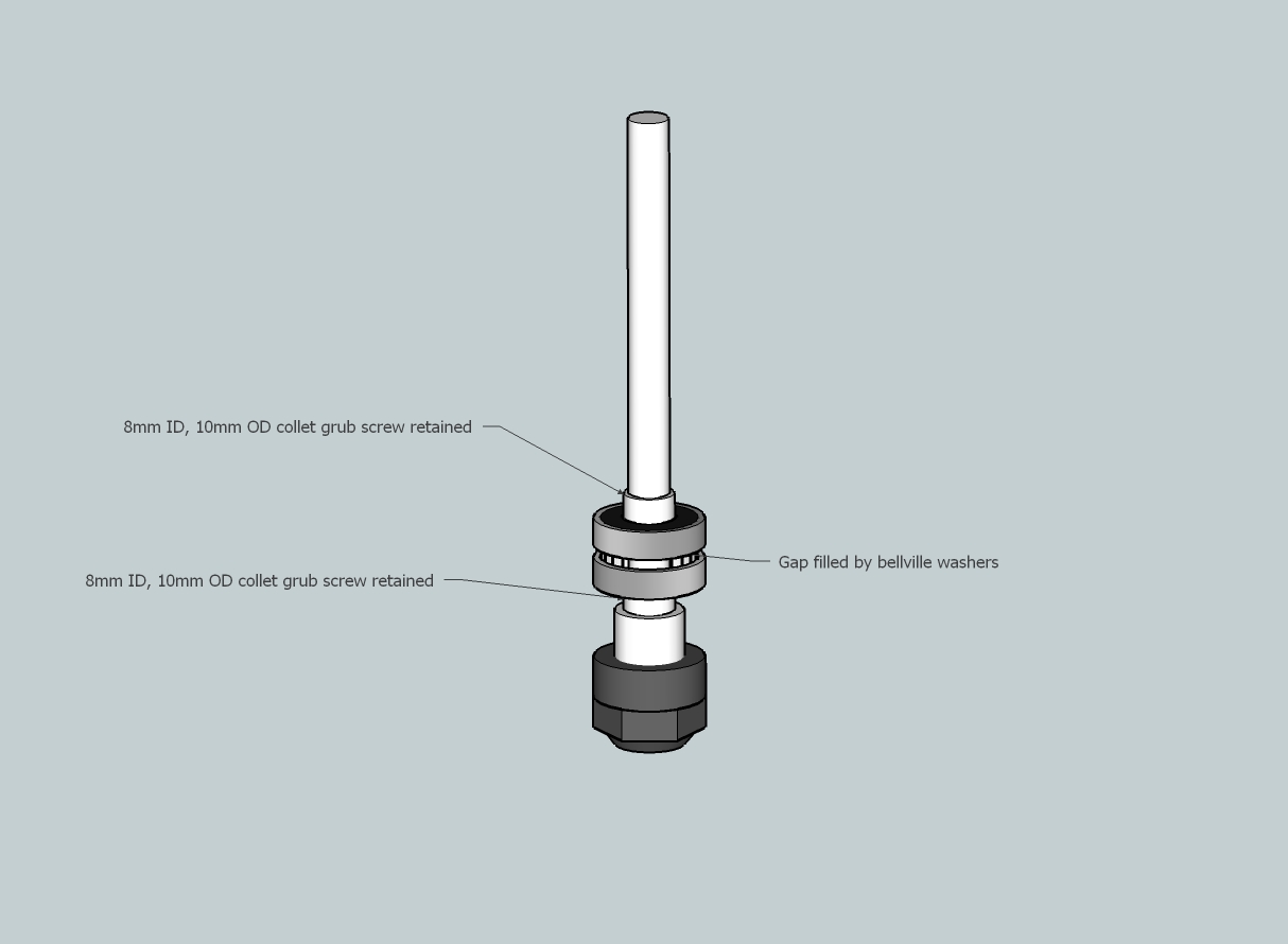

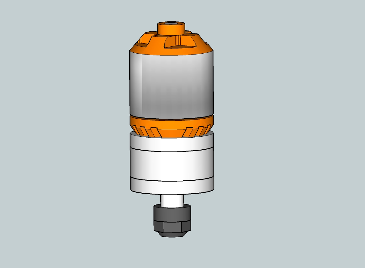

    I'll reply to the rest when you've done a drawing...
    Well I've had a look at the design and tewaked it a bit. Will probably do a MK2 spindle using this method or I might tweak this one I've already machined. this one is only really going to be cutting up to 6mm balsa and 3mm ply so I can't imagine the forces as being huge. I might stretch to some delrin/acetal and even try some Ali for a laugh
Name:	ER16 bearing holder arrangement 2.jpg
    This shows the top collet (but I haven't bothered showing the grub screws) on the 8mm shaft which is pre-loading theinner races against the bottom collet. I'm guessing I could get away with not securing the bottom collet (locktite) as it will be trapped between the bottom bearing inner housing and the ER16 collet.
Name:	ER16 bearing holder arrangement 3.jpg
    This shows the assembled unit (minus the bolts but we all know what they look like!!)
Name:	ER16 bearing holder arrangement.jpg
    The bearings in the above are not spaced the correct distance, they will be a further 10mm apart so I can get some Bellville washers in between.
    This design has the inner races locked to the 8mm shaft and the outer races are constrained by the endcaps...............comments?
    Neil...

    Neil,
    I like the design. Is there enough wall thickness of the collar (8mm ID X 10mm OD) to accommodate a small screw?
    What about a collar that has a thicker wall and a little standoff, like this... gives you more meat to tap into.
Name:	Collar Idea IMG 1.JPG
    This could also allow for a more tortured path on the bottom collar to keep dust out.
    My last comment is to not forget to think about how you will assemble this... go through the steps in your mind, sometimes I design something and find out I can't assemble it because there are inaccessible features! :(
    Adam

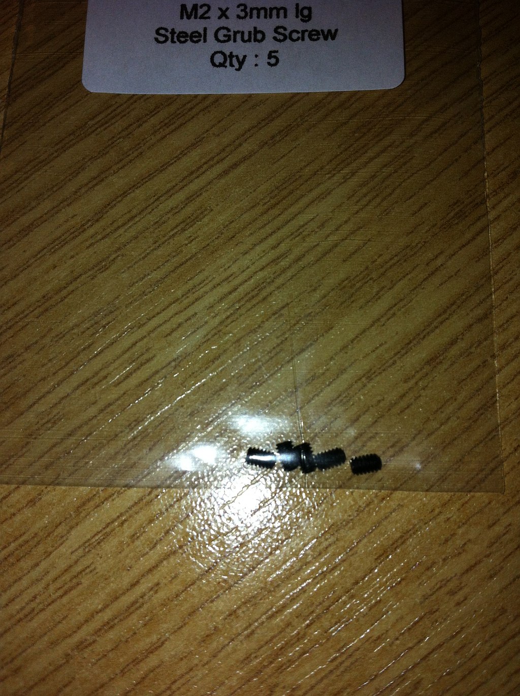

    Quote Originally Posted by Villacherman View Post
    I just figured out grub screws are 4-40 set screws... I'm learning everyday!
    I'd be using 2 off M2 x 3 grub screws and locktite in each collar (will prob make it 3mm thick for extra purchase of the grub screws) as per the attached photo.Click image for larger version.
    Neil, was the shaft of the motor hard to swap out for the collet shank? Anything I should not do? I want to give it a try this weekend. I'll do all the usual, keep things straight and support, remove the circlip, etc...
    I removed the circlip and pulled the bell off the motor complete with the shaft. Then put the bell on the vice so the shaft was between the jaws but the bell resting on top (obviously with a cloth on the jaws to stop marks) and using a 6mm piece of steel I had lying around gently tapped the shaft out of the bell (obviously remove the retaining grub screw first!!) slid out fine!
