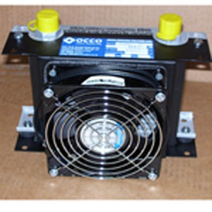

    Basically a car radiator with fan and motor, like this:

    now that is POSH!
    splendid :)
