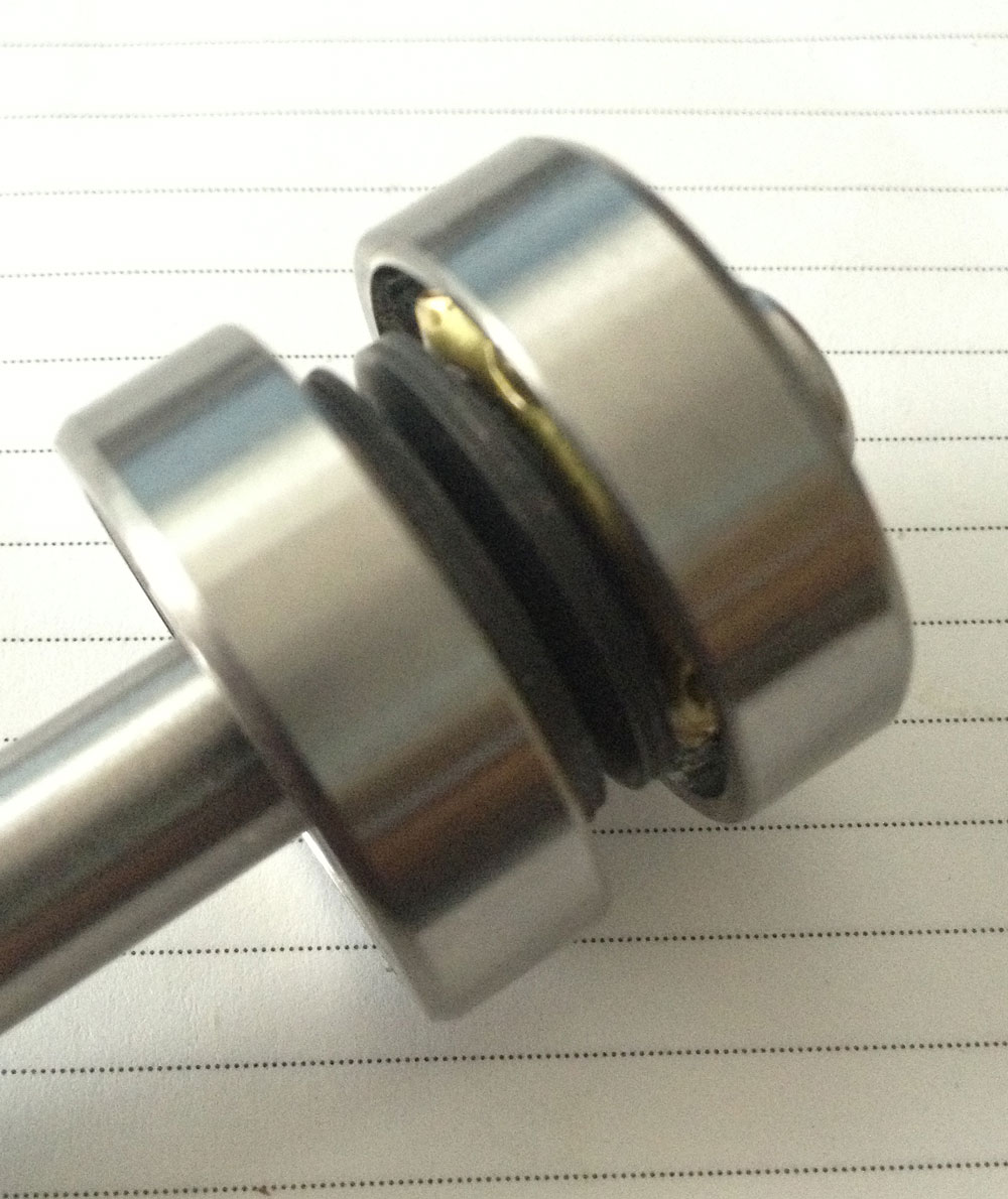

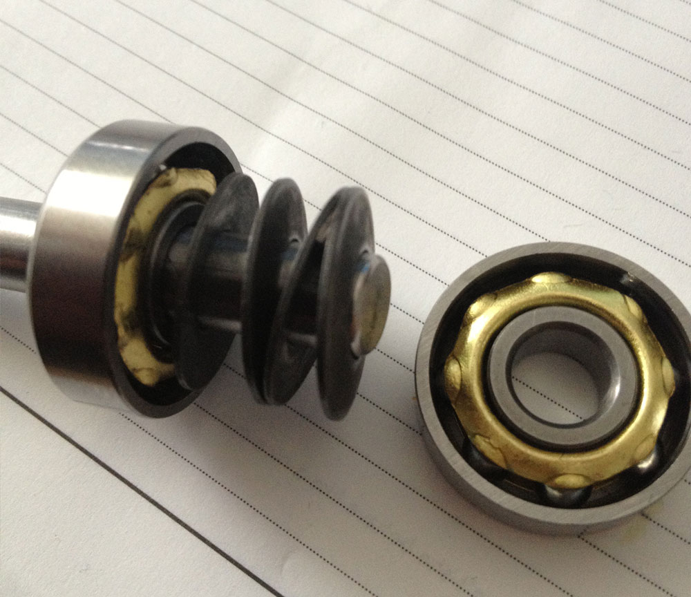

    Hi, I now have what I think I need - 2 Magneto Bearings and some Belleville washers :-).... now just wondering how to arrange the bearings and washers in relation to oneanother?
    Do I put the 2 bearings back to back - ie with their 'open' faces both towards the inside and the washers separating them?
    Thanks.

    iv never looked at the implications I think back to back is the standard but id fit them in which ever way was easiest to implement
    I had to make a couple of washers with a grove in the face for the outer Belleville springs to sit in to keep them central and clear of the shaft
    I "think" I pulled tension on the inner races via the spindle.... errr, no hang in, I used epoxy to lock one of the races.... bollocks! I cant remember now? when you have all the parts in your hands you'll make sense of it
    tight fit on the pointy end bearing (housing and the shaft) and allow the other bearing to float to some extent so the Belleville washers can overcome any movement (if that makes sense)
    EDIT: i assumed "back to back" meant open ends out?

    I think I have this assembled right but thought I would post some pictures to confirm and help others who have the same question.
    I didn't quite get what you were saying about fixing the washers - I guess the aim is to center them to stop them rubbing on the spindle - seems like that might be quite difficult?
    Cheers.

    I think you where right in you description of "back to back" sorry :(
    you are pushing the inner races apart
    as long as the bearing closest to the tool end is tight on the shaft and in the housing I'm guessing all will be well
    ....now I think about it the inner races shaft and spring washers will all rotate which may be a good reason to go "face to face" because if the washers aren't perfectly central they will cause resonance at high revs
    "face to face" would mean the washers don't spin with the shaft as they push against the outer races
    that's why I remember "pulling the shaft" so to speak
    with the springs between the outer races you need to grip the shaft to hold the tension... in my case I simply used the out runner bell to grip the shaft and hold the tension (not good for your outrunner bearings) what I should have done is add a collar with grub screws, I did have one but I hadn't accounted for the extra room it would take inside the bearing housing
    if you don't get what I mean let me know and the next time I'm at home ill take some pictures of mine or knock up a drawing
    in a nutshell, instead of pushing the inner races apart from the inside you are pushing them together from the outside
    you may suss a better way of doing it ?
    let us know how you get on
