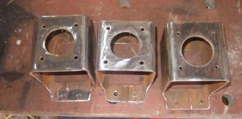

    Has anyone used box section metal (suitably machined) for mounting motors etc? Something like 70 x 70 x 4 for example?
    Any problems likely? :question:
    Not seen anything done like that "yet!".
    The best method i've seen/used is a solid bar of ali, on the other side of the block is a pocket to recive the leadscrew fixed end bearings, like the floating end round mounts in the other pic, but you use two bearings back to back for the fixed ends.
    .Me

    Thanks Lee, They do look pretty!
    had a ferret around and found these, but forgot to note where I pulled it from! Apologies to the owner for the borrowing his pic
    I'm toying with the thought of using something similar, but longer.. to help protect the more delicate parts.:naughty:

    Mocha,
    do you mean longer between the motor and the ballscrew so that you have more room for the coupling?
    Ian
    Hi Ian
    It seemed like a really good idea at 3am this morning! lol, but I think I may have screwed up on the numbers.
    The distance between the face of the motor and the face of the bearing for the ballscrew nearest it...
    I'm working on the shaft of the NEMA 23 being around 20mm long and the coupling in the region of 34mm.
    What I can't seem to calculate is the overall distance when it's all fitted together... I think it's around 60mm but that has some "guess" in it! Does it sound reasonable?
    Can anyone point me at the right place to look or take a look at their set up and have a quick check for me please?
    thanks!
