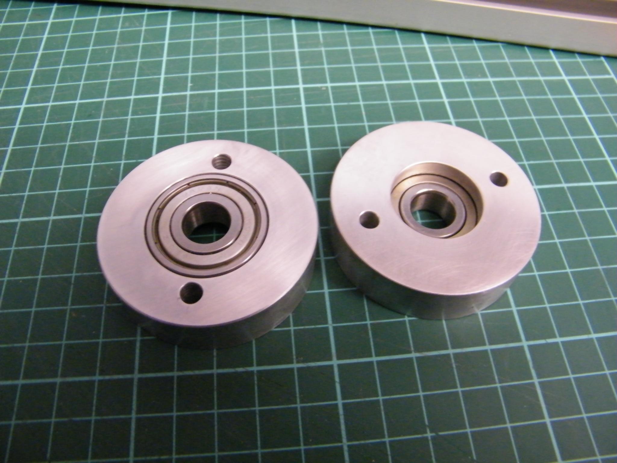

    Not seen anything done like that "yet!".
    The best method i've seen/used is a solid bar of ali, on the other side of the block is a pocket to recive the leadscrew fixed end bearings, like the floating end round mounts in the other pic, but you use two bearings back to back for the fixed ends.
