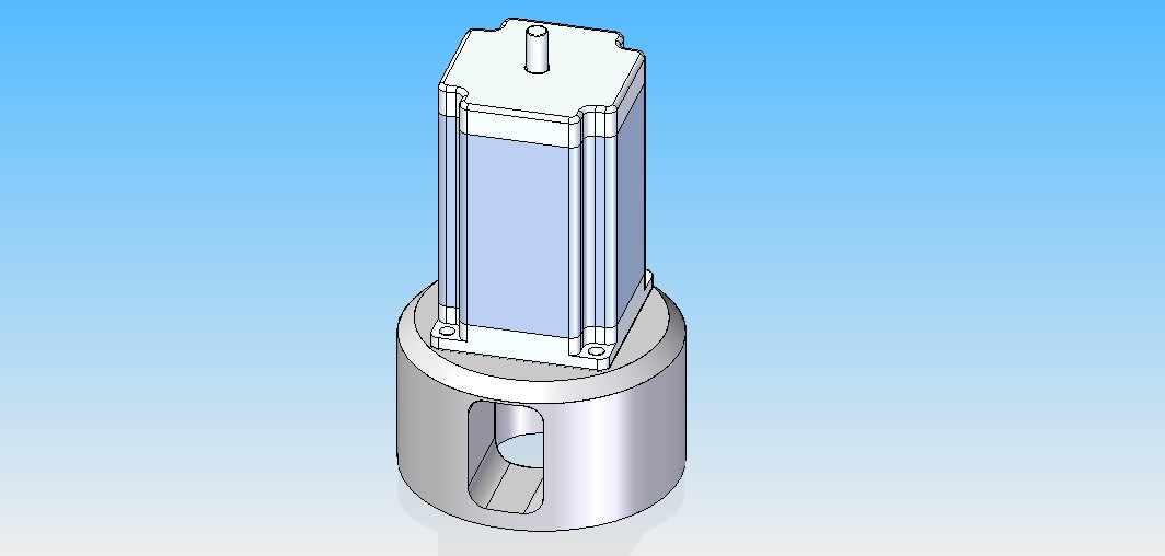

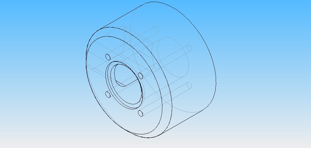

    Does this look ok?
Name:	Nema 23 stepper mount 1.jpg
Name:	Nema 23 stepper mount 2.jpg
    Hopefully you can open it in sketchup:
    Nema 23 motor mount.zip

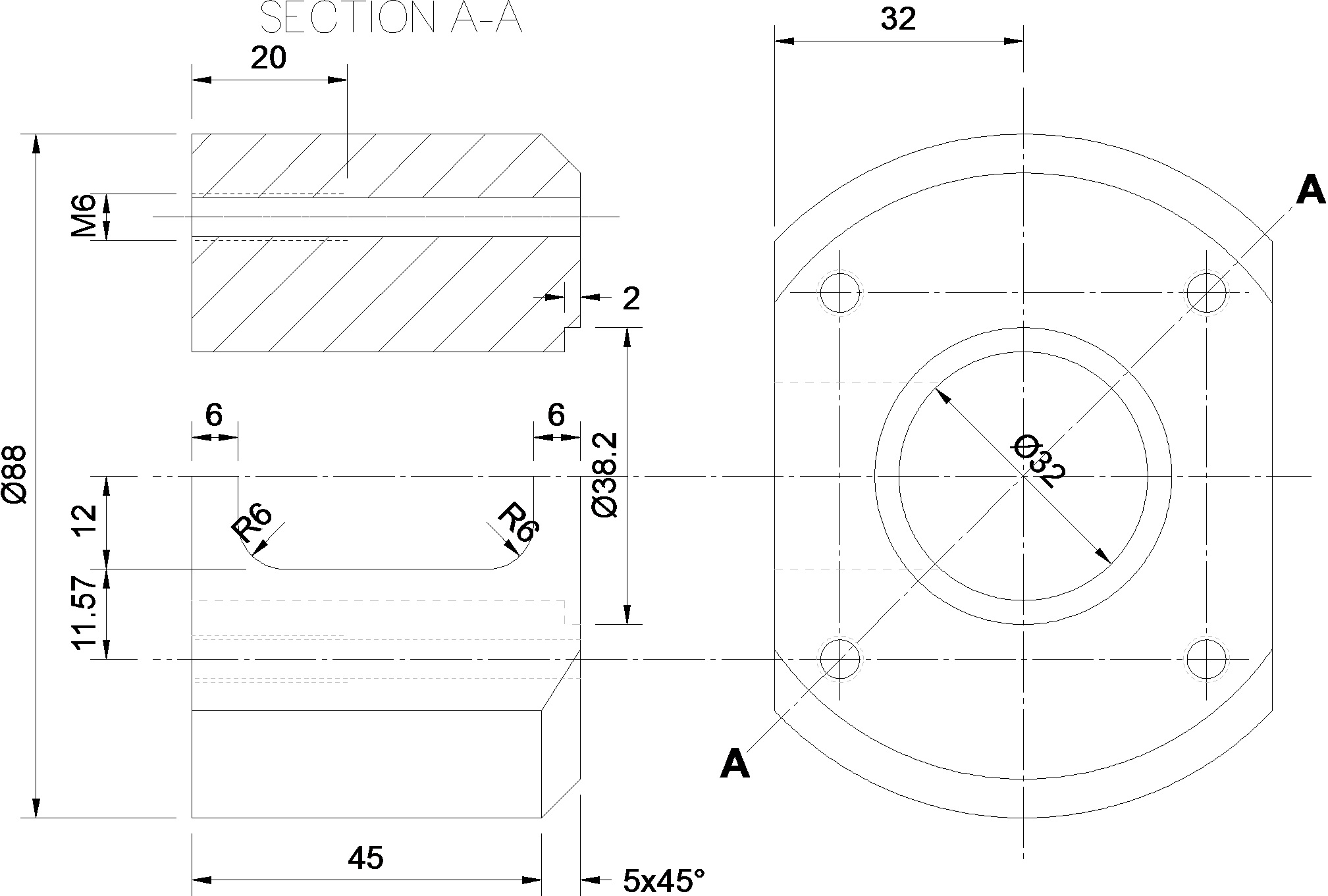

    I've done a dimensioned drawing of the mount in case anyone else would like one/more:
Name:	Nema 23 Stepper mount.jpg
    (The 4 holes in the 3D drawing in my previous post are in the wrong place...)

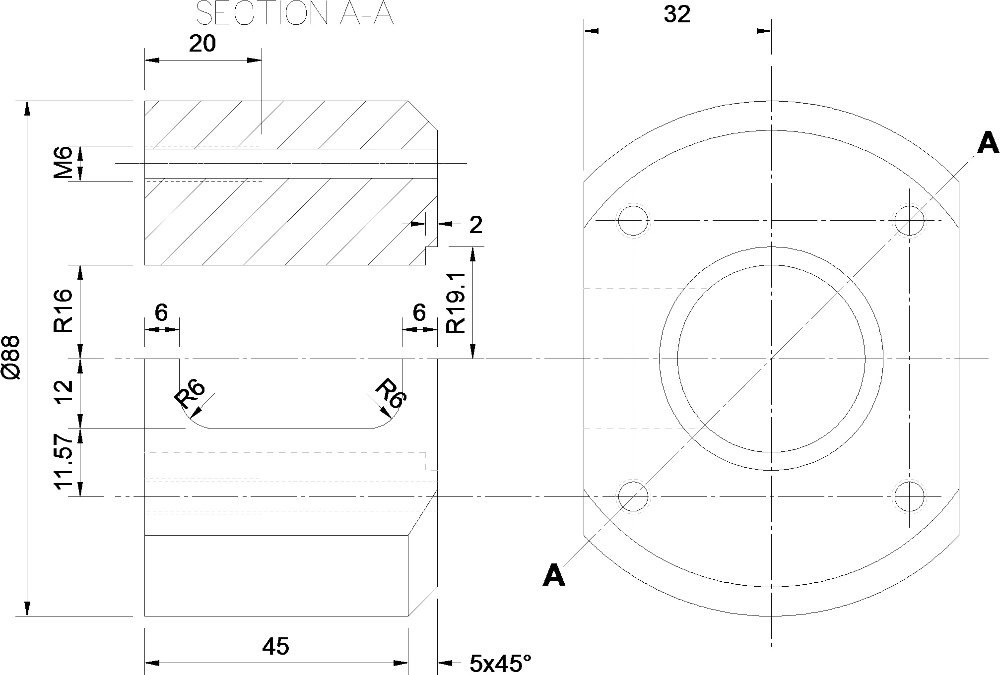

    Coupling OD is also a factor for this type of motor mount, what max OD have you allowed for Jonathan?
  7. #6
    32mm.
    It's on the drawing in code, only dressmakers and the BBC dimension diameters as radii.
    John S -
  8. #7
    On the BBC they'd skip the interesting bit with dimensions!
    I thought it was neater to dimension the radii, here's a version with mostly diameters:
Name:	Nema 23 Stepper mount2.jpg
    I can obviously make that hole bigger if required, up to about 50mm.

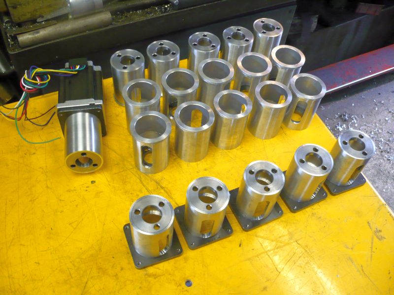

    Here's one or rather twenty one I made today.
