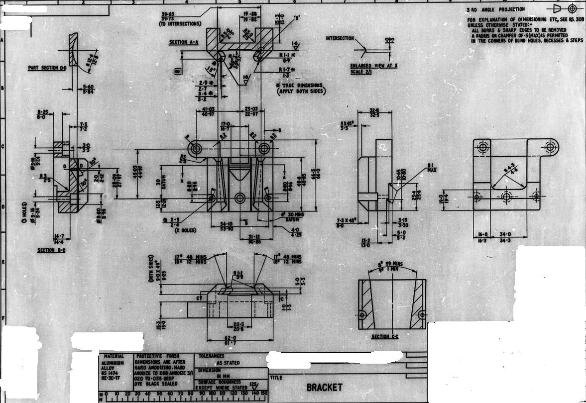

    As part of my own hobby I am looking to get a bracket machined in aluminium but I only need one (or 4 depending on cost) As finding an original bracket is zero my only option is to get one made.I have sourced the drawings but not really sure who or where to get it done.
    So far I have obviously been approaching the wrong type of engineering company as all so far want to make them by the thousands.....understandable but not what I want or need.
    The bracket looks complicated to me,but have a pic of part of 1 of 2 sheets below -
    From this drawing could anyone advise if making a one off is feasable on CNC machining equipment or do I need to find someone who will make it 'by hand' ?

  2. What part on the drawing are we looking at Kevin, as its not ver clear. have you got a photo you could show us of an original?

    AdCNC,thanks for your reply.The drawing just shows the bracket but different views and sections.
    The bracket is not available to show on it's own,I only have pictures of it attached to what it's fixed to.
    I have done my best to mask the photos below to only show the bracket.

    Post the orginal pic of the drawing then I can open it in photoshop to see better.

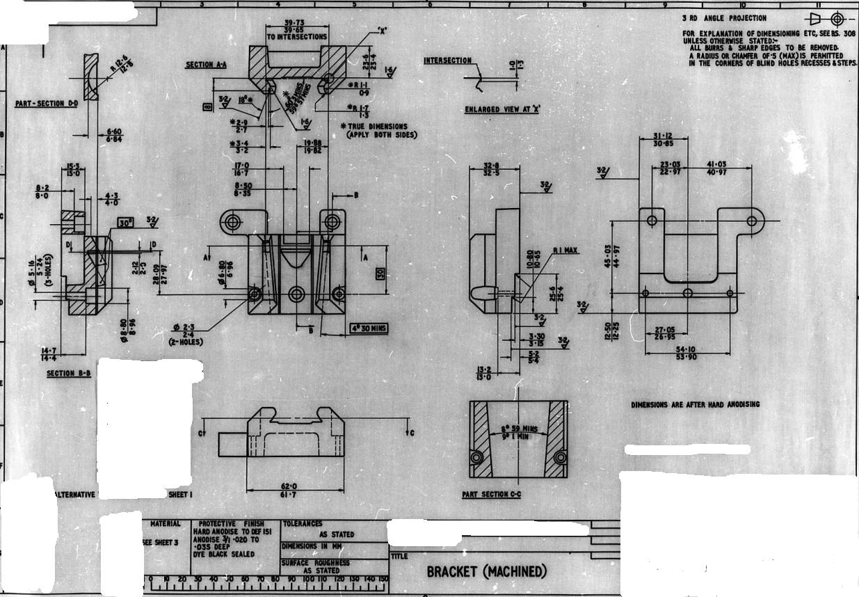

  7. Seem doable just with it being a bit of an oddball shape with quite a few features, thats what makes the price go up I'm afraid.
    Have you got other pictures to show what goes into that tapered dovetail?

    This is the part that goes into the tapered dovetail.The recess in the bracket is to take a spung loaded tongue on this part which locks both assemlies together.
    I will upload the drawings in a bit.Serrated lever is the bottom.

    Drawings (originals are 2 meg TIFF format)
