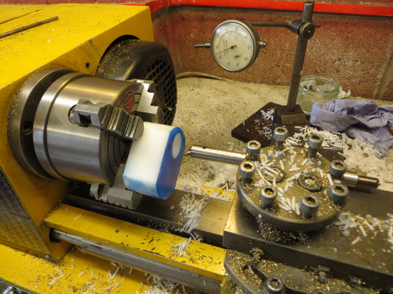

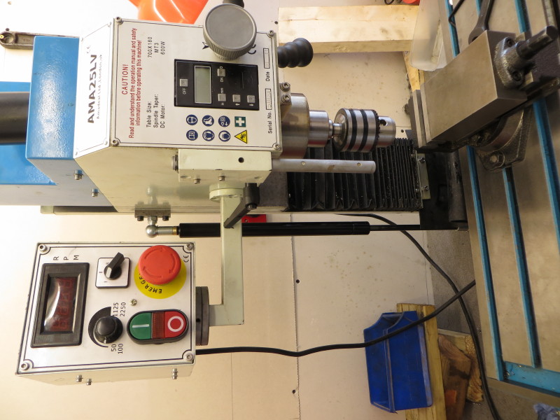

    My mill is about 3 years old and used mainly for making clock parts, the reason for converting to CNC is to speed up the cutting out of clock wheel's and plates and to move away from cutting by hand with a fretsaw.

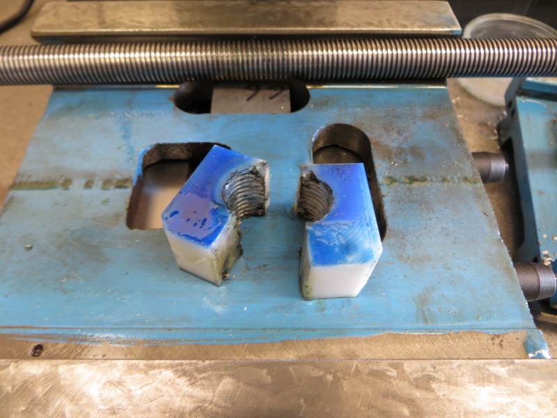

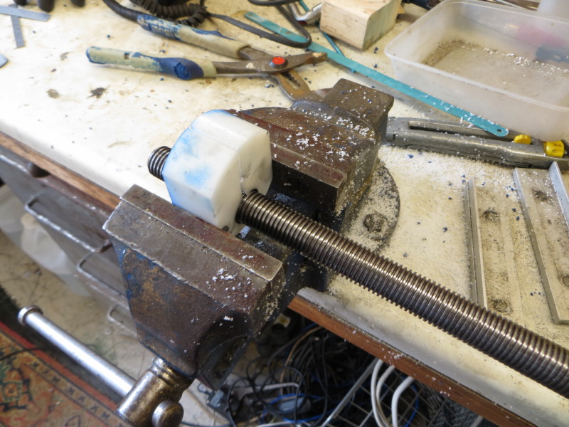

    I am using the original lead screws but replace the cast iron nuts on the “X”and “Y” axis with Acetal nuts made to the method described by Evan Willams.http://bbs.homeshopmachinist.net/thr...s-the-easy-way.
    The backlash with the new acetal nut for the “X” and “Y” is X =0.08mm and Y=0.05mm, on the “Z” axis I have fitted a gas strut to control the weight of the head which also looks like it is controlling the backlash, but I will see how it works in practice before making any more modification.
    For software I plan to use FreeCad > HeeksCad/Cam > LinuxCNC.
    Next phase will be to buy the stepper motors and controls, which will be in October due to Holidays.

    How is the machine in general ? I have just purchased one with intention of converting it to CNC ?
    Hi
    The mill is very good and well made but its best if you re-grease the head and lead screw bearings as the quality of the grease used is poor. The main weakness of the machine is the DC drive motor I am on my 3rd and I don't use the mill for heavy work, I have improved the cooling to the motor in the hope of solving the problem.
    Hope this helps Steve
    Thank you :)
    Also could you show me a picture of the table size, I've seen SO many different size tables but I would like the longer one. To get the CNC Kit it needs to have the long table or the ballscrew for X will not fit. In the sale advert it says 500/700, what the hell does this mean :D is it 500mm long or 700mm long ?!?!?!?
    Cheers,
    Ian
    Hi Ian, sorry about taking time to get back to you but I am out of the UK with very little internet, I think the 500/700 is the difference between the standard which has a 500 mm long table and the LV version that has a longer table at 700 mm.
    I have the LV machine, I found that to fit a ball screw on the "X" axis you will need to machine a space for the ball nut to fit in as it is all very tight for space, when I get back to the UK I will send you some photos.
    Steve
