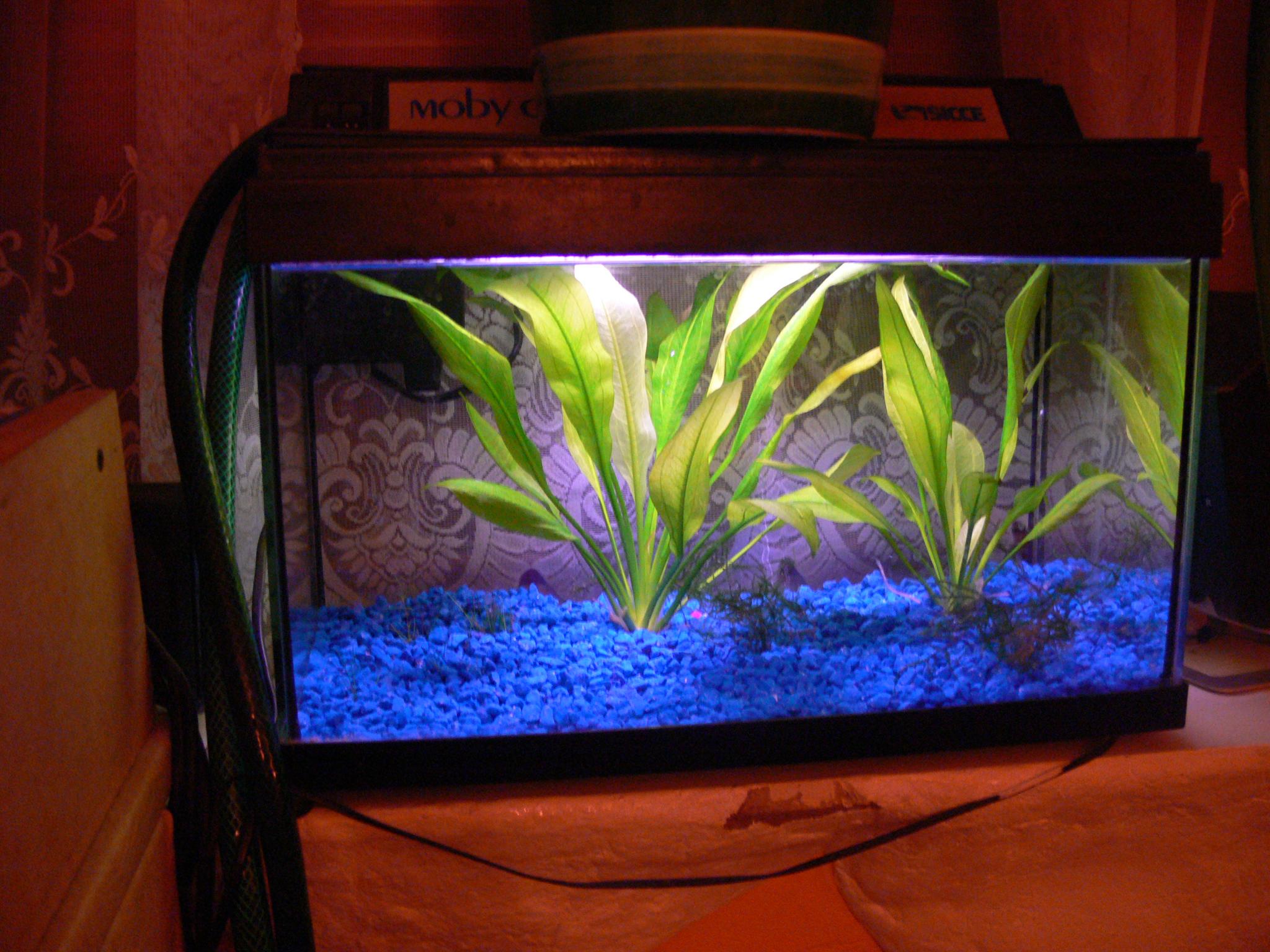

    ...and replace with fish tank

    That's how my cooling unit looks like in my PC cooling system after I replaced 3l bucket with fish tank 11l I think:heehee:. 100% pure tap water + antialgae some time ago
