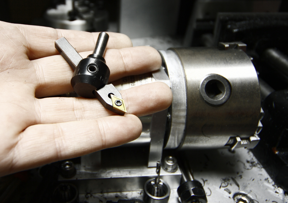

    i bought a cheap fly cutter (ebay) and turned the shank down
    http://www.ebay.co.uk/itm/Fly-Cutter...item3f0cb22c9d
    this one is a bit pricey but its the same as the one i bought... youll have to have a hunt around, RDG might be better (i ended up putting a dcmt insert holder in mine)

    i can skim alli with mine at 60mm (ish) diameter if im carful (my machine is quite rigid though and my spindle will cut at low rpm)
    cuts acatal quite well up to 0.5mm without to much trouble

    EDIT: Having just watched a couple of youtube videos, woaah fly cutters rock - I want one! Mark what diameter is the business end not the shaft but the end that holds the cutter)...I've a mini lathe collet that holds up to 20mm diameter - & do I need the dcmt insert holder you mention?
    19.8mm (ish)
    not at all... thats just me being lazy...just try to put a "small" radius on your tip when your sharpening your tool

    the theory is good but iv had no problems getting lovely finishes with this one at 1500/2000rpm
